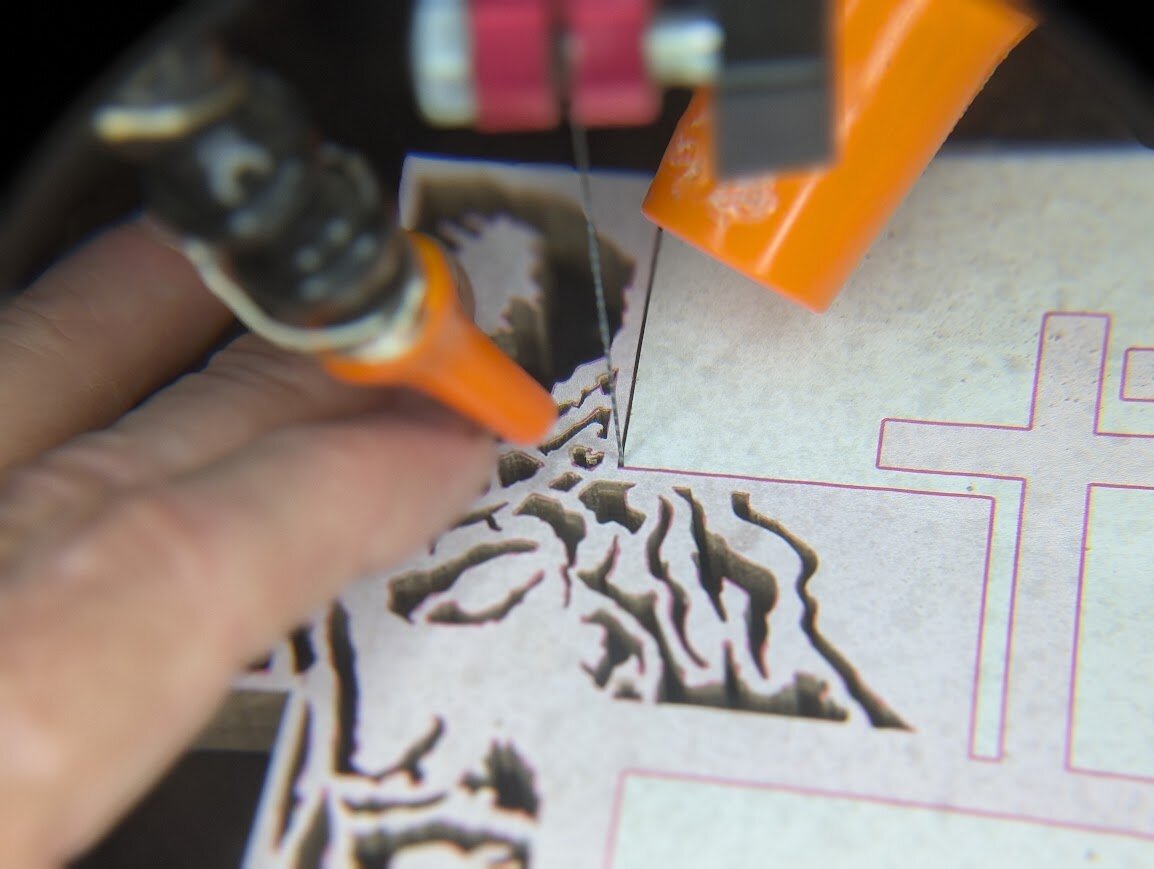

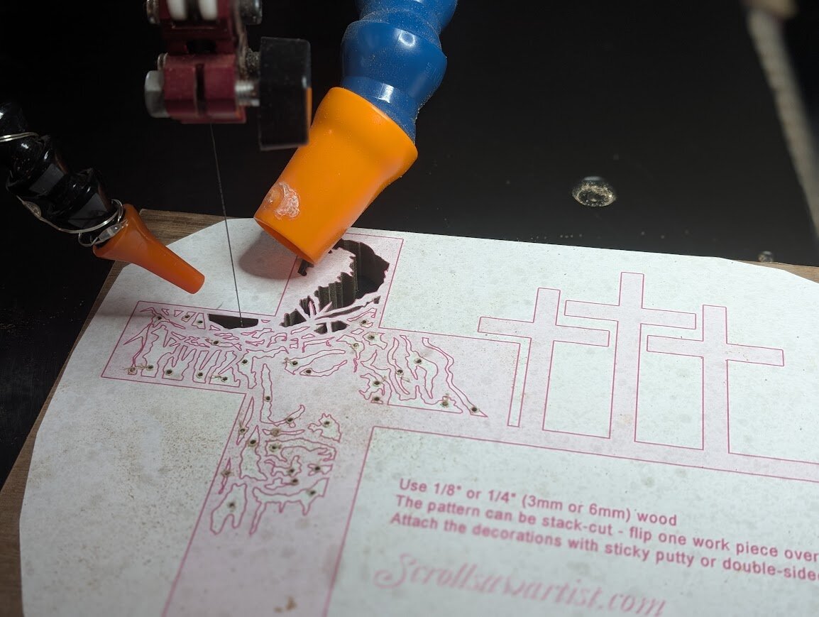

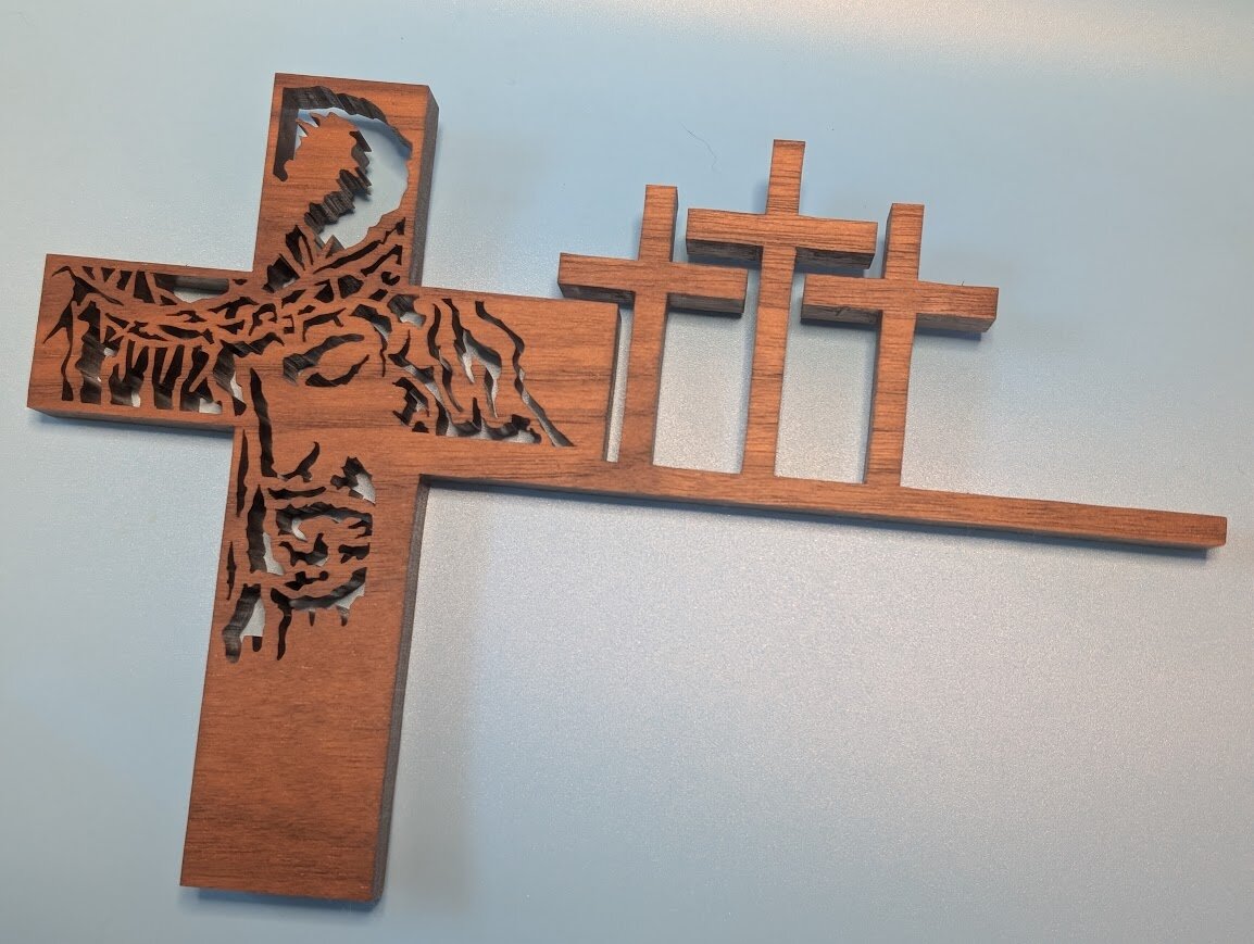

Popular Post rafairchild2 Posted December 27, 2025 Popular Post Posted December 27, 2025 I am only doing 3 or 4 easter art projects this year. I already posted one of my original designs, this is the next one, design by Sue Mey. In hindsight I should have stack cut this so I could get at least 2 pieces. 1/2" walnut. I used a Flying Dutchman Ultra Reverse #1 for all inside cuts, and then switched to a #7 FD-UR for all the outside, straight, cuts. Finished with Danish Oil. My plan is to add a coat of beeswax and coconut oil wax for the final finish after it cures. My next piece is another door topper by Sue. It is a church surrounded by trees. The plan is to make it out of 1/2" black limba. jerry walters, Be_O_Be, Scrappile and 11 others 14 Quote

TAIrving Posted December 28, 2025 Posted December 28, 2025 What is the fretwork inside the cross supposed to represent? Quote
rafairchild2 Posted December 28, 2025 Author Posted December 28, 2025 8 hours ago, TAIrving said: What is the fretwork inside the cross supposed to represent? Seriously? What do you think it is? Quote
