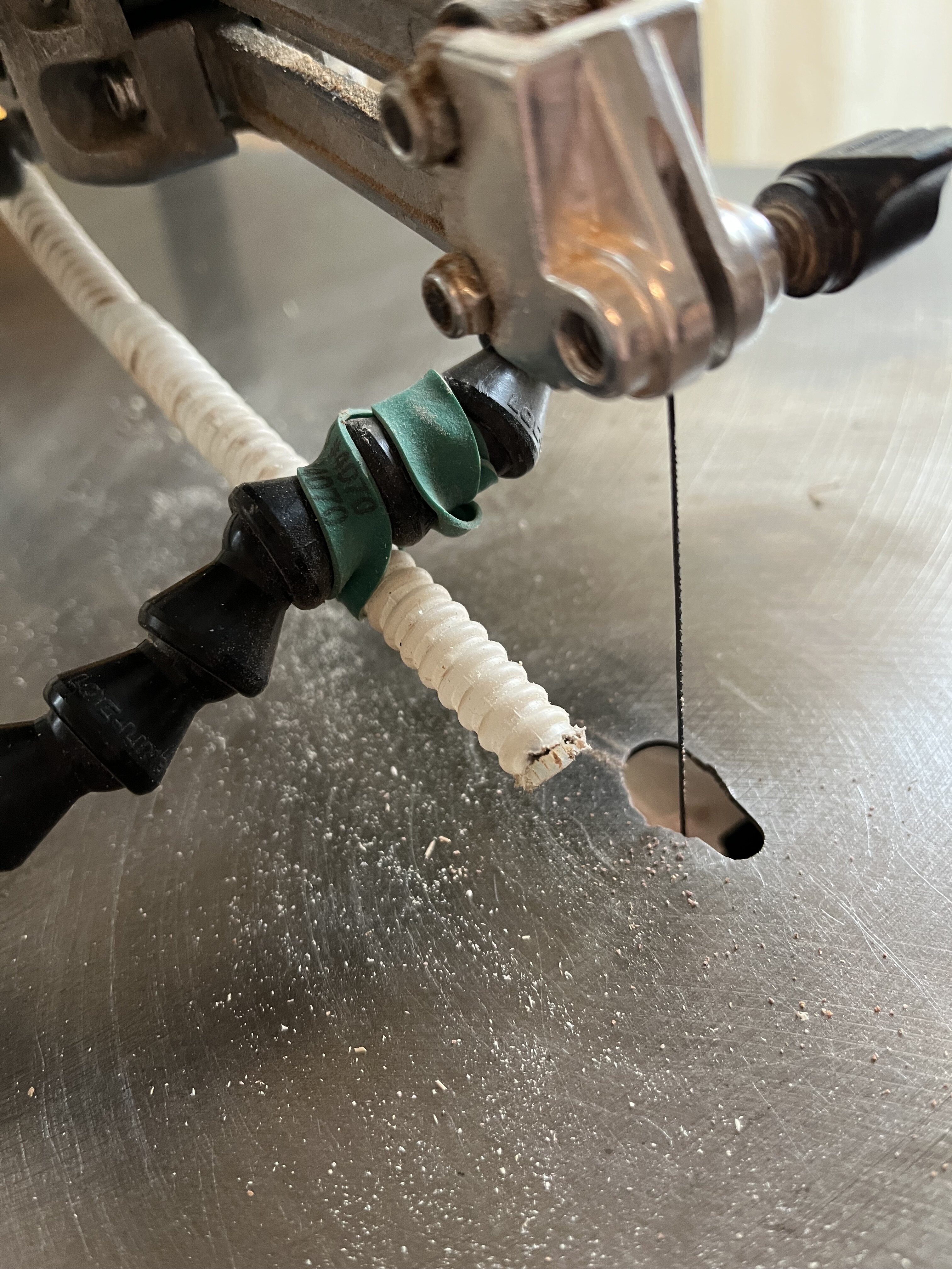

GregBennett Posted February 19 Posted February 19 I had considerable issues with the Scrollnado I bought from Amazon, but they've since been ironed out. The system is far from perfect, particularly the plastic flex straw like sections that are the final stage of dust collection. I've since replaced them with 1/4" White Polyethylene tubing I got at Lowes. It took some time to train it from curving using a copper wire and manually working on it. I found that the hose clamps didn't adhere very well and have duct taped them in place. One of the biggest struggles I had was noise from the vacuum. I tried putting it in an enclosure and covering it with a large pillow without much success. I bought sound cancelling headphones, but they were somewhat uncomfortable and less than effective at deadening much of the noise of the vacuum. I listen to music while cutting and that affected by the earphones even when plugged in. My daughter gives me Lowes gift cards for birthdays and Christmas and I found a much quieter vacuum that was on sale-DEWALT Stealthsonic Quiet 12-Gallon 5.5 HP Corded Wet/Dry Shop Vacuum. It turned out to be a game changer. Shopvac offers a quiet vac too. Another piece of the puzzle was air leakage where the two black hoses tie into the larger hose that runs from the collection unit. I wrapped insulation foam between the hoses and duck taped the connection. The final modification I made was a holder for the collection unit. It wanted to be sideways so I put it in a dollar Walmart trash can held down with a 10 lb. barbell plate. I'm now very pleased with the outcome. It's so much healthier than blowing the dust around the shop. The final cost was about $200 for the Scrollnado and the vacuum. OCtoolguy 1 Quote

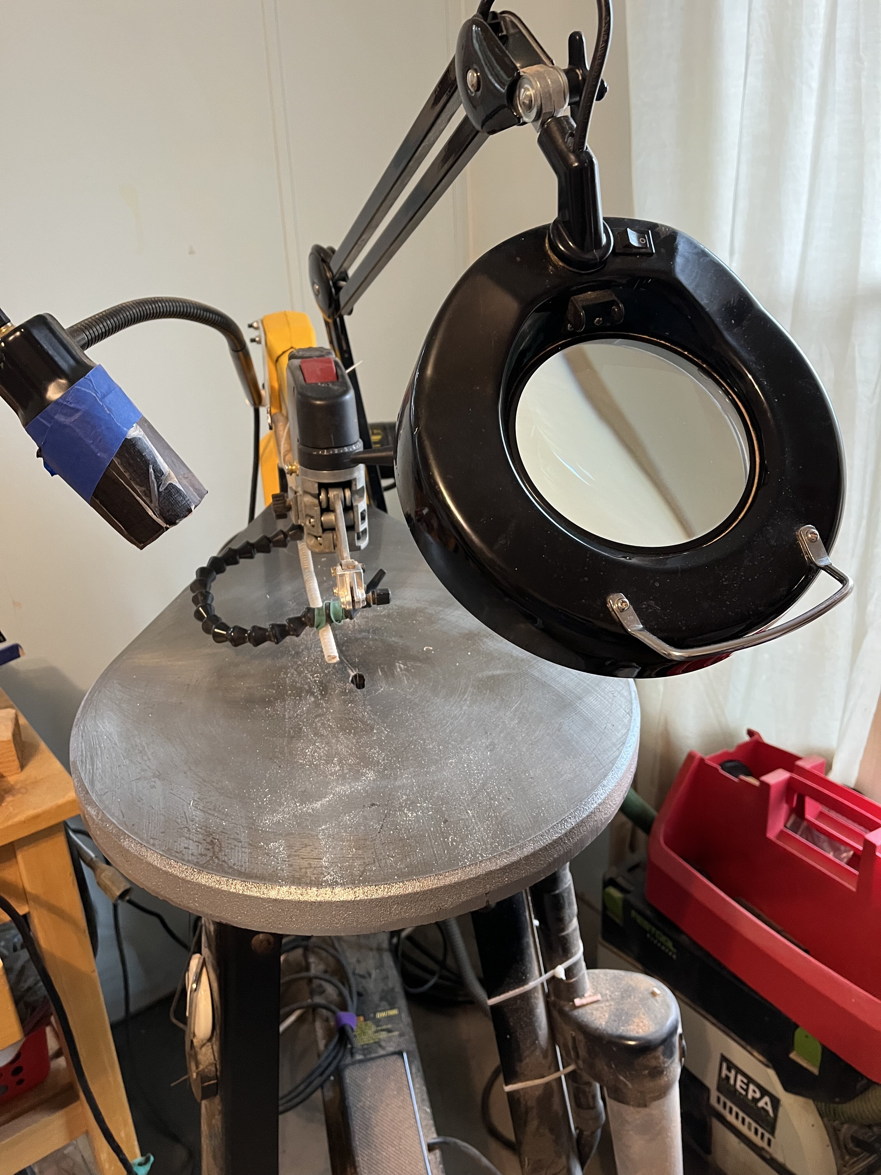

Gonzo Posted February 19 Posted February 19 I’m curious as to how your setup looks. Could you please post a picture or two? OCtoolguy and danny 1 1 Quote
GregBennett Posted February 25 Author Posted February 25 I've attached a few photos to show the DeWalt vacuum and scrollnado in trashcan, the hoses and duct tape and the replacement hose to the dust collection. I recently purchased a 1967 used copy of Patrick Spielman and Dan Kihl's Artistic Scroll Saw Patterns and Projects and the piece on the table is taken from that book. I've found a few patterns worth cutting and the one I'm working on now is I call Flowers with Dragonfly. It's not particularly difficult, but I've found it to be a joy to cut. I've found over time that my greatest joy in scrolling is the actual cutting. It's nice to have finished work that ordinary people admire, but I think that's secondary to the actual work. barb.j.enders, TAIrving, OCtoolguy and 1 other 3 1 Quote

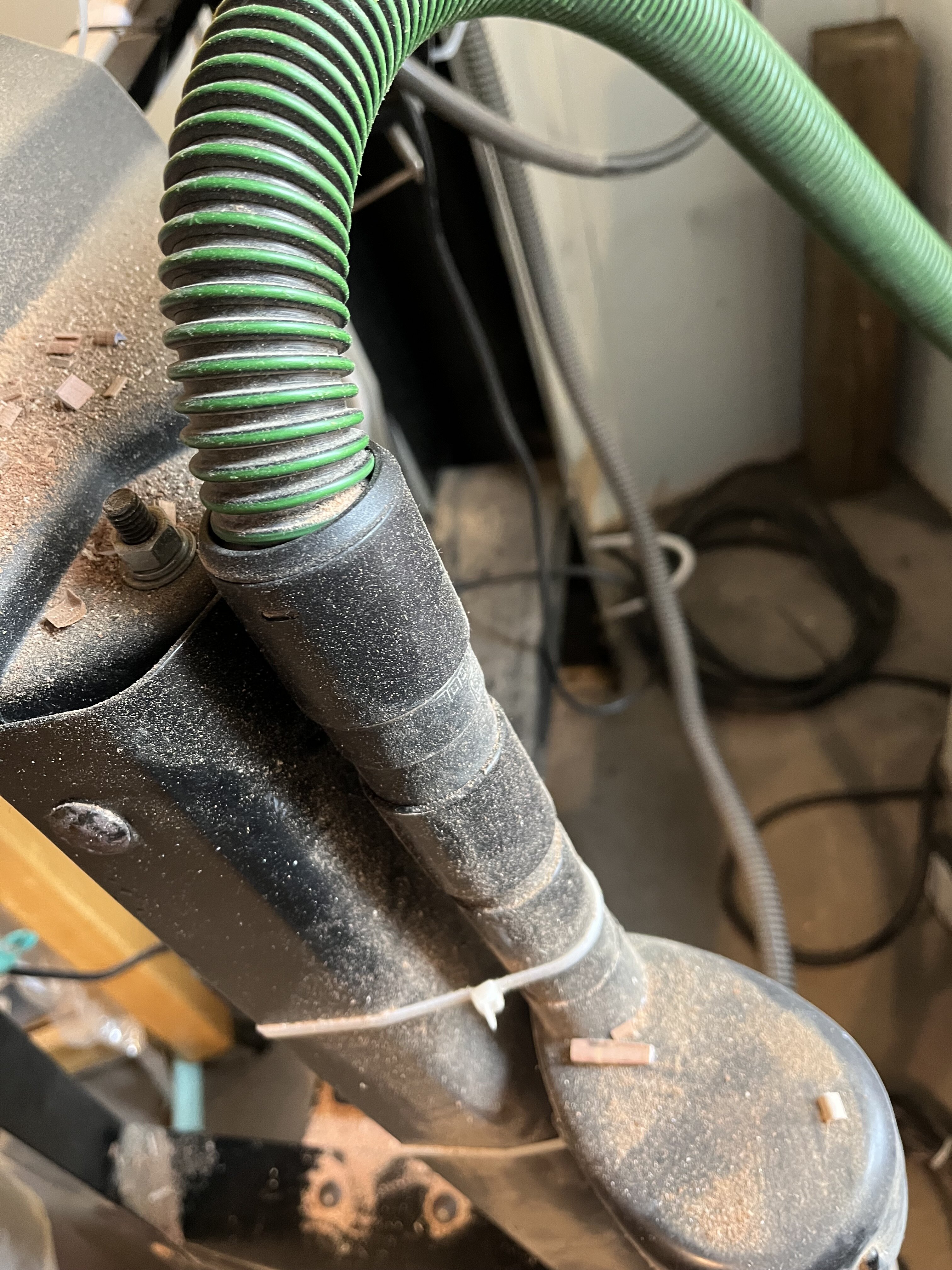

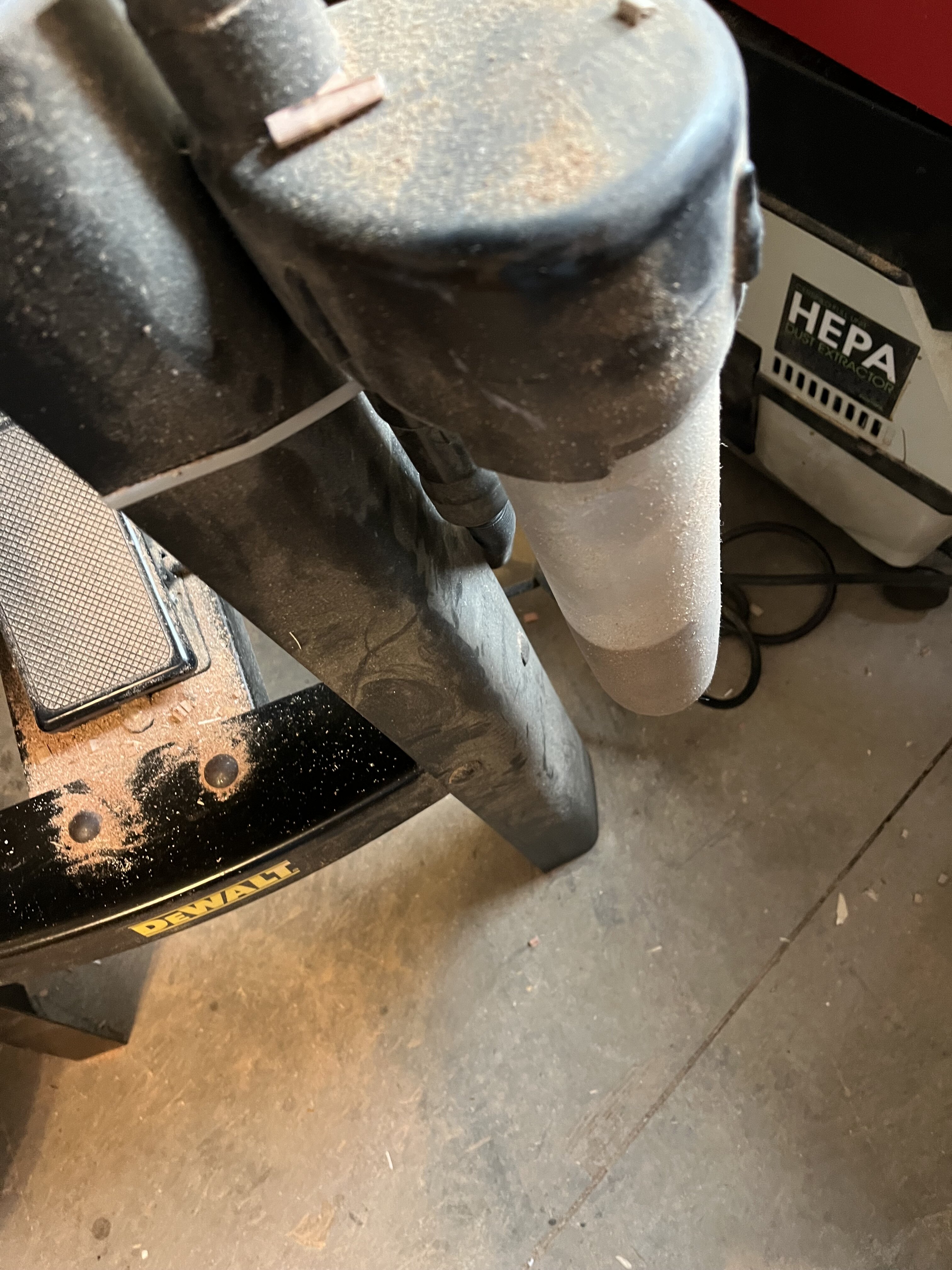

Roberta Moreton Posted March 6 Posted March 6 I have the separator thing attached to one leg of my saw. The top hose is fastened to the saw arm with wire ties. And to the blower with a rubber band. I have the bottom hose attached to the bottom of the table with a magnet on the holder. barb.j.enders and OCtoolguy 2 Quote
GregBennett Posted March 7 Author Posted March 7 Great idea. I tried that with zip ties but there isn't a great place to put it on my scroll saw table legs. The way I have it makes it easy to remove the tube to clean it. It looks like you got the foible straw to work as the end piece. OCtoolguy 1 Quote
