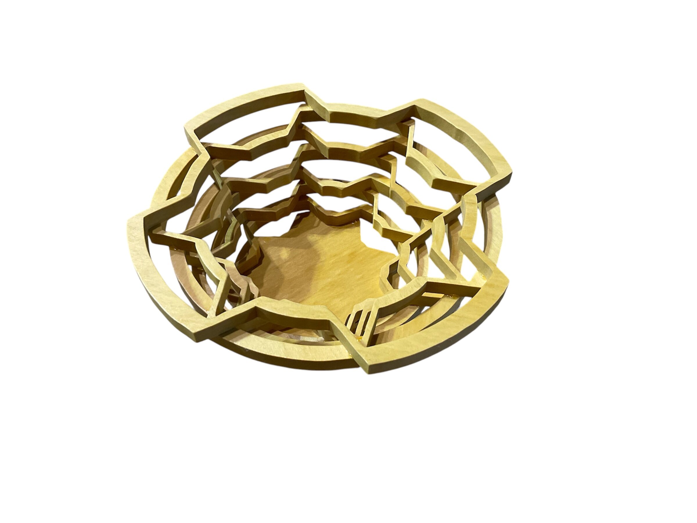

Popular Post Denny Knappen Posted April 28 Popular Post Posted April 28 I have not posted for quite some time, but I liked how this turned out. This is an Alex Fox pattern. I had some leftover 1/4" Yellowheart 6" square, so I thought I would make a basket with it. It is modified so that it would fit the 6"square stock. I modified it by cutting off the outer rings until it fits the stock. Cut on the Pegas scroll saw using a Pegas #0 Skip blade. After a light sanding each ring, assembly, one coat spray Shellac, another light sanding, and a final coat of spray Lacquer Clear Gloss. Comments welcome. Be_O_Be, Dak0ta52, Mike Crosa and 11 others 14 Quote

Old Joe Posted May 1 Posted May 1 On 4/28/2026 at 10:45 AM, Denny Knappen said: I have not posted for quite some time, but I liked how this turned out. This is an Alex Fox pattern. I had some leftover 1/4" Yellowheart 6" square, so I thought I would make a basket with it. It is modified so that it would fit the 6"square stock. I modified it by cutting off the outer rings until it fits the stock. Cut on the Pegas scroll saw using a Pegas #0 Skip blade. After a light sanding each ring, assembly, one coat spray Shellac, another light sanding, and a final coat of spray Lacquer Clear Gloss. Comments welcome. Nice job, Denny. It’s somewhat unusual to see Alex Fox’s baskets cut in something other than Baltic Birch. Quote
Denny Knappen Posted May 4 Author Posted May 4 On 5/1/2026 at 4:18 PM, Old Joe said: Nice job, Denny. It’s somewhat unusual to see Alex Fox’s baskets cut in something other than Baltic Birch. Thanks, Joe. I only use hardwoods. Quote
