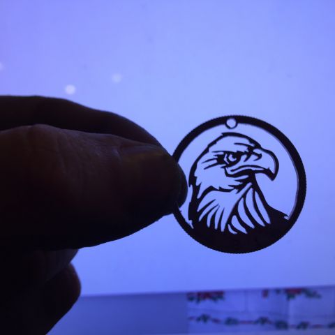

hotshot Posted October 8, 2016 Posted October 8, 2016 (edited) From time to time, Steve sends something out that strikes the right vibe,and I grab it. Just got an email from his email list that had an eagle as part of the pattern, so I grabbed the head portion for my coin. There were not a lot of inside cuts, so that made thing go quick and easy. Edited October 8, 2016 by hotshot Fish, Phantom Scroller, hawkeye10 and 5 others 8 Quote

hotshot Posted October 8, 2016 Author Posted October 8, 2016 (edited) That looks pretty cool. I have not known you long enough so please excuse the questions. I am guessing this is something you have been doing for awhile. Do you have others you would like to share??? Also what type coin is this and what are you cutting with?? Do you do anything else with these such as wrap around a pen tube?? There are many people who cut coins and wrap them around pen tubes and then cast in clear resin to make cool looking pens. Do you thin the coin??? Looks fragile. Looks great though. It is on my to do list which is quite lengthy. I never mind answering questions, and in fact, I have site (www.coincutting.com) detailing my method, in hopes of drawing others into this aspect of our hobby. In short, most of my work is done with Kennedy Half Dollars, CA to glue the patterns on (and CA to seal the pattern against the oil from drilling), blade is a Pike #3/0 Jewelers. As far as thinning, I do not as the thickness help keep the thin pieces supported. Early on, I tried sanding down to the copper on both sides, but I abandoned that approach pretty quick because the imprints on the coin add to the character of the coins. For the purposes of thinning the coins to be wrapped, that seems pretty workable. How thin does the coin have to be to be wrapped? I would probably use the sanding method were I to do this, however, some time back, as an experiment, I pounded a penny flat with a hammer until it was very thin, and big, then cut this: Edited October 8, 2016 by hotshot Quote

hotshot Posted October 9, 2016 Author Posted October 9, 2016 (edited) Randy, this is another outstanding piece, do you have a collection of them? How many do you figure you've cut so far, and which one would be your favorite subject? Len Len, I don't really keep a collection, but I've given or sold many. I've lost count of the number I've cut, but it is getting up there. Is was rough going for a while because all the serious coin cutters used the hand frame (and were reluctant to help), and I had to figure out a lot of this by trial and error. I've given away all my secrets, so those that come after me will have a much easier go of it. I'm not sure about which would be my favorite because I seek out themes that resonate with me . . . One coin design that is special to me is the two horses pattern, because it was my "break through" coin, really the first "impossible" design I cut. I received some positive feedback and encouragement, which helped motivate me to keep going. I believe this was also the first pattern that I tried the "Floating Effect On." See how it looks as if nothing is holding the horses to the outer coin? That is created by angling the coin up, so that the surface of the coin it cut away to make it appears to be floating. ------Randy Edited October 9, 2016 by hotshot Lucky2 1 Quote
