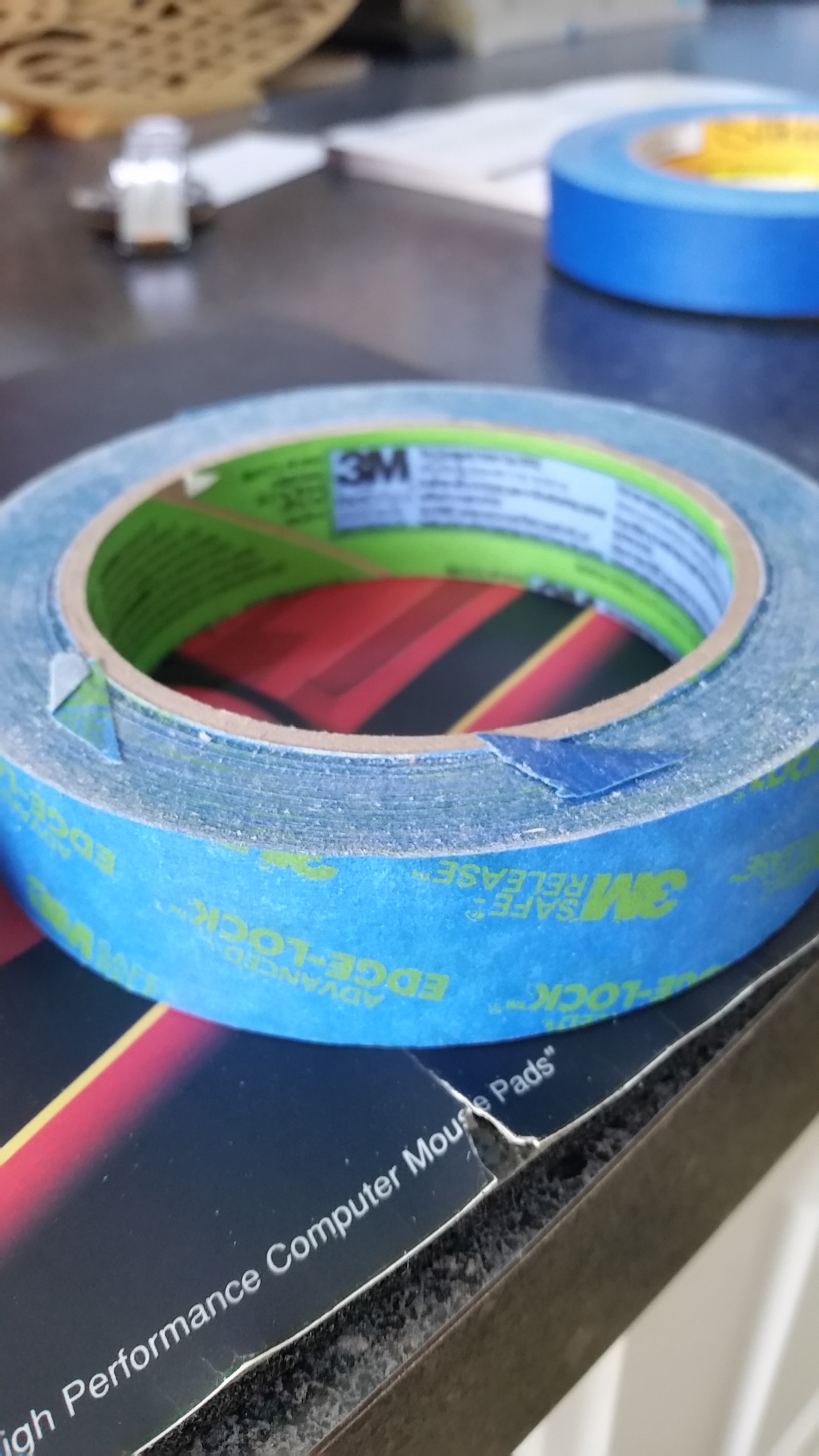

munzieb Posted August 21, 2018 Report Posted August 21, 2018 There is a difference! Last week I ran out of my "blue tape" and went to the local Loews to restock and bought regular blue tape. Big mistake. This tape has a crepy texture and will roll up very easily. I kept the original blank roll I had used and went back to Loews and got the right one. It's the 3M with "Edge Lock" . It has a smooth surface, adheres better and won't roll up. Loews Item # 63186 Model # 2080EL-SR-24T 3M Safe-Release 0.94-in Painter's Tape Quote
