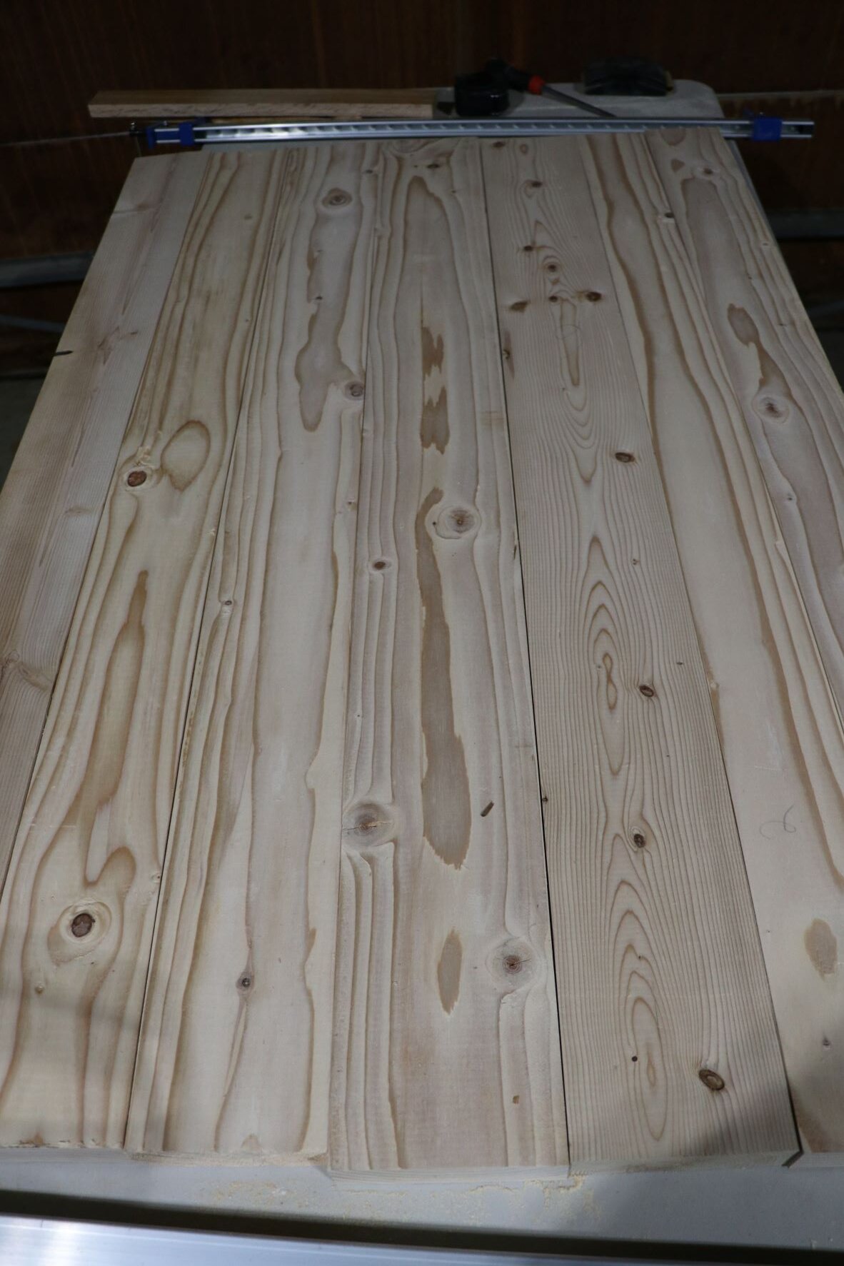

Joe W. Posted January 23, 2023 Author Report Posted January 23, 2023 Here are a couple photos of the wood pieces for glue up. To me, it looks like way too much gap. Using clamps tightens up the gaps a lot, but I'm concerned tightening the clamps up too much will result in poor glued up joints and possibly come apart. I'm waiting for a warmer day to use the dial indicator on the table saw to verify blade and fence are properly adjusted. OCtoolguy 1 Quote
OCtoolguy Posted January 23, 2023 Report Posted January 23, 2023 19 minutes ago, Joe W. said: Here are a couple photos of the wood pieces for glue up. To me, it looks like way too much gap. Using clamps tightens up the gaps a lot, but I'm concerned tightening the clamps up too much will result in poor glued up joints and possibly come apart. I'm waiting for a warmer day to use the dial indicator on the table saw to verify blade and fence are properly adjusted. To my old eyes, the gaps appear to be fairly uniform from one end to the other. I don't see any bowing or closing up at the ends or in the middle. How do they look if you turn the boards over? Also, are you alternating your grains? If the gaps look better on one side than the other, your blade isn't perpendicular to the table. Just brainstorming here. Try laying out the boards in the order that you will be gluing them up. How do the gaps look when you do that? If they are all about the same, I'd go ahead and glue them up. Don't over clamp them to close the gaps. The glue is stronger that the wood. Let us know what you decide. Joe W. 1 Quote
