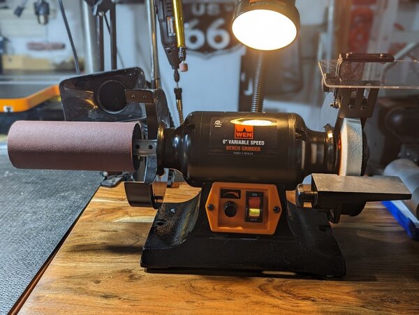

Scrappile Posted June 3, 2023 Author Report Posted June 3, 2023 16 minutes ago, rafairchild2 said: I would love to know where you got the 1/2 adapter and drill chuck, as I would like to add a mop to my bench grinder. Right now I have a soft barrel on the left and want to swap out the stone. Pretty sure this is where I got it. https://cuttingedgesupply.store/products/small-shaft-adapters?variant=33350098616419 MarieC 1 Quote

don in brooklin on Posted June 3, 2023 Report Posted June 3, 2023 4 hours ago, rafairchild2 said: I would love to know where you got the 1/2 adapter and drill chuck, as I would like to add a mop to my bench grinder. Right now I have a soft barrel on the left and want to swap out the stone. I bought my keyless chuck from Stockroom Supply https://stockroomsupply.com/products/keyless-chuck?_pos=7&_sid=1f7116d09&_ss=r Good guys. Ship regularly to USA as they are on the border. MarieC 1 Quote

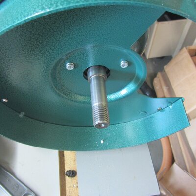

Scrappile Posted June 7, 2023 Author Report Posted June 7, 2023 On 6/3/2023 at 1:46 PM, don in brooklin on said: I bought my keyless chuck from Stockroom Supply https://stockroomsupply.com/products/keyless-chuck?_pos=7&_sid=1f7116d09&_ss=r Good guys. Ship regularly to USA as they are on the border. Don, does your grinder shaft have threads on the end for a nut to hold on the grinder wheels that came with your grinder? like mine Quote
Scrappile Posted June 7, 2023 Author Report Posted June 7, 2023 (edited) Boy Never thought it would be this difficult to get a chuck that will work on a 5/8" bench grinder. It appears you have to buy and adaptor. But I have not found one that I think will work on a threaded arbor. That is way I think Dave had to have one made so that was long enough that the set screws will tighten on the none threaded portion of the arbor. Most tighten on the threads of the arbor causing a bad wobble. I may have to find a machinist like Dave did. Edited June 7, 2023 by Scrappile Dave Monk 1 Quote
Dave Monk Posted June 8, 2023 Report Posted June 8, 2023 6 hours ago, Scrappile said: Boy Never thought it would be this difficult to get a chuck that will work on a 5/8" bench grinder. It appears you have to buy and adaptor. But I have not found one that I think will work on a threaded arbor. That is way I think Dave had to have one made so that was long enough that the set screws will tighten on the none threaded portion of the arbor. Most tighten on the threads of the arbor causing a bad wobble. I may have to find a machinist like Dave did. You might want to check this out. https://www.seyco.com/ris-ac-complete-small-accessory-kit/ Quote
Scrappile Posted June 8, 2023 Author Report Posted June 8, 2023 On 6/6/2023 at 6:36 PM, Scrappile said: Don, does your grinder shaft have threads on the end for a nut to hold on the grinder wheels that came with your grinder? like mine @don in brooklin on does your arbor Don, can you please let me know? Quote
