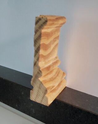

munzieb Posted November 14, 2023 Report Posted November 14, 2023 When we bought our house, the builder left a lot of 8' sections of window trim molding in the actic. I have used some in the past for various projects. I decided to make an 8 sided (octogon) box. The height was 3.5" and I cut the width the same with my mitre saw at 22.5 degrees. I had routered a 1/4 groove on the inside of the bottom of the whole piece before cutting the individual pieces. I made a base and glued and strap clamped it all together. Since wood was pine and finger joint connected, I decided to paint it all black lacquer. The top was also pine and I routered a recess on the bottom to fit into the base. I added some trim pieces to the top to give it a nicer contour. Added felt to inside of base and bottom of top. When my wife's foot gets better and is able to get up to her studio over the garage, she'll add some of her wonder painting to the top. BadBob, JackJones, MarieC and 5 others 7 1 Quote
