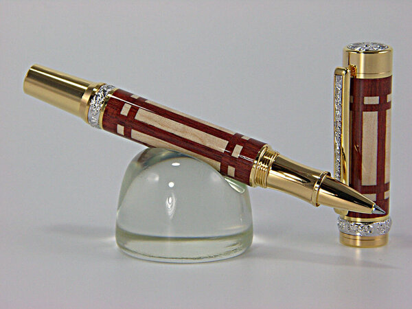

JTTHECLOCKMAN Posted March 31, 2024 Report Posted March 31, 2024 When you talk wrinkles there are 2 type. One where you celebrate as I did with my pen photo and then one where they are not welcomed like in my billiardball clocks. That was shot in a photo tent with a light grey covering. As I said i got rid of those things. They are not needed. As with that one that was shown you could accomplish same thing without tent and just focus lights on the object. I use a diffuser over the light bulbs. that is how the top pen was shot. If I wanted to get cute and play with all the image things and settings you can get even better photos. Your photo is only as good as you start with. I find these photo editing programs do very little other than size and maybe add some sharpness. That is just me. Again not shooting for sales and thank goodness. I do not have the patients for that stuff. Quote
