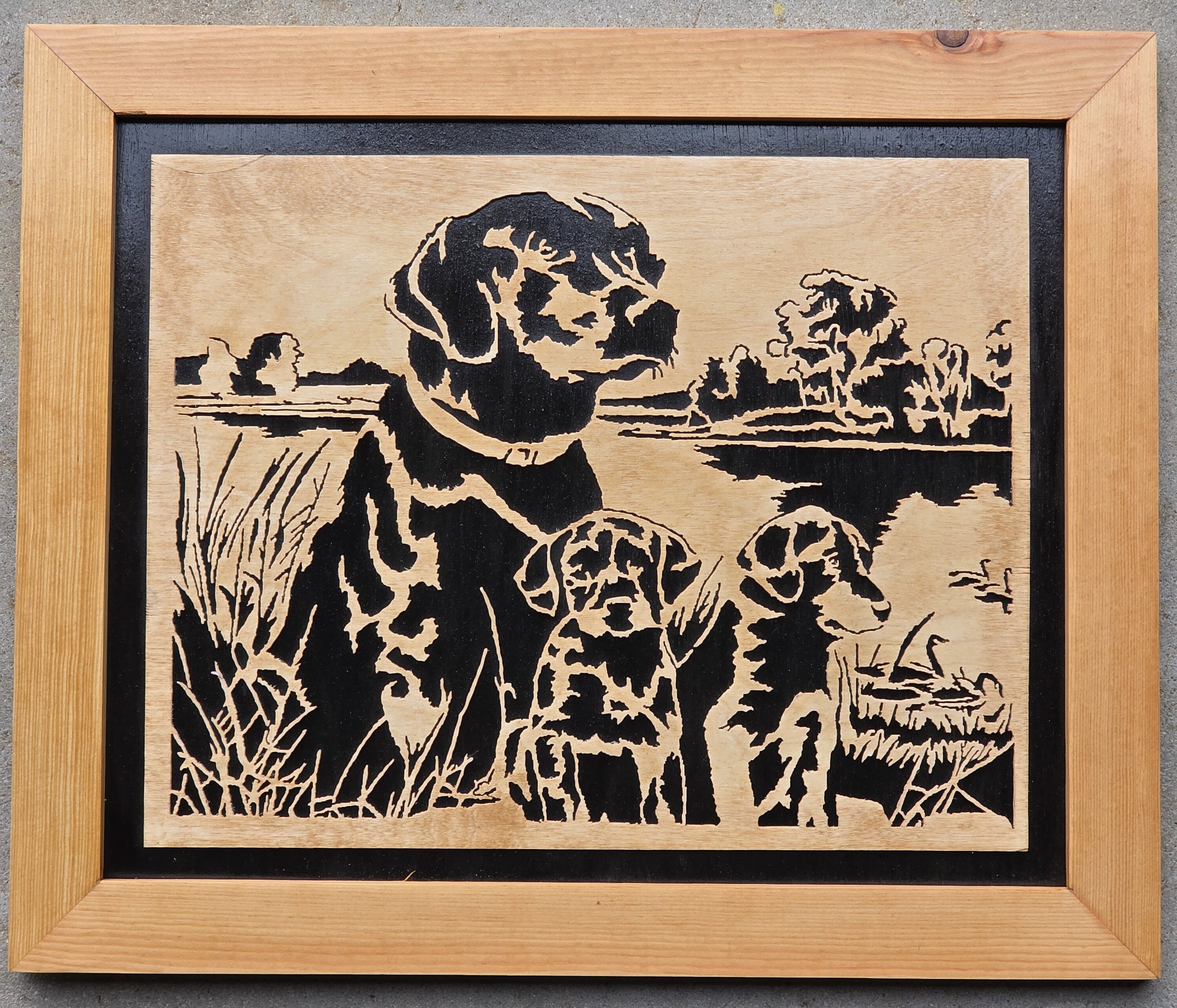

Popular Post Dak0ta52 Posted Wednesday at 04:44 AM Popular Post Report Posted Wednesday at 04:44 AM Between the weather and my health, it was good to finally get back into the shop and create some sawdust. The first is a Charles Dearing pattern (Lab Family) I purchased at the request of my wife. I stack cut 2 of BB with a BB backer. I used primarily Pegas #1 spirals and a few 2/0 in some of the tighter areas. I will say the pattern, purchased from Wooden Teddy Bear, had a few issues where I had to do some scroller editing to keep from having dropouts. The size with frame is roughly 12X18. The frame was made from pine. The second is a smaller piece (approximately 6X10) also of BB with a BB backer. I used Pegas MGT 2/0 and 0 blades. For the life of me I can't remember where I got the pattern and it didn't have the designer's name. If anyone knows the author, please let me know so I can credit them with the nice pattern. Finally is a Steve Good pattern I cut for Mother's Day. My mom is 92 and is in early stages of Dementia. I've cut pieces for her on her Birthday and Mother's Day since I've been scrolling. This one makes about 8 pieces I've cut for her and she has me hang them in her Dinette where she spends most of her time. This piece was cut from BB with a BB backer using Pegas 2/0 and 0 MGT blades. The first two pieces are stained using Ipswich with Pure Black stain for the backers. They were finished with several coats of Polyacrylic and sanded with 600 grit between coats. The frames on the first two pieces are also stained with Ipswich. I also added splines to the corners, but they are unseen from the photos. The Mother's Day piece is stained with Natural, and the backer is stained with Red Oak. Dave Monk, ChelCass, Hawk and 7 others 10 Quote
preprius Posted Wednesday at 05:04 AM Report Posted Wednesday at 05:04 AM Nice cutting. The labs are so cute. The right pup seems a bit distracted by the ducks in the water. The mothersday plaque has some nices smooth cuts. Nice contrast also. Dak0ta52 1 Quote
Scrappile Posted Wednesday at 02:18 PM Report Posted Wednesday at 02:18 PM Very well cut and finished. It looks like you have mastered the perfect 45° cut. I am still working on that. Dak0ta52 1 Quote
Aggie Posted Wednesday at 02:35 PM Report Posted Wednesday at 02:35 PM Very nice work Dak0ta52 1 Quote
rjweb Posted Wednesday at 03:02 PM Report Posted Wednesday at 03:02 PM Welcome back to saw dust, excellent cutting, RJ Dak0ta52 1 Quote
MarieC Posted Wednesday at 04:10 PM Report Posted Wednesday at 04:10 PM Really nice work. I love the horse one. Great cutting on the Mother's day lettering Dak0ta52 1 Quote
