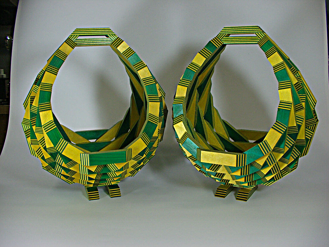

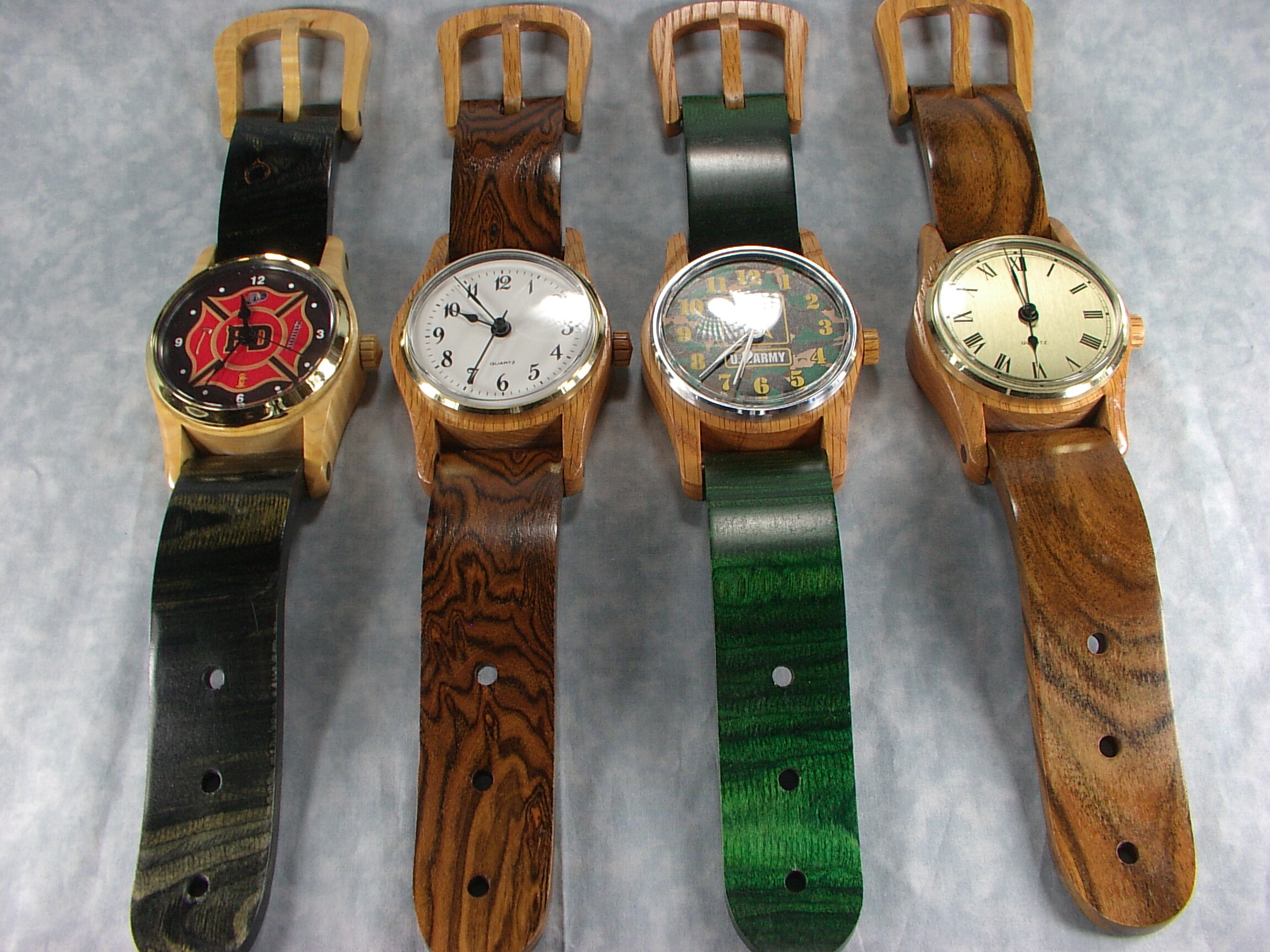

JTTHECLOCKMAN Posted July 8, 2025 Report Posted July 8, 2025 (edited) 17 hours ago, Tom Gi said: Has anyone cut polywood not plywood I got a half inch thick piece and want to cut out something to hang outside it looks like it is all plastic and no wood in it your thoughts on this thanks You have to be careful of the terminology. If you are talking true polywood. This is a plastic and done by the Amish. Their invention and probably the only place to get it. Now there is a product called Dymondwood but hard to find any more. The factory where that was made burned down and no one picked up the product that I know of. It is thin layers of real wood encased in a resin and put under high pressure to cure. Then there is spectraply which is wood layers and encased in adhesive under high pressure as well. Then there is a product called colorply which also is layers of wood oriented in various directions to show unique patterns. It too is encased in a wood adhesive and then stabilized in a resin. All look the same but are very different. Examples of spectraply. Easy to get in blocks or sheets. (baskets) Dymondwood (watches green and black bands) Any of these types are tough on scrollsaw blades because of both the glues used and the resins used. Edited July 8, 2025 by JTTHECLOCKMAN OCtoolguy and kmmcrafts 2 Quote
