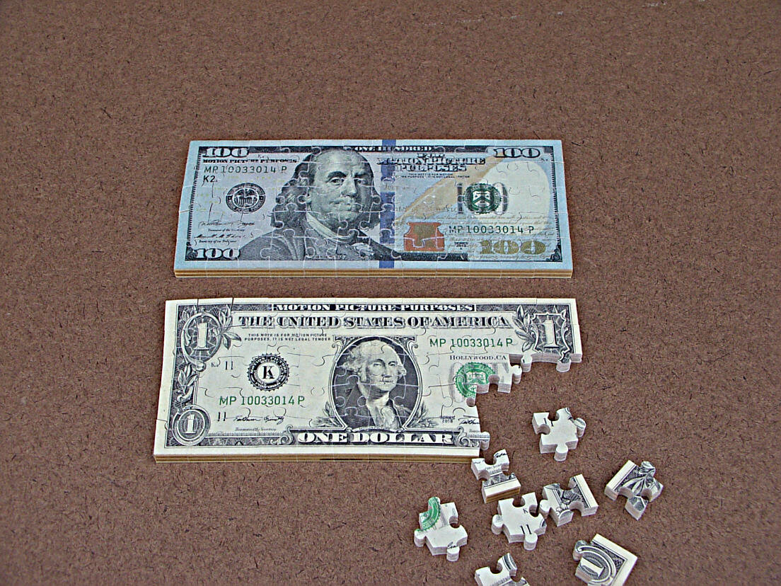

JTTHECLOCKMAN Posted August 28, 2025 Posted August 28, 2025 (edited) What kind of puzzles are you talking about? If you are talking those stand up animal puzzles then the pieces are large enough that if you have any fuzees it is easy to sand. but if you are talking small puzzles then I suggest you use Baltic Birch as material and no sanding is needed when using puzzle blades. This is the type I do. and no sanding is needed, I in fact place a front face of bill and a back face of the bill on opposite side and cut away. Edited August 28, 2025 by JTTHECLOCKMAN barb.j.enders and Roberta Moreton 2 Quote

Gordon Wu Posted August 28, 2025 Author Posted August 28, 2025 Ahh. Interesting. I'm leaning toward small puzzles like the dollar bill puzzle shown above by JTTHECLOCKMAN. Another question, would you need to sand down the Baltic Birch before gluing the picture onto the wood? I've read it helps with the picture adhering but not sure how important it is. I'd prefer not getting equipment that I won't actually need. Good to know that a sander may mess up the front side. Didn't think about that. So it sounds like Baltic Birch won't generate fuzz if cutting with a puzzle blade...is it the flying Dutchman puzzle blade or are there other brands that's similar? And does it have to do with the TPI or the shape of the teeth? What causes and how to minimizes fuzz when cutting? I'm happy to go experiment but it's be good to learn from the collective knowledge of the community so I have an idea what has and hasn't worked. Thank you for the thoughtful responses! Quote

JTTHECLOCKMAN Posted August 28, 2025 Posted August 28, 2025 (edited) My method is simple. Yes always sand the BB plywood before attaching paper. Second vac it off. Then what I do is spray with dewaxed shellac. I use 3M 77 spray adhesive. Yes on the roller. Need to make sure all air bubbles are out. I let dry. I then do a quick hand sand on the edges incase any adhesive over spilled. By the way my blanks are cut exactly to the size of the dollar bills. Then I spray both top and bottom with several coats of flat lacquer to seal the paper. The first coat is a light mist to not soak the paper. It would change the color of the print if soaked. After that I will spray several more coats till I am satisfied. Nothing is written in stone. Then I wait a day before I now place scotch tape around the entire blank. I am sure you could use other materials for this. The tape lubricates the blade because as mentioned they dull very quickly because of the very thin and small teeth. I then attach pattern with the same 3M adhesive. Yes when cut I then have to peel the tape off but it comes off easily because of the lacquer. just my way of doing this. Your mileage may vary. Test before committing. I have cut many of these and sold many. After doing a few the cuts become so easy and redundant your mind may wonder so stay alert. The advantage of what I do, the people actually get 2 puzzles in one. They can assemble as front or back. When they mix them they can become even more of a challenge. I do not worry about the wood because BB is a nice wood that is strong. you want to use a puzzle blade for small puzzles like this because the pieces stay together and are not too loose when cut. Use larger blades and the piece fall apart easily. When I sell them I had bought some nice resalable plastic bag that are perfect size. I then found some nice size boxes that work well too. Makes a nice gag gift. or stocking stuffer. Steve Good has the patterns on his site. Being I am sharing my method I should mention to save time in the end, I cut these in strips. Does not make a difference top to bottom or end to end. But after I cut them I place the strip aside and do the next just to keep all together. Alot more work if I had to assemble all of them. . I like doing puzzle like the next guy but that would be ridiculous. Even after I take all tape off I line back up and put together. I use a thin piece of cardboard to keep assembled and till I bag them. I in fact include said cardboard with the puzzle so that when they take out of box it is laying flat. They are the first people to take apart and reassemble again. Edited August 28, 2025 by JTTHECLOCKMAN BadBob and kmmcrafts 2 Quote
