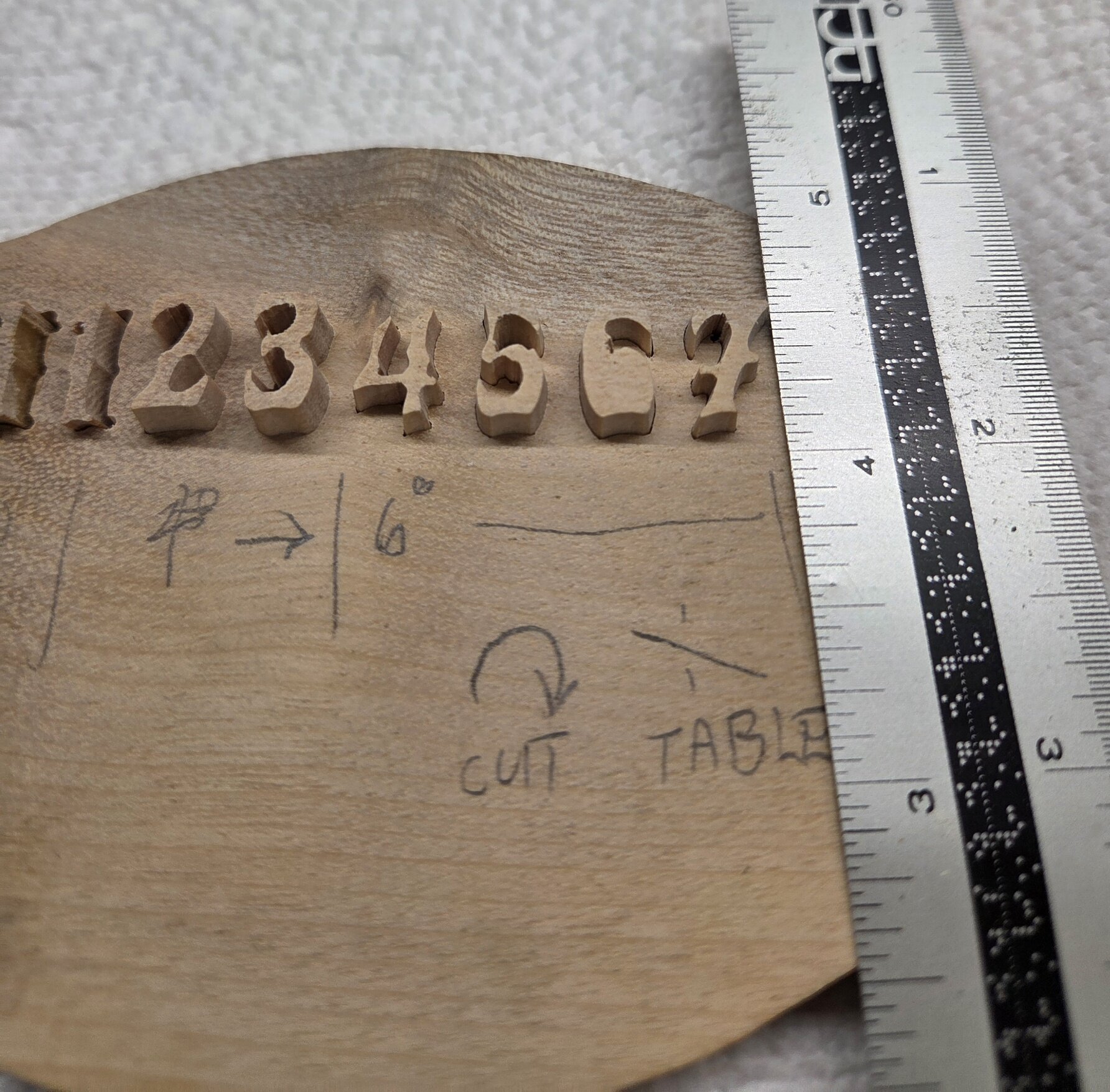

preprius Posted October 25, 2025 Posted October 25, 2025 (edited) What is the smallest text size that has been done using relief (emboss) technique? Followup question. What is smallest text size for inlay? Here is my attempt on 1/4 thick wood. the inner portion if "3" broke out and i purposely did not cut out the hole from the 6. I used #1 blade due to 1/4" wood. Text size is slightly less than 1/2". the 0 and 1 , I cut the wrong direction. So i added notes for table angle and cut direction. I am not consistent at direction of table tilt. I overthink cut direction or I forget to think about it. That is why I do a trial run on scrap wood. Edited October 25, 2025 by preprius JackJones, TAIrving and OCtoolguy 3 Quote
Denny Knappen Posted October 27, 2025 Posted October 27, 2025 I think the smallest I made was 1 inch. Suggestion on the "6" use a fount that is scroller friendly. OCtoolguy 1 Quote
Scrappile Posted October 27, 2025 Posted October 27, 2025 (edited) I have done enlay down to 1/2". Same as relief only at a slight angle. You are correct. I always have to concentrate on the direction of cut. But it is fun to do. This is a pretty good book on Relief cutting. It is what got me started. https://www.ebay.com/itm/256436403190?_skw=scroo+saw+relief&epid=1081578&itmmeta=01K8K5FEXJ44PGS0PS6KNXKM3R&hash=item3bb4ccfbf6:g:pNkAAOSw82Fl5~eU&itmprp=enc%3AAQAKAAAA8FkggFvd1GGDu0w3yXCmi1egQq2frKIOVSCbac8zVDD0744SbKp2KdR6FhjF9aoOAstJXdZUa9V38RhBiw7z7nYpOQYn5AoU2oBVw2PTkQEtePw1ECdri7YAoC9V0HW%2BBVq%2BKCOQGdSPZSRsp3Y7QccSiVGFyz18wkie725AZIOT12LOb1hAh8bN3nKUC8NdAO0YBiLoSDAy7r0OdpzPOwc5CIzg956%2FJZQFHHk3Ob4RG5JTFpqsvaFSBRPe5Stg6OruncCdEymot2PNlELkn%2BA0YCioz9HfJU%2F3Rv3dKt68dH7%2BaWRMtHRZKHZFoCH0jA%3D%3D|tkp%3ABFBM6O-95cRm I use this book to learn how to relief cut the tree and heart in this piece. Edited October 28, 2025 by Scrappile OCtoolguy and barb.j.enders 1 1 Quote

barb.j.enders Posted October 28, 2025 Posted October 28, 2025 20 hours ago, Scrappile said: I have done enlay down to 1/2". Same as relief only at a slight angle. You are correct. I always have to concentrate on the direction of cut. But it is fun to do. This is a pretty good book on Relief cutting. It is what got me started. https://www.ebay.com/itm/256436403190?_skw=scroo+saw+relief&epid=1081578&itmmeta=01K8K5FEXJ44PGS0PS6KNXKM3R&hash=item3bb4ccfbf6:g:pNkAAOSw82Fl5~eU&itmprp=enc%3AAQAKAAAA8FkggFvd1GGDu0w3yXCmi1egQq2frKIOVSCbac8zVDD0744SbKp2KdR6FhjF9aoOAstJXdZUa9V38RhBiw7z7nYpOQYn5AoU2oBVw2PTkQEtePw1ECdri7YAoC9V0HW%2BBVq%2BKCOQGdSPZSRsp3Y7QccSiVGFyz18wkie725AZIOT12LOb1hAh8bN3nKUC8NdAO0YBiLoSDAy7r0OdpzPOwc5CIzg956%2FJZQFHHk3Ob4RG5JTFpqsvaFSBRPe5Stg6OruncCdEymot2PNlELkn%2BA0YCioz9HfJU%2F3Rv3dKt68dH7%2BaWRMtHRZKHZFoCH0jA%3D%3D|tkp%3ABFBM6O-95cRm I use this book to learn how to relief cut the tree and heart in this piece. What font did you use for this piece? Both the script and the block. OCtoolguy 1 Quote

don in brooklin on Posted October 28, 2025 Posted October 28, 2025 5 hours ago, barb.j.enders said: What font did you use for this piece? Both the script and the block. Barb. the script is scrollscriptmt The block is a variation on Times new roman bold. I have never font a scrollable version to this font so I add my own bridges. I tested out OCtoolguy, Scrappile, barb.j.enders and 1 other 4 Quote

Roberta Moreton Posted October 30, 2025 Posted October 30, 2025 I am currently bevel cutting letters that are 3/4”. OCtoolguy and preprius 1 1 Quote
