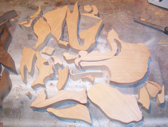

update 2. Its been a few days since I've done any work, but I got a little done tonight. All the pieces are cut except the eyes. I save them for last. and I've started fitting the pieces together. This and sandind/shaping takes the most time.
Update 3, After spending most of last week behind the wheel of a snow plow I finally got a couple hours of shop time tonight. I got everything fit together ready to start sanding and shaping. All except the eyes. Those are the last things I cut and shape, since there is 7 pieces to each eye. I get the exact shape of each then cut into the pieces.

Update # 4. I ve started the shaping and sanding process. The pieces picture is about 2 1/2 hours work. After I got them shaped I glued together small sections. Once I get the rest shaped I will finish putting it all together. I still have a little touch up sanding to do on these yet, but once I get the rest shaped I will hit everything with the final (touch up) sanding. to remove any scratches/grooves that I missed. Or to contour it better to the adjoining piece. Can't really tell by the picture but, the hair is raised(thicker) than the skin (lips), and the robe.
That's great, Clayton! What was the process you used for the shaping? Which tools did you use? Do you use regular yellow wood glue to glue up your pieces? I must say, watching you go through the process is a huge help for me! Plus it makes it a little less intimidating. Keep up the good work! :thumbs:

I just round over and shape the pieces according to the look I'm shooting for. I just keep taking more off until I'm happy with the shape. Once I get them to where I like them I will check them with an adjoining piece to see if more needs to be sanding off or not. My main tool I use is an oscilating spindle sander, this helps to square up the edges for a close fit too, in case the cuts were a little off. I also use my dremel with a sanding drum and of course hand sanding. I use regular wood glue most of the time. i try to get glue that dries clear in case I get sloppy with it. On this piece I tried something new to me. I checked out a book at the library by Kathy Wise, it had some patterns in it and some very helpful tips. She uses silcone(for window & doors it comes in a small tube) to join pieces together. I am trying this, the pics in the last post were glued together with silicone and it worked.
Then once all the pieces are together you can trace the shape of the backer and cut out, then glue project to the backer with wood glue. I am hoping to have all the shaping and sanding done tomorrow night and glued together. Then to apply the finish saturday. If this goes according to plan I will have more pics tomorrow night.

Tonight I finished shaping all the pieces. They were all glued up into small sections, then glue all of them together. I like using the silicone as mentioned in the last post, because if something doesn't fit right the pieces will come back apart easily, unlike wood glue. The picture of the whole project has a string tied around it to keep the pieces tight together while the silicone sets. Tommorrow when its dry I will cut out the backer and glue it to the piece. Then I will start work on the eyes, hopefully by tommorrow night it will be completed with a coat of finish on it.
