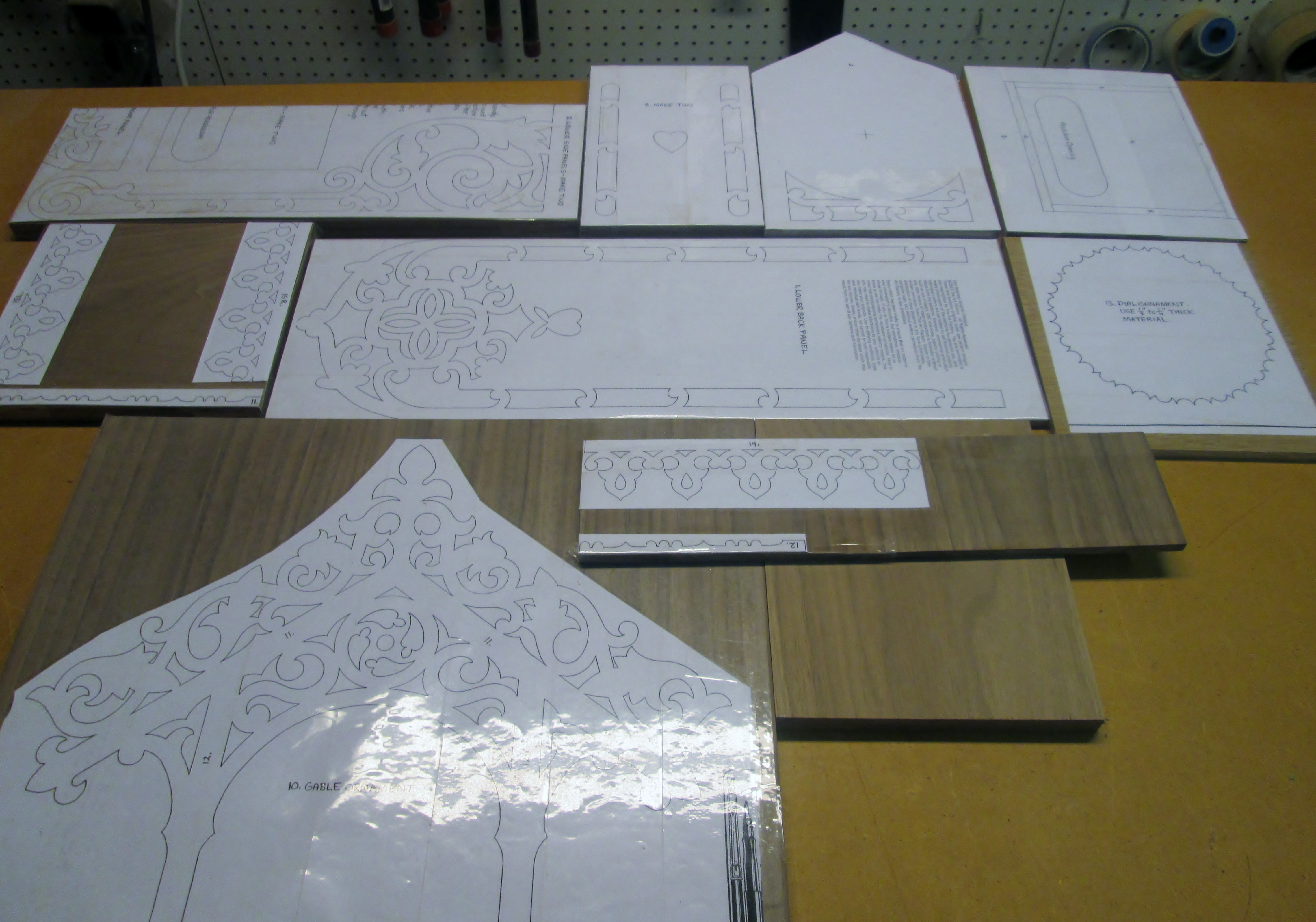

Popular Post ben2008 Posted March 24, 2021 Popular Post Report Posted March 24, 2021 (edited) I just started this clock. I'm doing mine in walnut. I have gathered the wood. I have most pieces cut to size and have some already laid out with the pattern attached. It will have a Westminstern Chime installed. I should be able to start the fretwork by this weekend. I'm very slow and pretty sure this will take me a month or more to complete. Maybe longer as I only work about 2 to 3 hours a day and about 3 to 4 days a week. I'll post some pics this weekend. The "Wakefield", from The Art Factory All clock parts cut to size. Some holes drilled. I love my mini Dremel drill press. Once it's set up it's breeze to drill holels accurately. On the RBI and ready to cut. I'm going to try and get some parts done this week. Have 2 Dr's appointments to deal with. Very unpleasent Edited May 17, 2021 by ben2008 don watson, Tbow388, Dan and 10 others 13 Quote

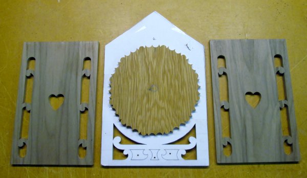

ben2008 Posted April 19, 2021 Author Report Posted April 19, 2021 (edited) 4/19/21 Another update for my fretwork clock. I'm getting there slowly but surely. Got sidetracked for about a week or 10 days. Hope to stay on track this week. Edited April 19, 2021 by ben2008 Scrappile and Tomanydogs 2 Quote

ben2008 Posted April 20, 2021 Author Report Posted April 20, 2021 4 hours ago, TexasDIY said: Looks great! Can you please tell us what kind of wood and the thickness you are using? Very impressive work you are doing! The majority will be 1/4" walnut. I also have a piece of 1/4 " oak (dial backer)and a piece of 3/8" Walnut I will be using. I'm cutting it with an Olson 2/0 reverse tooth blade. Quote

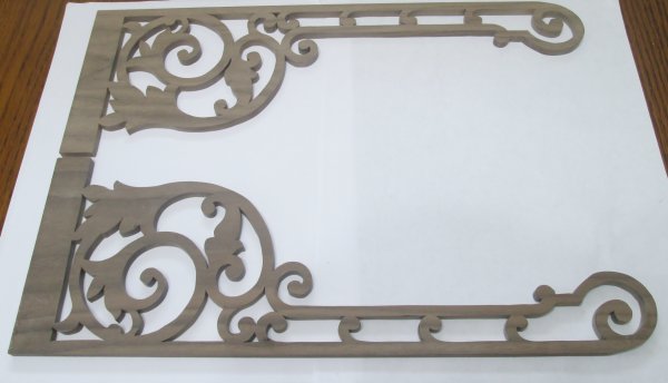

ben2008 Posted April 22, 2021 Author Report Posted April 22, 2021 4-22-21 A little more progress. Very little Just not up to it up today. Quit and came upstairs. When I don't feel good and try and push myself is when I make mistakes. So now, I decide tomorrow is another day and maybe things will be better. These 2 pics are the front and sides of the housing for the Westminster movement. I just have to make the back and some inside support pieces and I'll be done with the housing. I have the roof done, just need to fit it. Not much scrolling here as you can see. However, I still have a few trim pieces for the front and the sides to make that do have quite a bit of scroll work. I'll try again tomorrow. Rockytime and TexasDIY 2 Quote

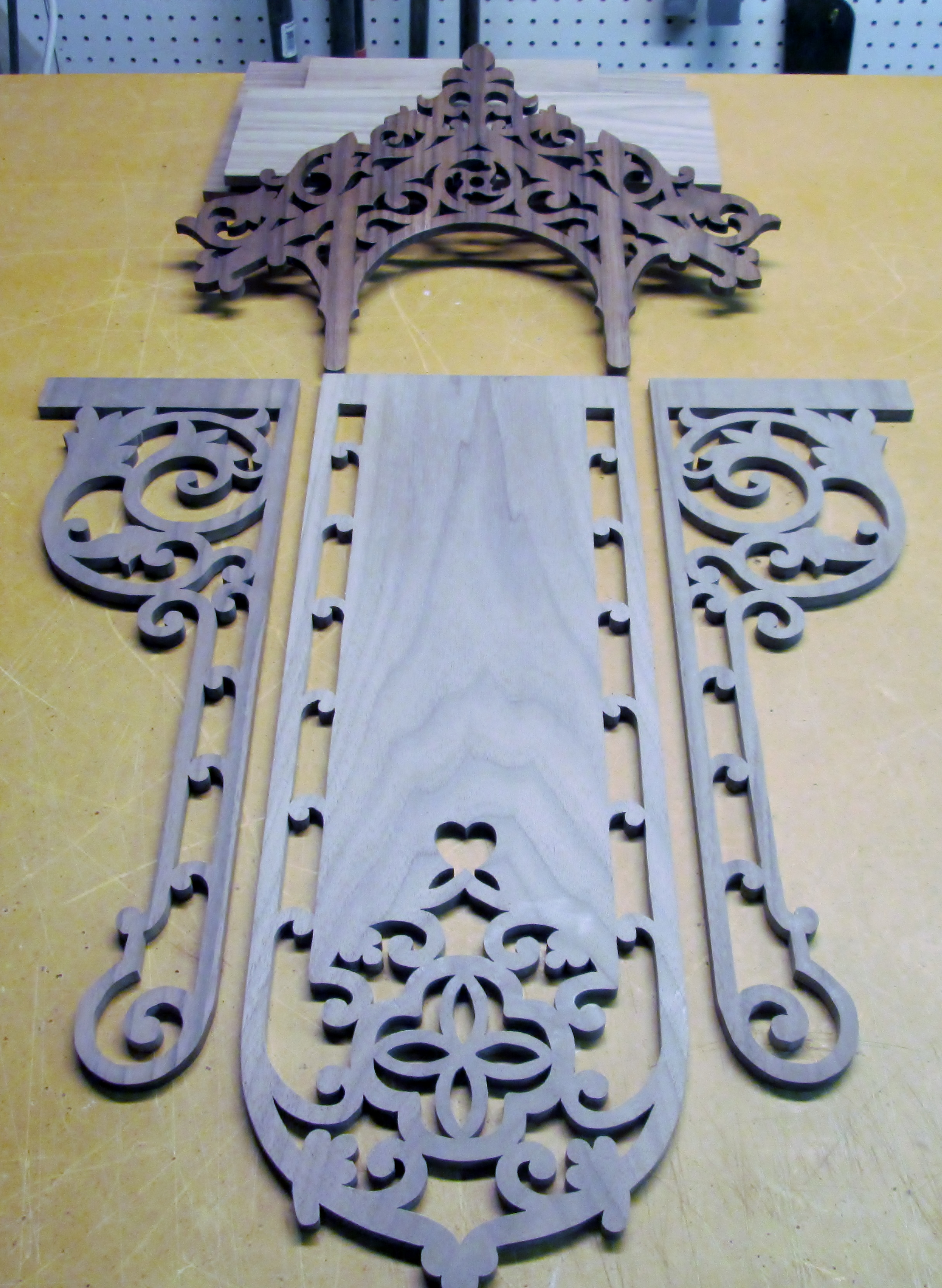

ben2008 Posted May 6, 2021 Author Report Posted May 6, 2021 (edited) Acouple of more pieces done. The clock movement is mounted. I will install the hands later. Most all parts are finished and I am in the process of finishing. That will take a few more days probably longer as i want these coats to dry thourogly. I said it would take me a while. It's turning out just fine so far. I'm finishing it with at least 3 coats of Deft satin spray lacquer. A couple of pieces of wood needed 4 coats. Edited May 6, 2021 by ben2008 TexasDIY, Tomanydogs and don watson 3 Quote
