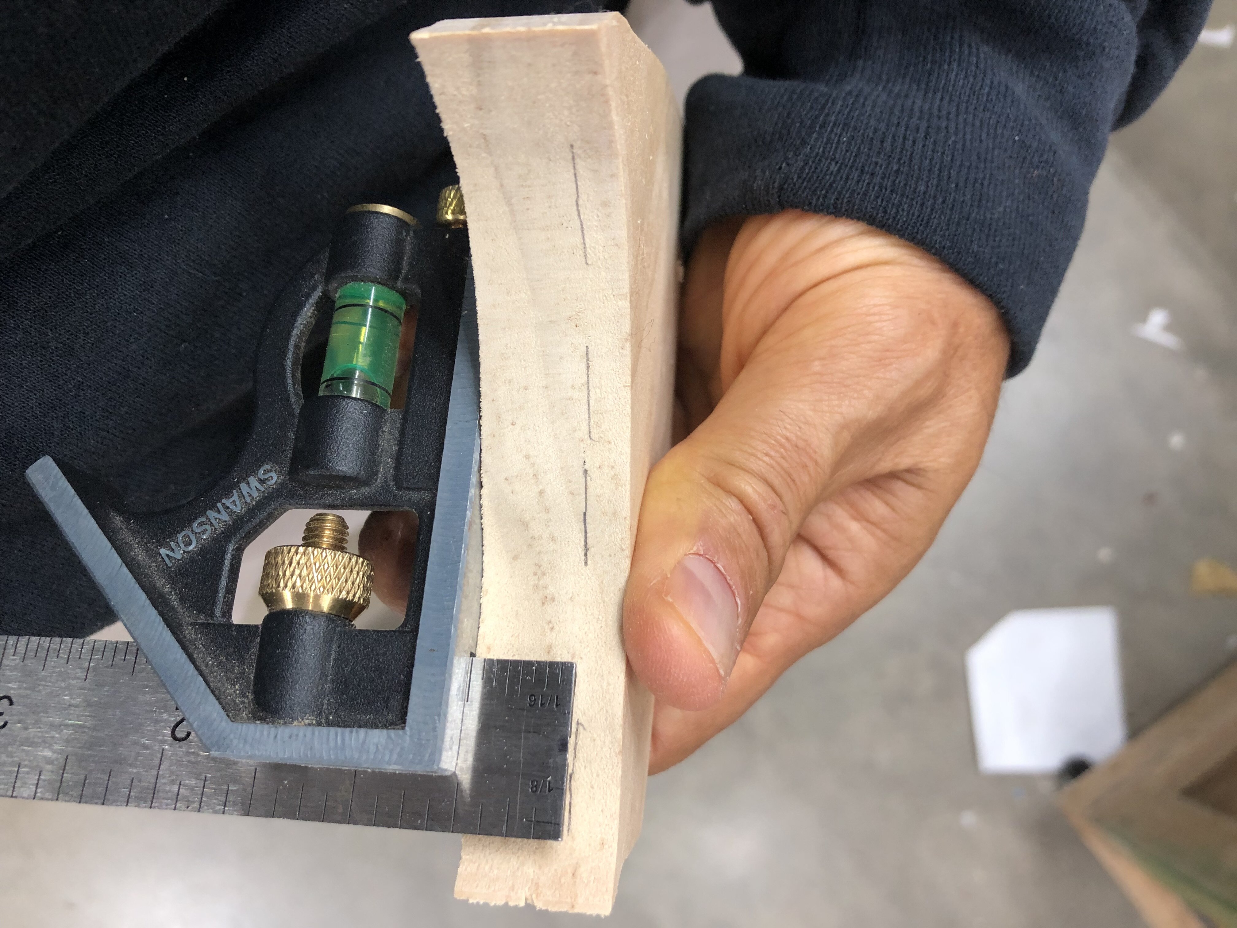

Brianr24 Posted June 11, 2023 Report Posted June 11, 2023 I know ur a master on the saw so ur not going to have to worry about gaps when shaping my suggestion is don’t try to get too fancy just softly round over all ur edges. I like to set my adjustable square to a depth maybe 3/16 or 1/4 depending on thickness of ur project as put pencil marks just to keep u roughly on track start with ur back round pieces first and work out probably neck feathers to beak good luck Scrappile and MarieC 1 1 Quote
