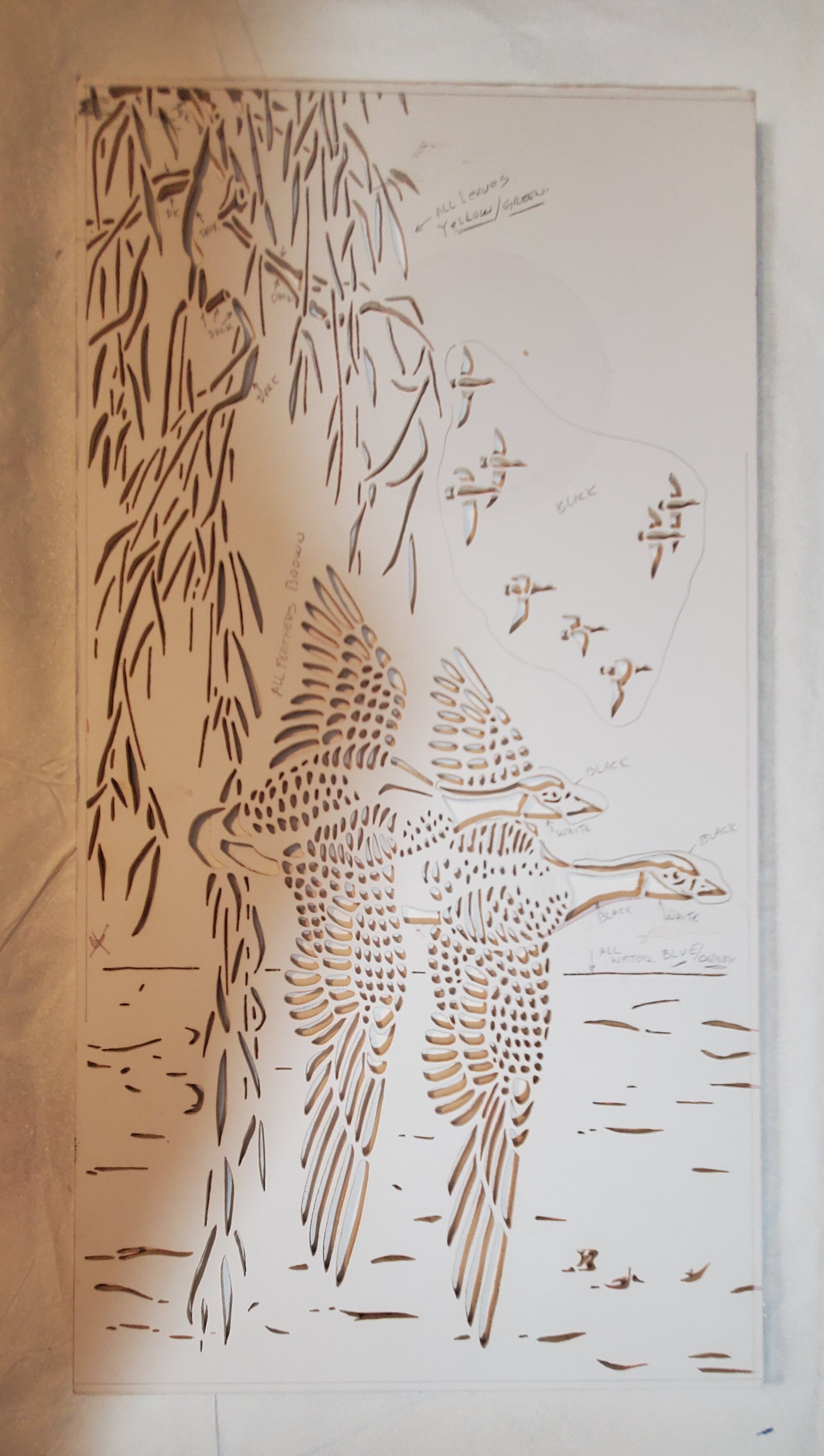

In the first photo you can see the almost completed cutting.  Here I must emphasize that I always apply clear Duck Brand shelf liner, that I buy at Walmart, to the well sanded cut panel from edge to edge.  The paper pattern is then applied to the liner with 3M-77 spray adhesive, again covering the panel from edge to edge.
My plan was, at this point, to paint; 1. The hanging Willow tree leaves a yellow/green with the visible branches a darker greenish/brown, 2.  The water details blue/green, 3. The distant Geese Black, and, 4. The Geese in the foreground brown with black head and neck with a white patch under the neck.  I found these colors on-line in photos of Migrating Geese.  You can see in the next photo of the finished cut panel that I marked the different areas the colors to be painted.  This was done for the photo.

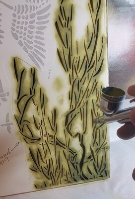

I affixed the cut panel to the backer temporarily with double stick tape.  I also printed additional copies of the paper pattern to use as painting masks.   With the shelf liner and pattern in place, I was able to use the Air Brush to paint the backer directly through the cut panel.   The advantage this offers is the ability to paint the vertical cut surfaces while painting the backer.  You can see in the following photo that the panel was upside down at his point.  I found I needed to rotate the panel to be able to get all the vertical cut surfaces painted.   You can also see the painting mask I had in place.   The painting masks were held in place with a Krylon product called Easy-Tack Adhesive (available at Hobby Lobby with the Mod Podge products).   I found the temporary adhesive allows the masks to be easily removed after the Air Brushing is complete without leaving adhesive residue.
In this next photo I’m beginning to paint the Geese brown bodies.  Again, the painting mask were in place.   Although the amount of paint needed, using an Air Brush, is very small, getting the paint through the cut panel onto the backer required a lot of spraying.  The second photo shows the completed green and brown areas.

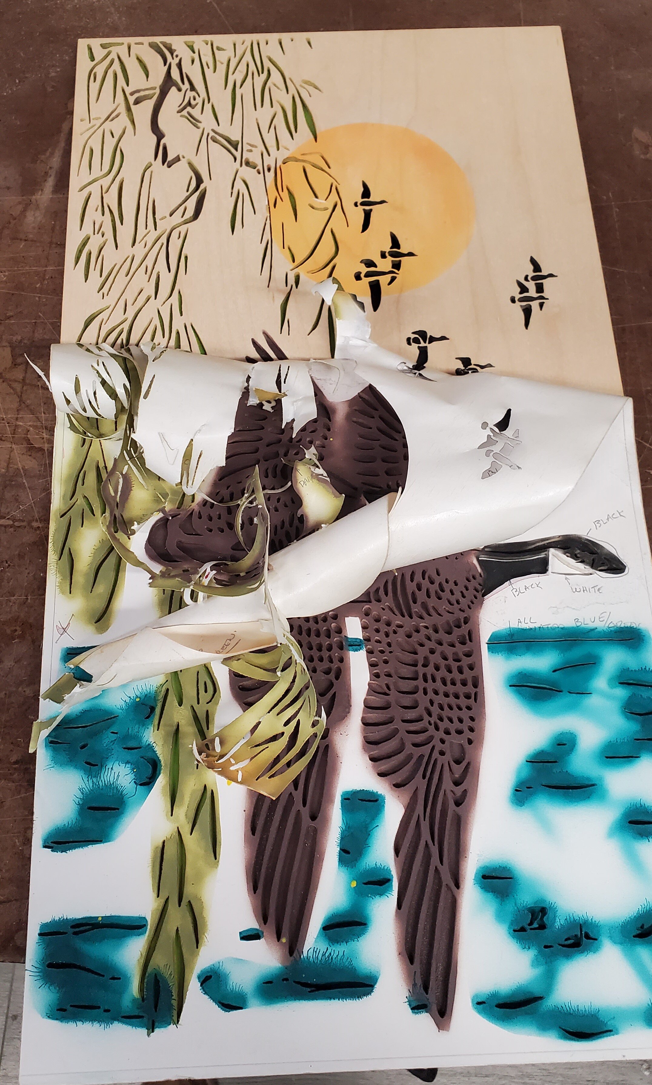

In the next photo, the back side of the cut panel is on the left and the painted backer panel on the right with all the colors complete.  The little bit of white paint that got on the back side of the cut panel was because I use a brush for this very small area.  Spraying white paint on top of the white Gesso is hard to see coverage.
No matter how careful I am, and even though the cut panel and backer are the same size, registration seems always to get “OFF” a bit.  After separating the panels and removing the double stick tape, when I  viewed the backer through the cut panel, areas of white primers was visible.  I had to expand the paint coverage to the various areas on the backer to make sure no primer was visible. This can be seen in the next photo of the backer on the left side.  I did this directly on the backer.  Being careful I found I could use the Air Brush free hand without overlapping adjacent colors.  This pattern was very forgiving but other patterns may require more masking.
In this next photo, on the right side, the cut panel has a Sun is part of the pattern.  This could not be cut out as the Geese are flying in front of it.   To get that effect, I removed a section of the pattern and liner where the Sun is and painted it with a yellow/red color (looks tan in photo).

After the glue has cured, I removed the assembled panel from the press.   It is only at this time that I removed the liner and pattern as can be seen in this  next photo.  As can be seen the liner and pattern prevents the paint from getting onto the surface of the cut panel, except where it was done deliberately to paint the Sun.  I must point out here that this does not work well if attempting to paint the backer using a brush.  Paint applied with a brush will bleed under the liner and pattern.  An Air Brush does not apply the paint as heavily and as wet as a paint brush does so there is no bleed under the liner.
