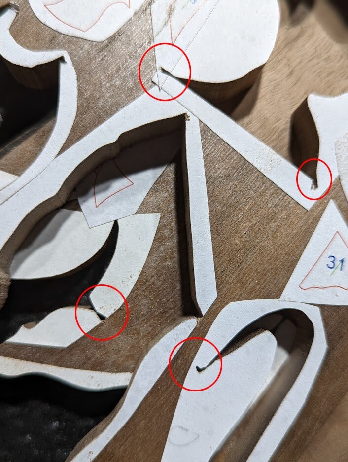

rafairchild2 Posted June 25, 2023 Report Posted June 25, 2023 (edited) 2 hours ago, Davevand said: The thing that always gets me is that the blade drift will change as it gets used and duller. I will have a good idea of how much I need to angle the piece to cut the straight line, then I will change out the dull blade for a new sharp blade and the drift will be totally different. This gets me especially at 90 degree turns. Very true, this is why I change my blades frequently. Remember too that heat affects the blade, thus another reason why I go slow and also use clear shelf liner (lubricates blade) that I put my pattern on. Remember going slow allows you to watch the drift and micro-correct so you stay on the line. Also, make sure as best as possible listen to the blade, you will hear more "chatter" as the blade dulls too. I have given up trying to turn on my 90 degree's, or really any sharp turns, I tend to do a "nibble", turn the blade, line up the next cut to get the most accurate and sharp cuts. See below how I nibble a turning spot, change direction and away I go. Edited June 25, 2023 by rafairchild2 OCtoolguy 1 Quote

rafairchild2 Posted June 25, 2023 Report Posted June 25, 2023 15 minutes ago, Peter N White said: Can't open your lick. Fixed it. OCtoolguy 1 Quote
