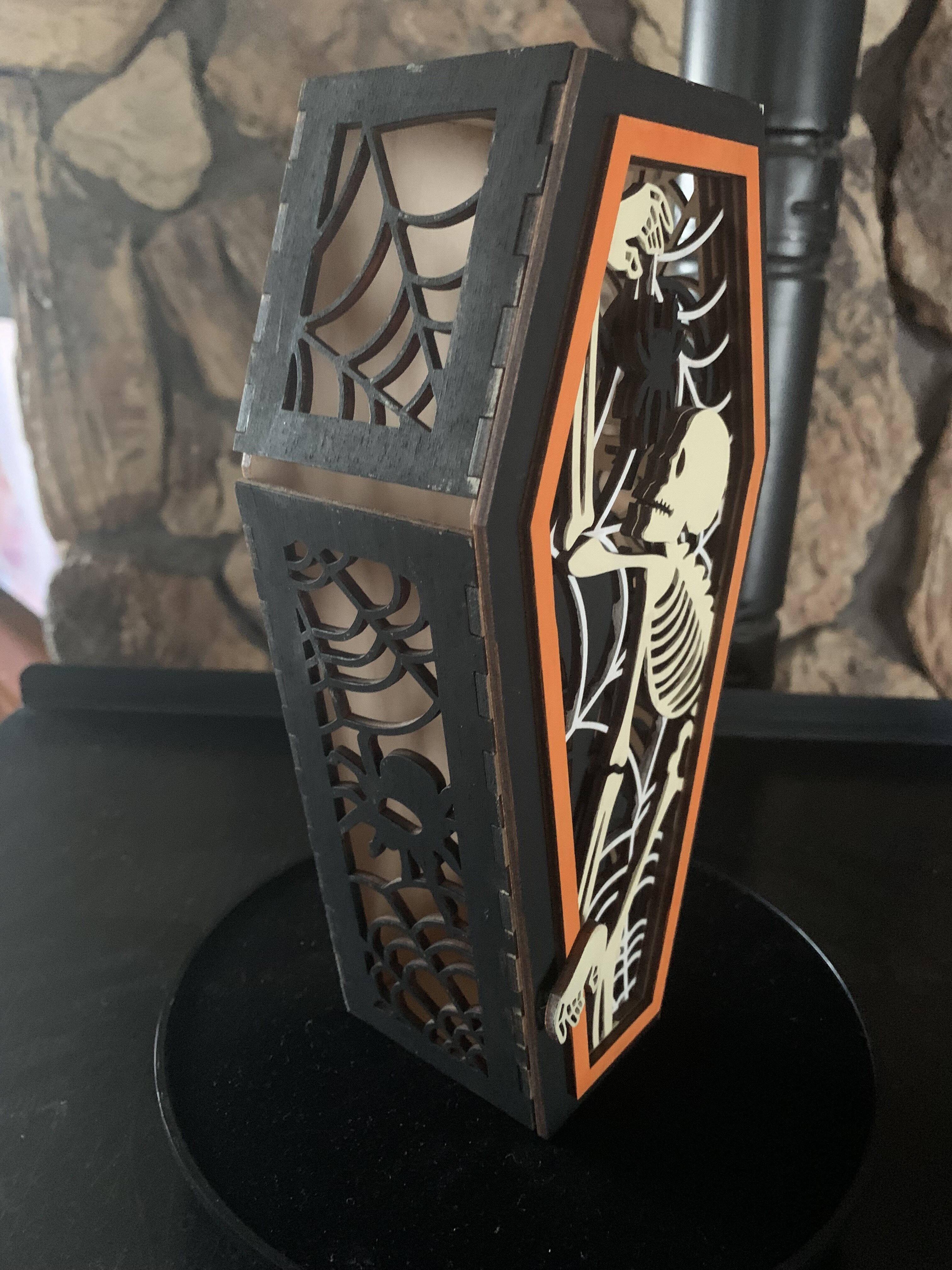

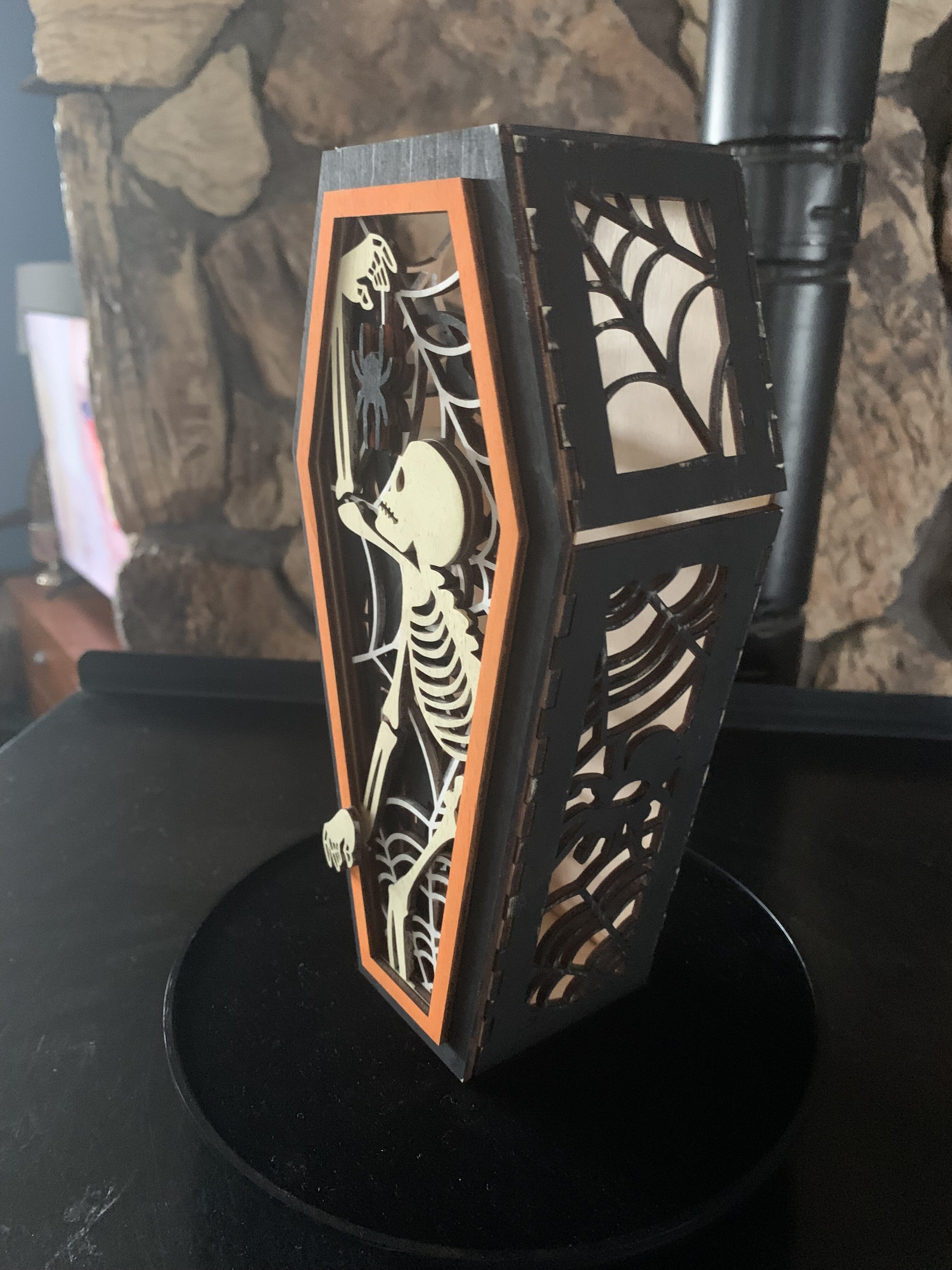

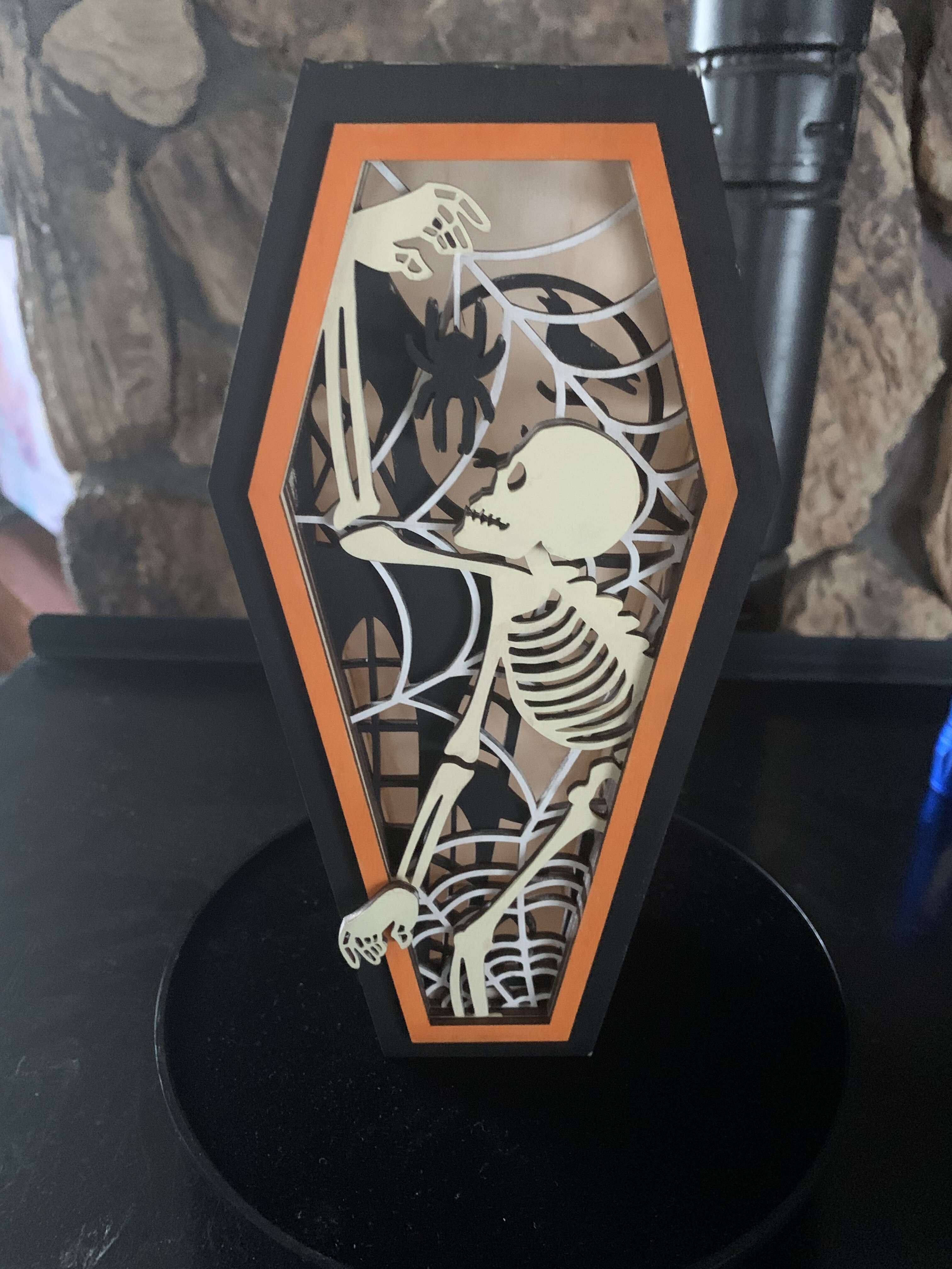

kmmcrafts Posted July 26, 2025 Posted July 26, 2025 (edited) I've been working on some lanterns for Halloween and the design has I guess you'd call finger joints.. some designs the joints are tight enough they are "friction fit" and no need for glue while others need glue to hold them together. Once I get better with the laser software I'll learn how to change those finger joint sizes to make them friction fit.. It really boils down to the exact thickness of the wood you're using and not all the same thickness from one sheet of ply to the next due to moisture content etc.. I always glue the friction fit ones anyway but they at least fit together and stay unlike some that you need 5 hands and 20 fingers to hold everything... this brings me to the quick drying glue question.. I've heard / seen the term CA Glue..I know nothing about most any glues other than the Titebond 3 and translucent ones I've been using for years. I've been using cheap dollar store super glue but each project takes close to a whole tube and would like to find a bigger better source for a quick drying glue.. Super glue seems to be holding to the wood decent enough but not sure how it will be longer term.. This is why I make this topic... what would be a good quick drying glue that isn't going to break the bank.. I did a little research last night and it looks like some CA glues require a activator? Maybe I just want to use a larger bottle of super glue.. just thought I'd ask some of the more experienced what might be my best options. Also helpful to come with a smaller tipped to get the glue into tight spots.. the little screw on tips on the super glue I've been using work pretty well, could be a tad longer but doable the way they are but that is also something I'm looking at for whatever glue I end up using. I'll load a photo of the lantern I just made shortly as it's on my phone and not on my computer that I'm currently using. LOL Edited July 26, 2025 by kmmcrafts Hudson River Rick, danny, OCtoolguy and 4 others 7 Quote

JTTHECLOCKMAN Posted July 27, 2025 Posted July 27, 2025 Just a thought and observation over the years when seeing these type projects, you can make the exact same project without the tabs and just glue end grain to flat grain. If you are worried about strength you can do alot less tabs. It is basic box making when you break it down. kmmcrafts and OCtoolguy 2 Quote
Dan Posted July 27, 2025 Posted July 27, 2025 I agree with John, could make without those joints. I believe those are box joints. I have seen where people use both wood glue and super glue. The super glue will hold the joints together long enough for the wood glue to set up. Put a few drops of super glue on a piece and the wood glue between those. I haven't tried it but I can see it working. kmmcrafts, OCtoolguy and JTTHECLOCKMAN 3 Quote
kmmcrafts Posted July 28, 2025 Author Posted July 28, 2025 Okay after reviewing the comments and after making a couple more of these I have figured out a method that works well to assemble it using the TiteBond glue that I've always used. I do wish it set up quicker so I think I might try the Quick and Thick glue mentioned above.. IF I were scroll sawing these it'd be easy to make without having the joints but until I get better with the software to redesign this for the laser I'll be making it as is.. this isn't like changing up plans on the fly with a scroll saw.. laser is going to do what the design is on the computer. I have figured out how to adjust the joints on some of these projects to make them a tighter/ looser fit but this particular design I can't seem to figure that out with this one. LOL.. some of the designs the designer made it for the type / size plywood they have / use.. and some of it is oddball sizes from other parts of the world so learning to adjust this stuff as I go.. or at least trying too.. LOL OCtoolguy 1 Quote

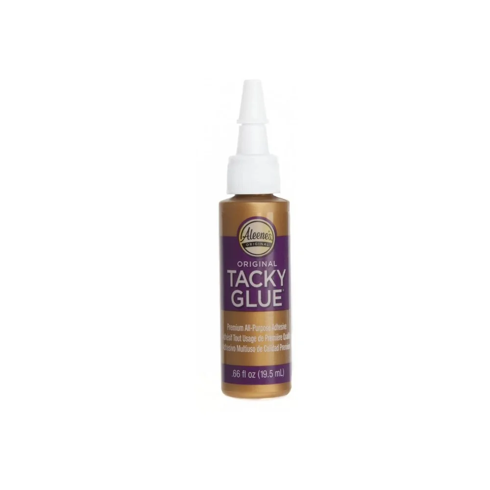

Bill WIlson Posted July 29, 2025 Posted July 29, 2025 For something in-between Titebond and CA glue for quick hold, I like to use Aleene's Tacky Glue. It isn't an instant hold. It gives you time to adjust the joint but tacks up far quicker than Titebond. kmmcrafts 1 Quote
kmmcrafts Posted July 29, 2025 Author Posted July 29, 2025 40 minutes ago, Bill WIlson said: For something in-between Titebond and CA glue for quick hold, I like to use Aleene's Tacky Glue. It isn't an instant hold. It gives you time to adjust the joint but tacks up far quicker than Titebond. Thanks Bill, My wife uses this all the time.. She is always steeling my packing tape and my side cutters so now her tacky glue is going to end up out in the shop.. Lets see how she handles the disappearing glue.. Karma about to go down, GPscroller, jerry walters, meflick and 1 other 4 Quote

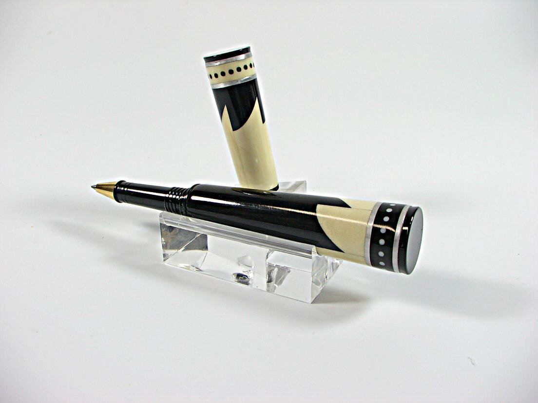

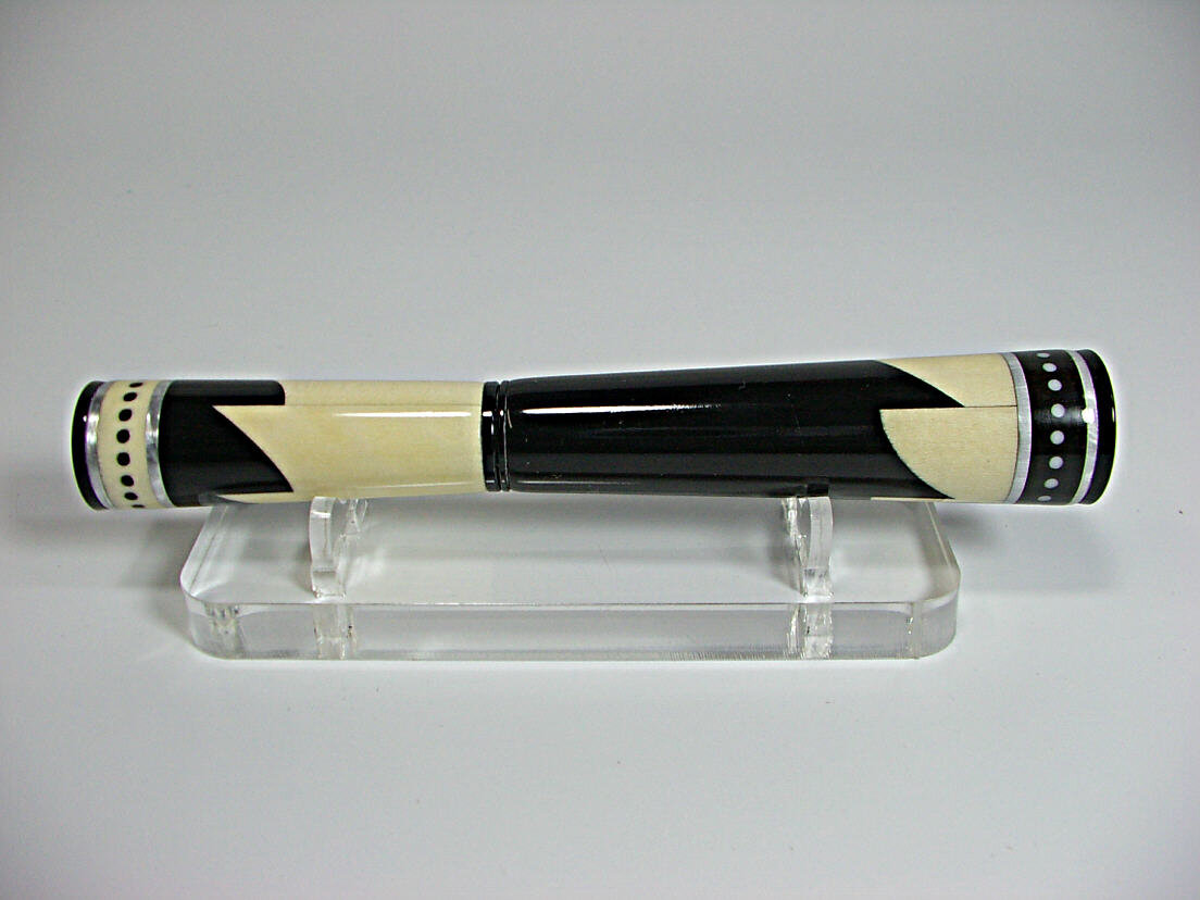

JTTHECLOCKMAN Posted August 3, 2025 Posted August 3, 2025 1 hour ago, KellisRJ said: A quick note. I used some thinset on Baltic ply last week and of course had an "oppise." A spot almost 1-1/2" across. I tried acetone and CA remover. Arggg. Of course the Danish Oil didn't penetrate. Just glad it was on the bottom and my partner didn't care. My luck, I never get anything close to the advertised set times. This provides ample opportunity to either get stuck to something or trying to prevent it waiting out the set. An acquaintance uses it as a sealant on wood carvings. The thin CA will soak into wood quickly like a sponge. It will adhere to the wood fibers and when they are covered nothing will penetrate it. Thus Danish oil will not. You can paint over it after some sanding. If you want to have some open time, I suggest Med CA. Then you can give a quick shot of accelerator to start the drying process faster. In the pen turning world we use CA all the time as a finish top coat. A few coats of thin to seal the wood and then a few coats of Med and then we sand and MicroMesh till we get a beautiful glos finish. Many will add a coat of auto wax and bring out the shine even more. It is a very tough finish and stands up to the oils in the hands and thus the reason we use a a finish. This pen I did is a segmented pen with Gabon Ebony and Holly. It is a rollerball pen. Basically a desk pen because of the size. TAIrving, KellisRJ and Dave Monk 2 1 Quote
kmmcrafts Posted August 3, 2025 Author Posted August 3, 2025 8 hours ago, KellisRJ said: @kmmcrafts I suspect you already know what I'm mentioning, but it may help others who are considering laser work. Have you tried Laserburn? I doubt there is a quick solution for changing slots width, hole width & height, etc. But there's a pretty good user community. Someone may know some tricks or Inkscape options. For those who don't know, most programs draw with dots of color. But lasers need to follow a line. Inkscape is a popular free, and can have a steep learning curve, program that draws with lines a laser can follow. If the outer dimensions are staying the same I often center a square the size I need and just start moving or adding lines, or extend it as a rectangle, cut out the bottom, then extend the pattern line to the new slot centered where the old one was. Can be slow . . . Honestly hope you are way past this point. 2D & lines I can deal with. CAD has literally driven me close to tears. Ron I hadn't thought about making a box the size I need the tabs to be and then cutting and erase the old.. It would be a slow way of doing it but it could work. The lightburn program is what I run my lasers with which is also a drawing software. Love it and it's much easier to work with than inkscape.. Same goes for my Vcarve program for the CNC router.. It's just trying to learn 2-3 different programs all at or near the same time.. and figuring out what dose what. LOL For your info or anyone else following this... there is a free website program to create boxes with or without tabs etc.. you put in the sizes and material size etc.. then it'll create a box for you to download. Check out the link below.. https://www.makercase.com/ Quote
KellisRJ Posted August 3, 2025 Posted August 3, 2025 Thanks, beautiful pen! I've been alternating, but am taking this lesson to heart. Didn't help I didn't pay close enough attention to the bottle I grabbed. Nozzle hole is much too big but Star doesn't sell replacements. JTTHECLOCKMAN 1 Quote
