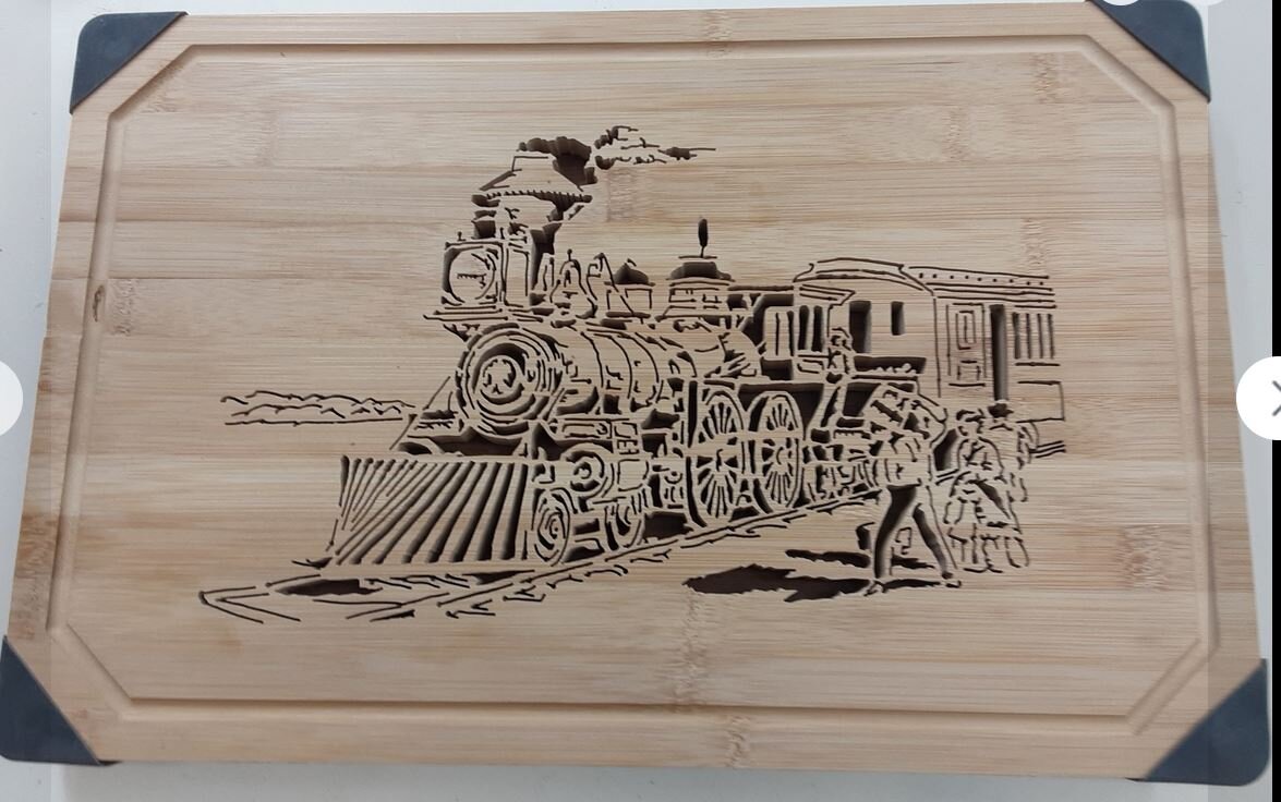

Popular Post heppnerguy Posted October 5, 2025 Popular Post Posted October 5, 2025 (edited) I was so enthralled when I saw another pattern designed by Kris Martinson that I had to give it a try. His patterns are always so interesting as well as filled with challenges. With this particular pattern I knew I could not get it perfect but I knew I really wanted to give it a try. So first of all, my apologizes go out to Kris do to the fact that I do not have all the skills needed to get it perfect, but I was able to finish it and I am happy with how it came out. I cut this on a 1/2 inch bamboo cutting board I purchased on line, using #3 Pegas spiral blades. It took my about 3 evenings to cut it. My thanks go out to Kris Martinson for the use of his great pattern. Dick heppnerguy Edited October 6, 2025 by heppnerguy had 2 photos posted by mistake JackJones, Aaron K5ATG, jerry walters and 19 others 16 6 Quote
Kris Martinson Posted October 5, 2025 Posted October 5, 2025 Looks like a beautiful cutting to me. Thank you for posting this. heppnerguy 1 Quote
FrankEV Posted October 5, 2025 Posted October 5, 2025 Nicely done. The Bamboo cutting board was a good choice. heppnerguy, danny and Kris Martinson 3 Quote
Denny Knappen Posted October 6, 2025 Posted October 6, 2025 Mighty fine cutting. How do you like the Pegas #3 spiral blades? heppnerguy 1 Quote

heppnerguy Posted October 6, 2025 Author Posted October 6, 2025 1 hour ago, Denny Knappen said: Mighty fine cutting. How do you like the Pegas #3 spiral blades? First of all, thank you for the nice comment on my project. As far as the #3 Pegas spiral blades goes, I really enjoy cutting with them a lot. I have found that I tend to have a lot of breakage with the #1 spirals, especially if I am cutting a large pattern with a lot of fine and small cuts. Because the entry hole is so small I tend to get the blades bent trying to put them into the holes and it causes the blades to get a bend in them. This, of course, causes premature braking of the blade. Using a #3 bade I reduce the amount of early breakage, as they are much stronger than the #1 spiral. So if I am able to use the #3 spiral, I prefer to do so. Dick heppnerguy Quote
Denny Knappen Posted October 6, 2025 Posted October 6, 2025 2 hours ago, heppnerguy said: First of all, thank you for the nice comment on my project. As far as the #3 Pegas spiral blades goes, I really enjoy cutting with them a lot. I have found that I tend to have a lot of breakage with the #1 spirals, especially if I am cutting a large pattern with a lot of fine and small cuts. Because the entry hole is so small I tend to get the blades bent trying to put them into the holes and it causes the blades to get a bend in them. This, of course, causes premature braking of the blade. Using a #3 bade I reduce the amount of early breakage, as they are much stronger than the #1 spiral. So if I am able to use the #3 spiral, I prefer to do so. Dick heppnerguy Just to let you know, there is a #2 Spiral sized between #1 and #3. heppnerguy 1 Quote

preprius Posted October 7, 2025 Posted October 7, 2025 The train came out wonderful. This pattern focuses on the train which in this case is great. Just a little smoke and shadows of the people add realism. All this allows the scrollsaw cutter to worry about mistakes. But the viewer has no info about pattern. Now about the boards... I have 3 bamboo cutting boards that I can play with. Thanks for bringing that up. This also got me thinking about going to good will and getting wooden tv trays to do inlay. Great work. heppnerguy 1 Quote
