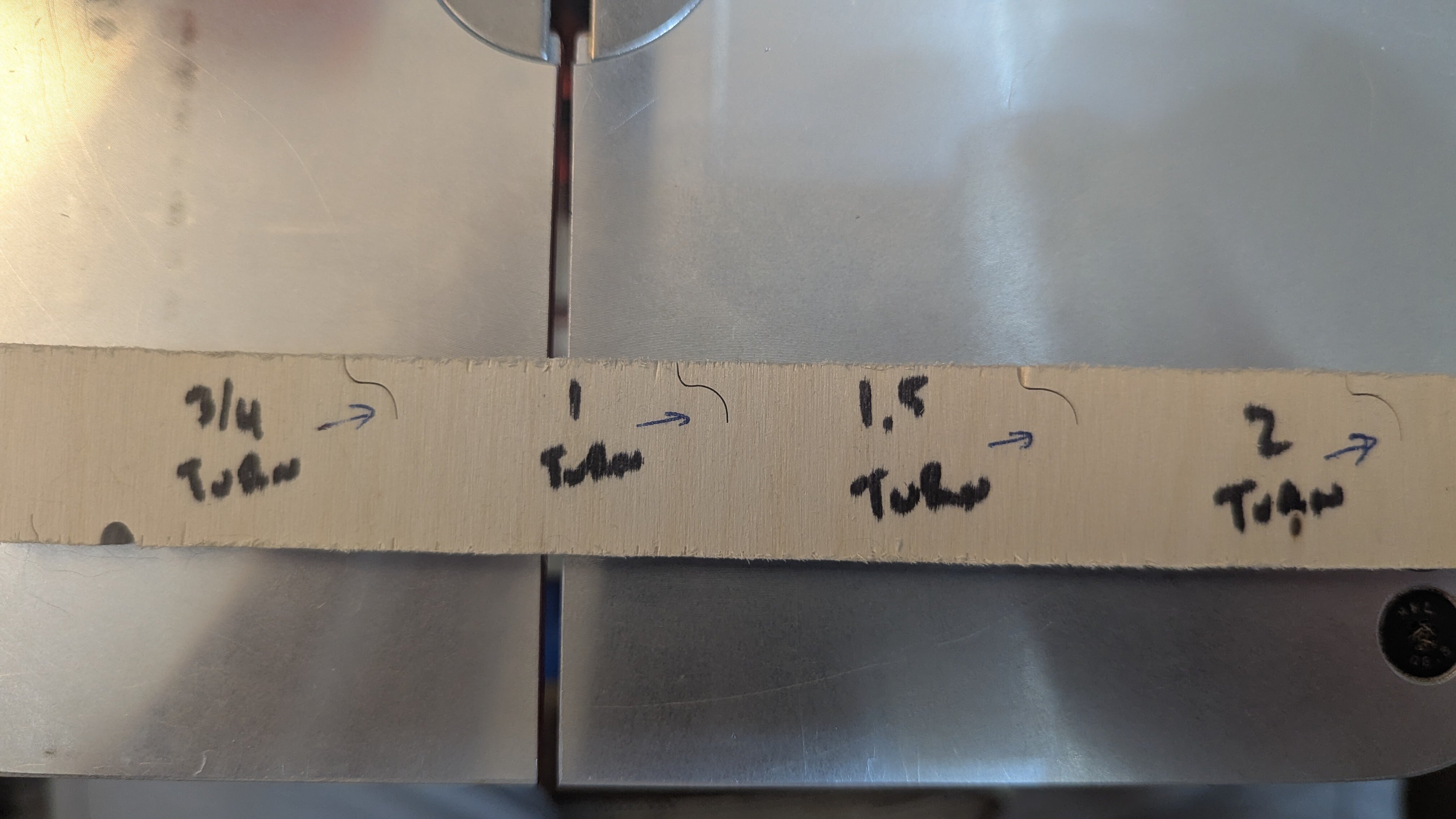

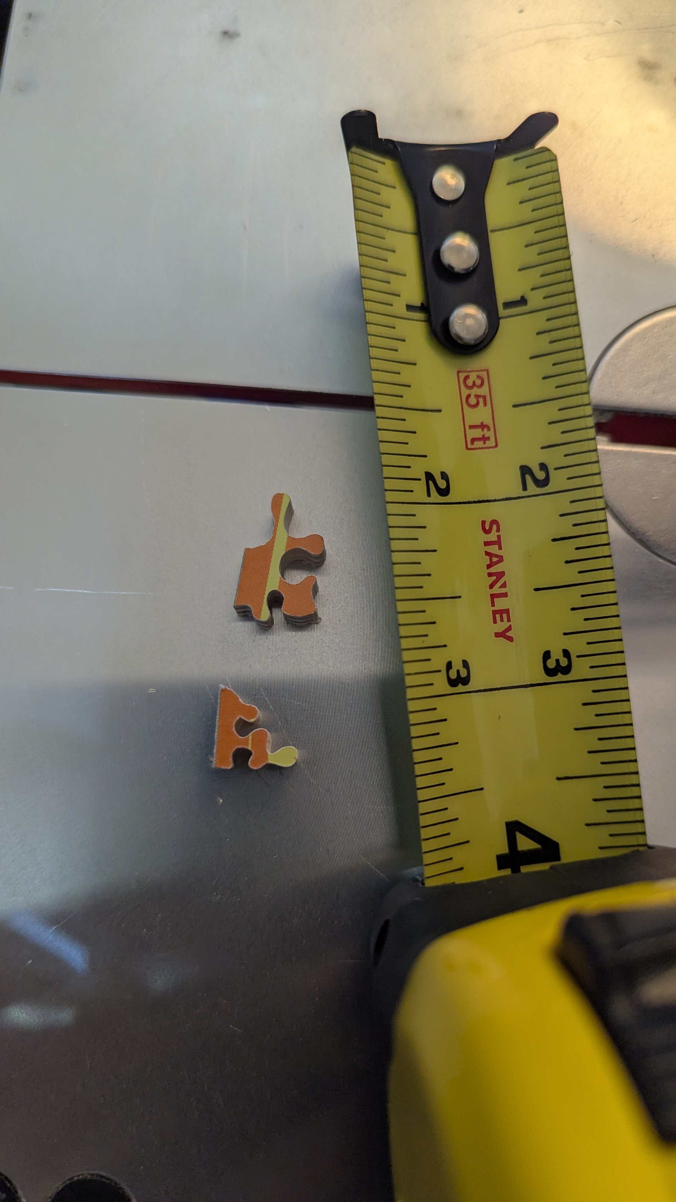

You can see in the picture in the attached image with the measuring tape that there's a top piece with a really big radius in the cut.  Then the same piece got a lot smaller radius in the cuts.  Is that just bad technique?  Or is it easier to cut when turning counter clockwise because the left side of the blade is sharper for some reason?  Is it okay when the blade is bending 45 degrees?
Is there a general rule on the minimum radius for a cut vs the width of the blade or wood hardness/thickness?  Am I simply cutting my pieces smaller than I should?
I've read the thread about 5 and 10 reasons for broken blades...for the life of me, I can't seem to tell if the tension is too tight...hard to tell.  I'm using a Hegner scroll saw and I'm adjusting the tension with the knob in the back...any clue if 2 complete turns is too much or too little?
I'm cutting at 900-1100 SPM...the blade kept breaking when I was running it much faster than that.  Does the saw speed impact how tight of a turn I can make?

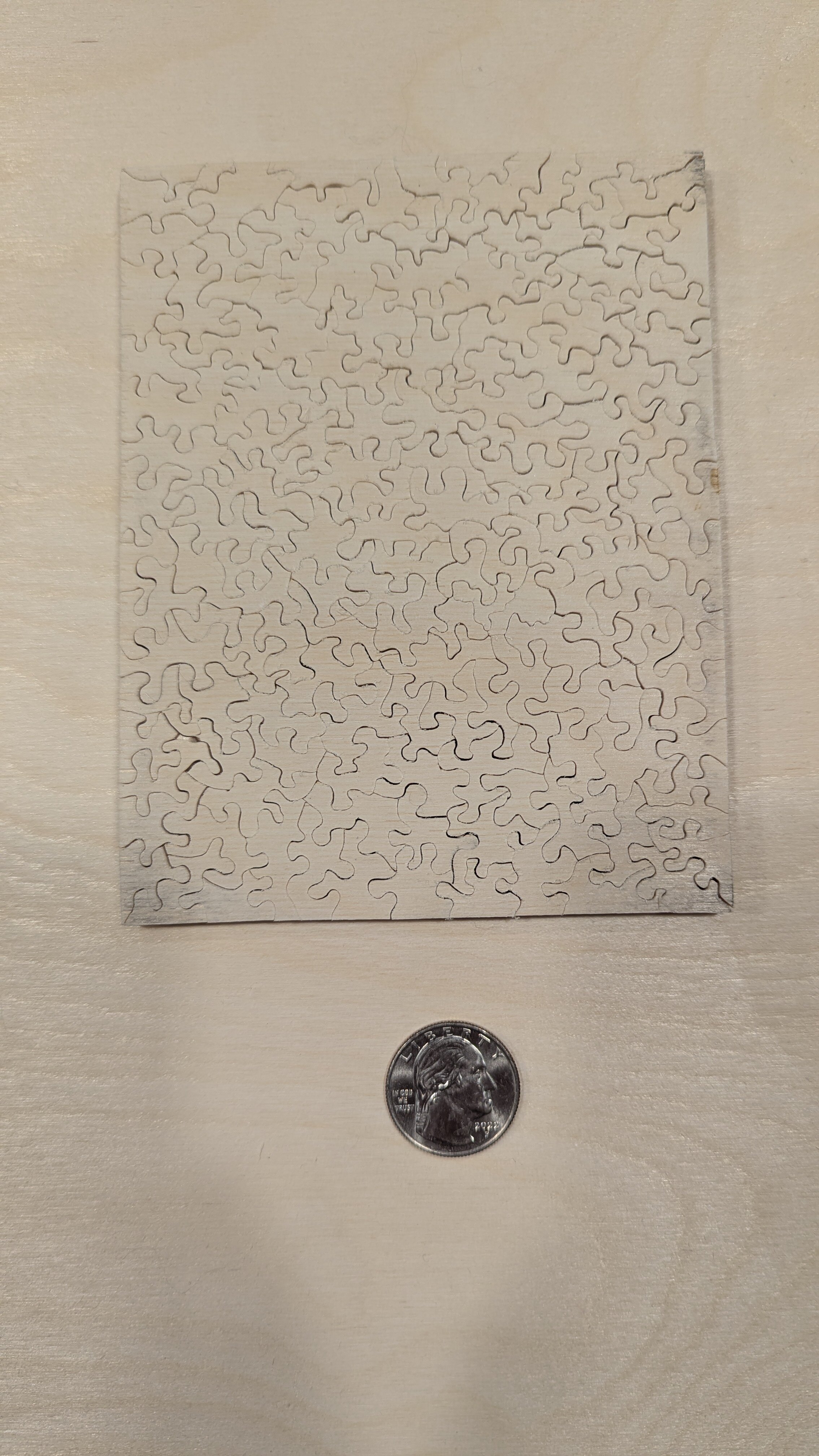

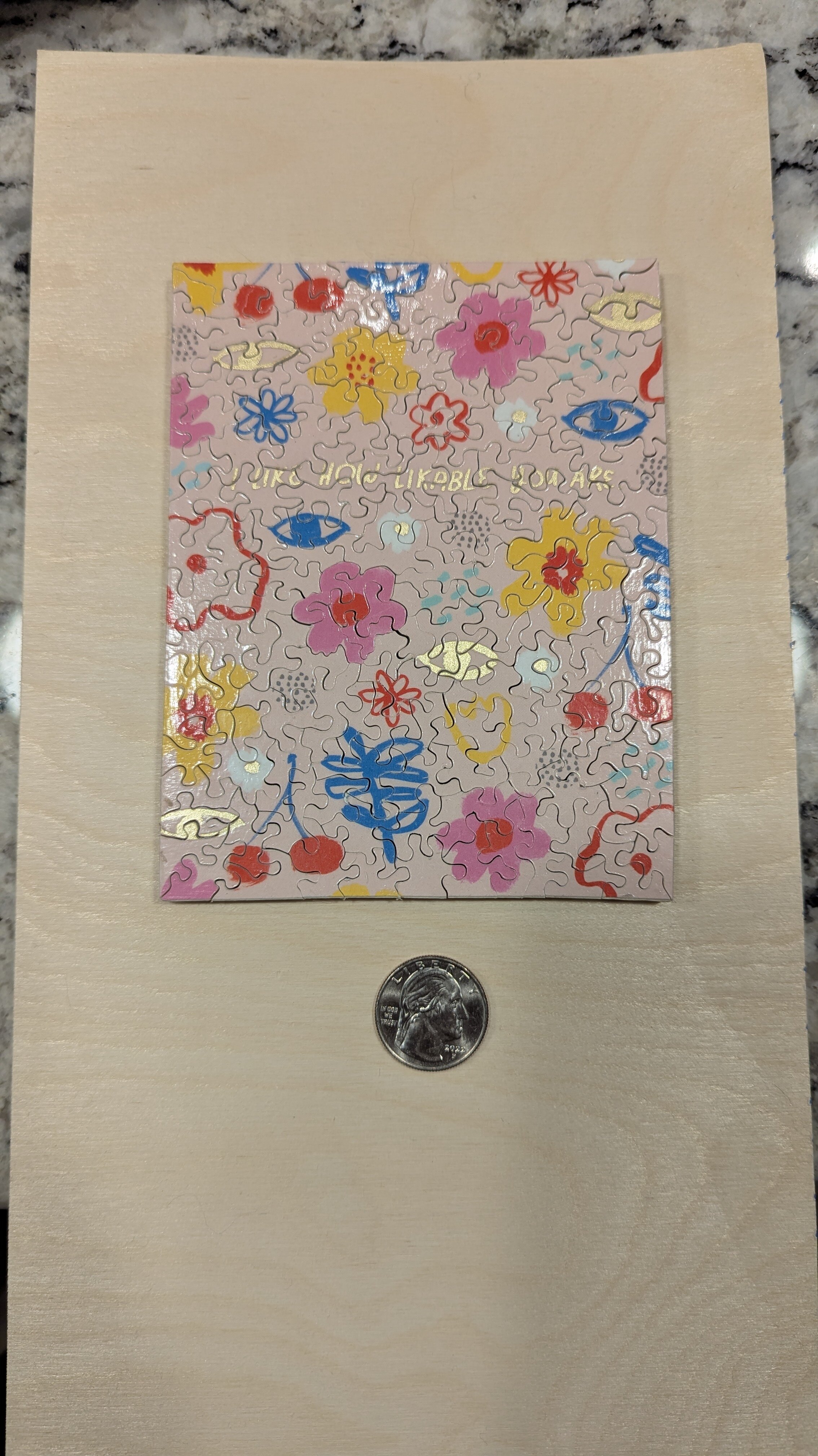

Also attached is the first puzzle I cut.  The cuts are kind of random...wasn't following any lines or curves...just cut it as I felt like it at the moment.  Appreciate any feedback / critique on the work and how to improve.  Thanks!

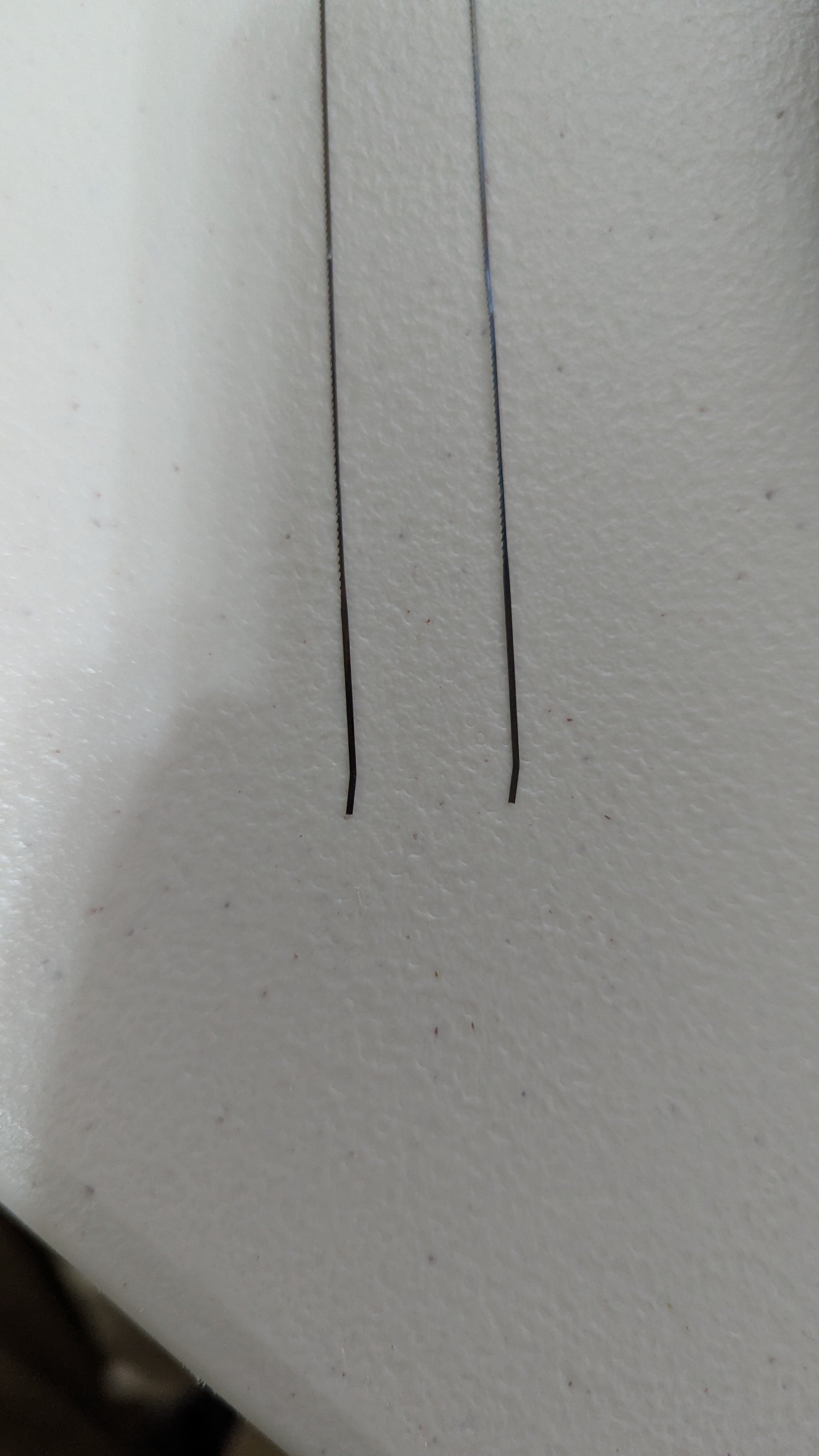

The curve you picture on the blade, is that the top or bottom of the blade?  If it is the top. when you put the blade in the top clamp insert it until it stops then pull it back a fraction of an inch, just a little, then clamp it.  The stop is the end of the blade hitting the bolt that goes through the clamp. Pull it back just enough so it does not touch that bolt.  Tightening the clamp with the end of the blade touching that bolt can cause a hockey stick bend like that.

It's the bottom of the blade.
I will try 6/4 of a turn.  At first, I wasn't keeping track and wasn't re-tensioning it after every time I put on a new blade...then when I started doing that and realize there's some variation on how much tension there is when I install a new blade...is that because I'm not consistent in the length of blade that's getting clamped?

Gordon re blade tip bent like hockey stick - caused by the blade not being centered in the bottom clamp. Place the blade into the bottom clamp until it hits the clamping screw, back the blade away from the screw just a hair and tighten the screw , in this way when you tighten the screw it does not touch the blade and cause it to move.   Make sure the blade is lined up with the pointed tip of the clamp, this is most important.

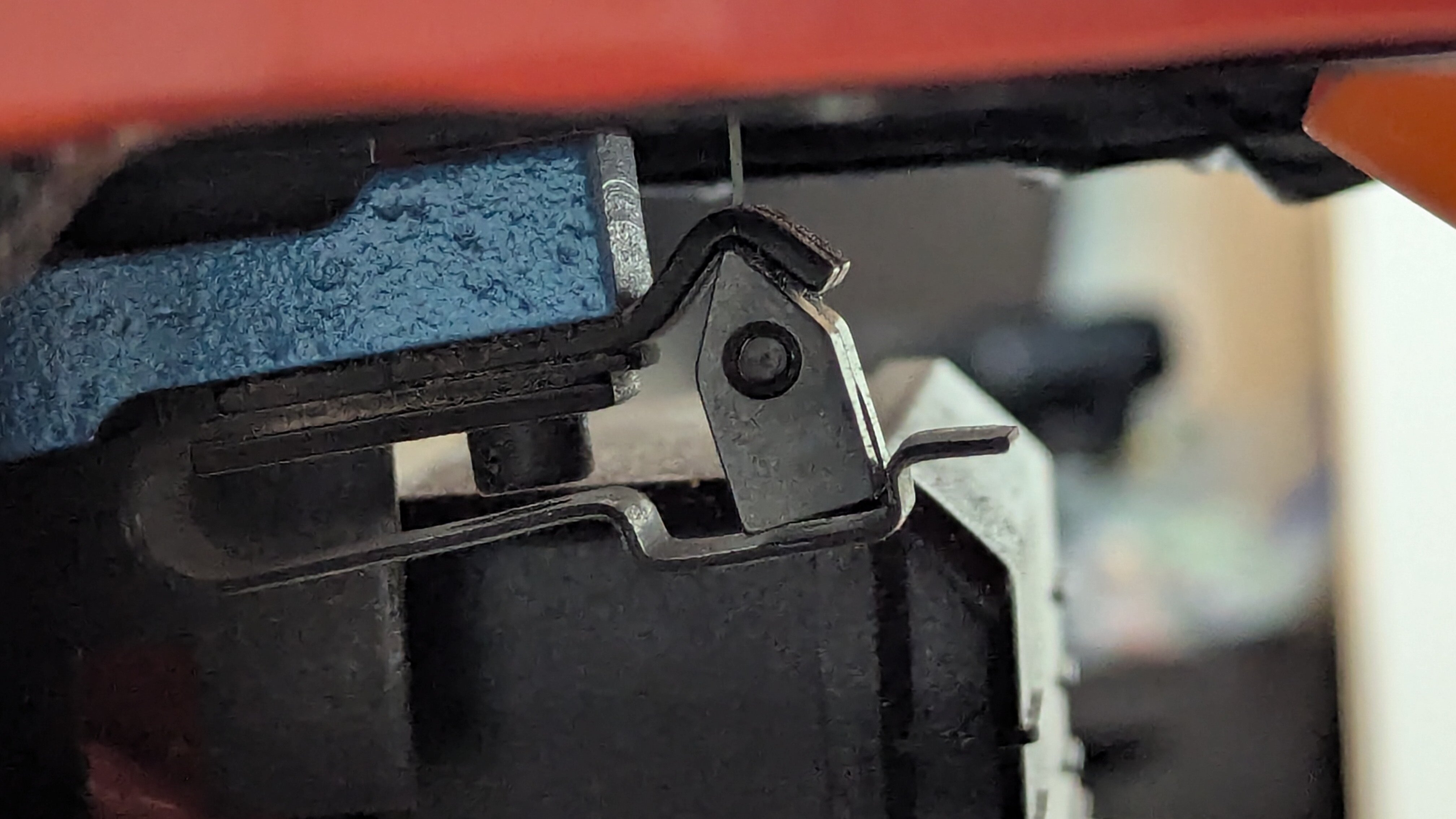

Okay it's been a couple of week since I've had significant amount of time with the saw.  I've played with different tension settings on the Hegner saw.  Below is a picture of the bottom blade holder:
The picture isn't completely leveled but you can see the blade holder is tilted one direction.  I realize that happens more when I have more than 1 turn of tension.  The strange thing is it's not always tilting.  And whenever I see it's tilting, I try to push it back to being straight but after cutting for a little bit, I'd check and the holder is tilted again.  When I see that, the blade ALWAYS looks like a hockey stick at the end.

Gordon, I do not think that matters; the clamps on a Hegner do not sit solid in the holder, they "Float".  Even the top clamp should not be tight in the holder unless you are using the Quickclamp;  it is suppose to be tight in the clamp holder.  If you watch the video on the Advance Machinery site, it shows you snapping the lower clamp in. There is nothing to hold it in place tightly. The top clamp goes in, the knob is screwed down to it, and then backed off a little so the clamp is not held tightly.  Again the exception to this it the Quickclamp, it is held tight in the clamp holder.
It also appears that the blade is in the clamp not quite perpendicular to the clamp.  If it is perpendicular the clamp should sit straighter in the clamp.

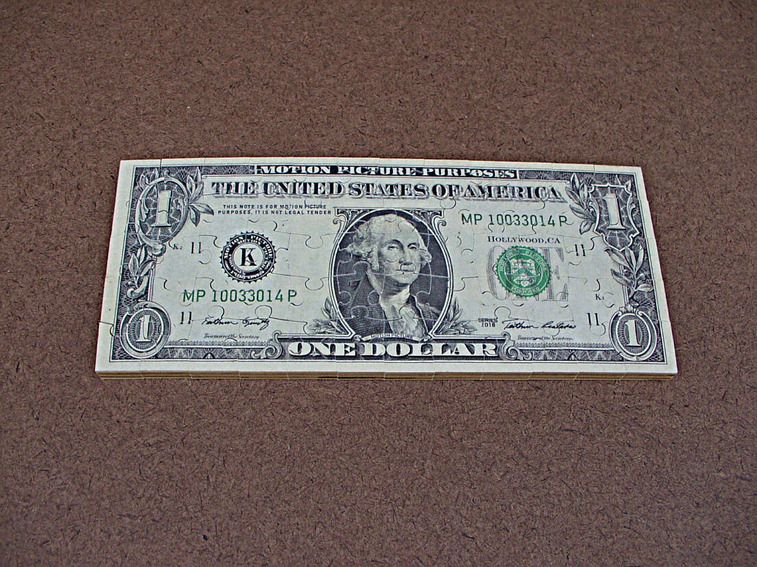

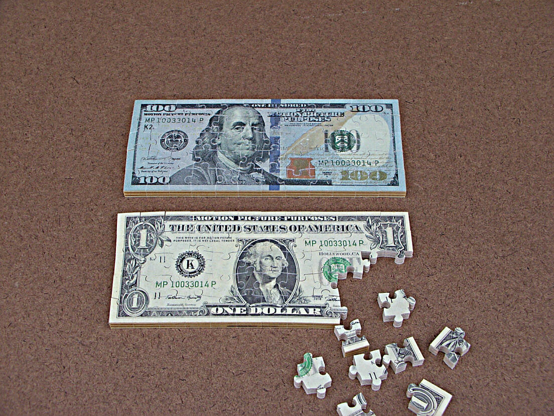

Here are some examples of my use of the FD puzzle blades. I will say it took me a few tries to get the feel of the cuts but after that it goes smooth. I use an RBI 20" saw.

Why are you sanding the blade? That will always dull a blade. If you are sanding the backside corner edges to make them smoother for turning purposes then use a sanding board. Some people use a fingernail file sander or these. They come in all type styles but it is a stick with sandpaper on it. https://www.ptreeusa.com/abrasive_detail_sanding.html
If you touch the teeth in any way with sandpaper you dull the blade.
Hmm...my bad...I mis-read the message about sanding the backside corner.  I'll try that when I have time.
I ran a quick experiment to see how tight of a radius I can cut with various tension on the Hegner saw.  See below for the results:
I started at 3/4 of a turn of tension...made a cut by turning clockwise by 90 degrees then counterclockwise by 90 degrees.
Then I made cuts with higher and higher tension.  For the cuts, I tried to minimize the twist I see in the blade.  I almost never see twists in the blade when I'm turning the wood clockwise, and as you can see in the pictures, the cuts were tighter as I racketed up the tension.  But the counterclockwise turns remained about the same in terms of the radius.
Is that from bad technique?  This is using a new FD superior puzzle blade.  I tried to minimize the cuts so that the blade isn't worn down from one tension setting to the next and I used the same blade for all the cuts.
I'll try to sand the backside corner and repeat the test again.  But appreciate any feedback.  Thank you!
