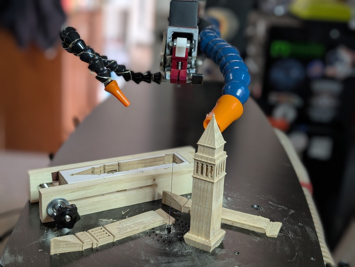

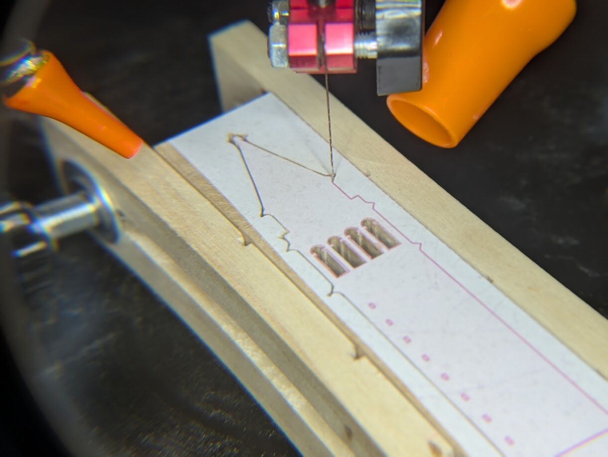

rafairchild2 Posted November 7, 2025 Posted November 7, 2025 Now this might not work well (Maybe it would) for your thicker stock as I generally cut 1.5x1.5" stock, but I made a spring tensioned jig, with tightening nuts. This way I do not have to tape after cutting the first side, pieces stay where they need to be, giving me greater accuracy. Dan, BadBob, Dennisfm56 and 4 others 6 1 Quote

Dennisfm56 Posted November 8, 2025 Author Posted November 8, 2025 Actually making one, saw the plans on Steve Good's site. OCtoolguy 1 Quote
BadBob Posted November 10, 2025 Posted November 10, 2025 I have tried several things to hold my compound cuts. So far, a pair of spring clamps works best for me. I don't use tape. The spring clamps hold everything in place. OCtoolguy 1 Quote
Scrappile Posted November 10, 2025 Posted November 10, 2025 The clamps are easily made and work well. They also give me something to hold on to and gives me better control. OCtoolguy and ChelCass 2 Quote
