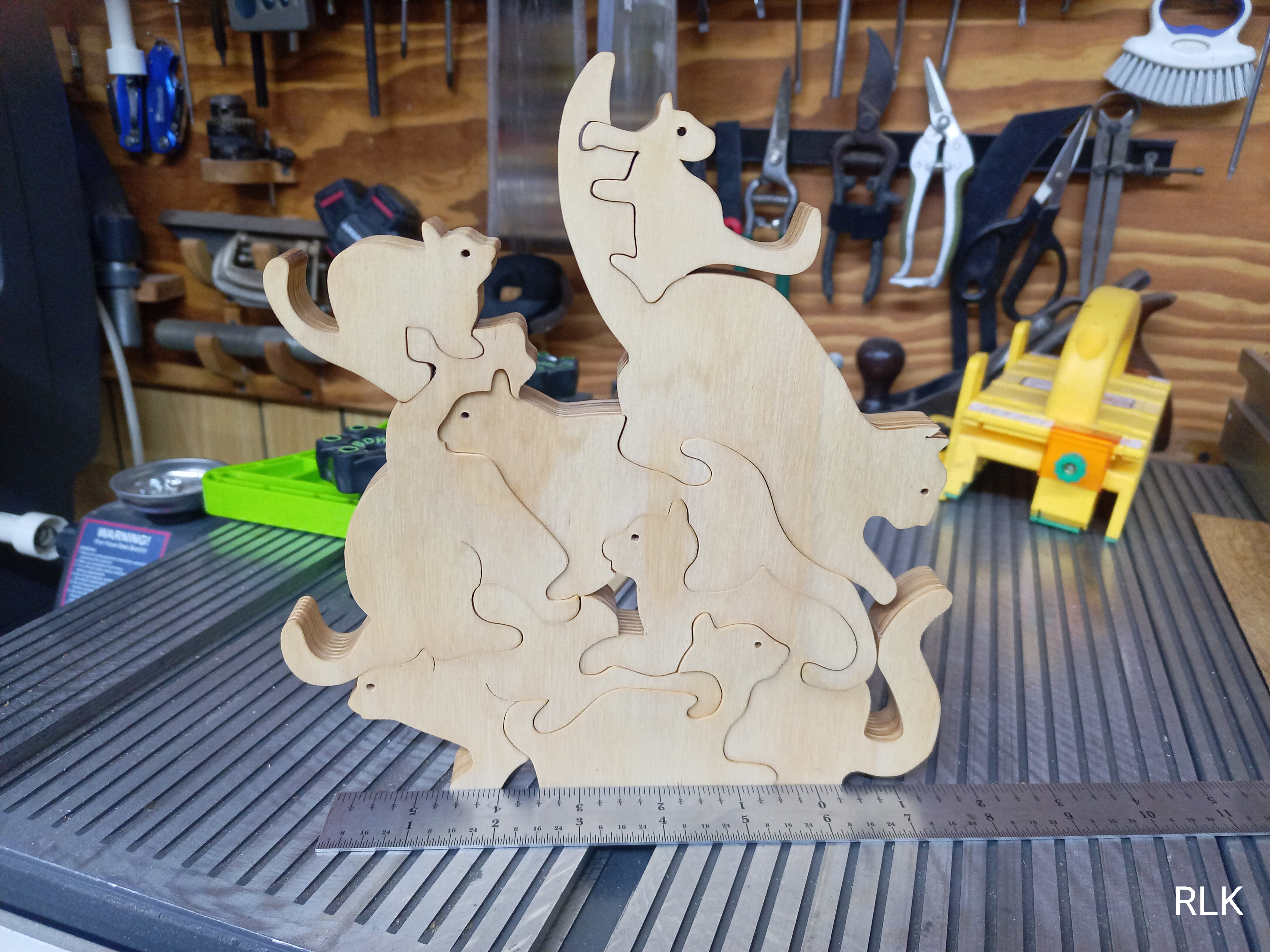

barb.j.enders Posted December 22, 2025 Posted December 22, 2025 Now I am curious to know what puzzle it was that you cut. Picture please! danny 1 Quote
BadBob Posted December 23, 2025 Author Posted December 23, 2025 On 12/22/2025 at 8:40 AM, barb.j.enders said: Now I am curious to know what puzzle it was that you cut. Picture please! Note all the narrow parts, primarily the tails. They are prone to breaking when made from solid wood. barb.j.enders, danny, Mark SW and 1 other 4 Quote

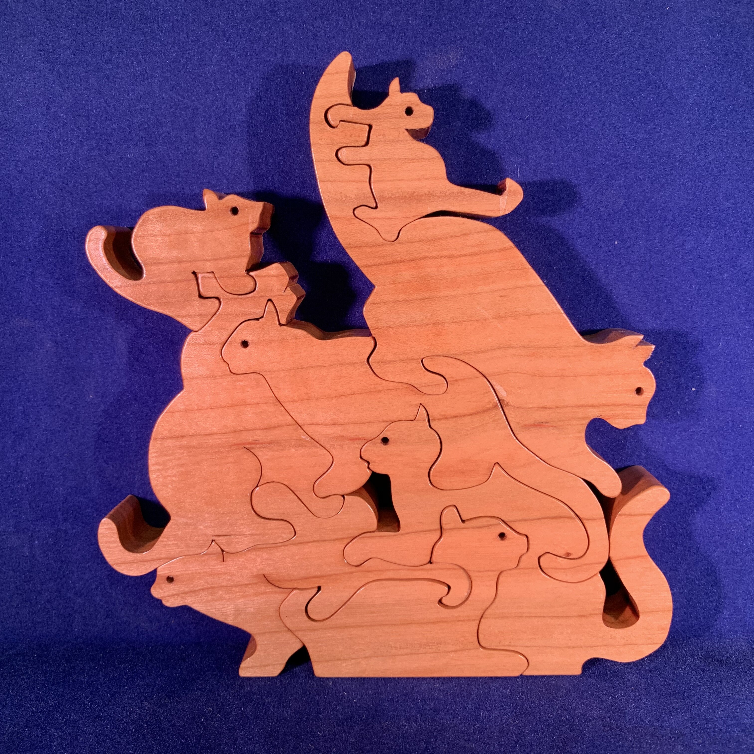

dgman Posted December 23, 2025 Posted December 23, 2025 (edited) I’ve cut that pattern out of solid Cherry and solid popular without any problem or breakage. I love the look of solid hardwoods. To me, BB looks so bland, even stained. Edited December 23, 2025 by dgman kmmcrafts, danny and barb.j.enders 3 Quote

barb.j.enders Posted December 24, 2025 Posted December 24, 2025 I cut these all the time. One of my better sellers. I have only used Poplar for it. Not had a problem with breakage. I have given a few as gifts. For those I have painted some of the cats to match cats the recipient has had. kmmcrafts and danny 2 Quote

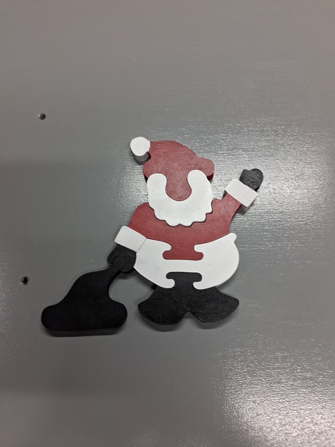

Rooterxl Posted December 26, 2025 Posted December 26, 2025 Made this one for my Grandson. 1/2 inch baltic birch. kmmcrafts, danny and Mark SW 3 Quote
