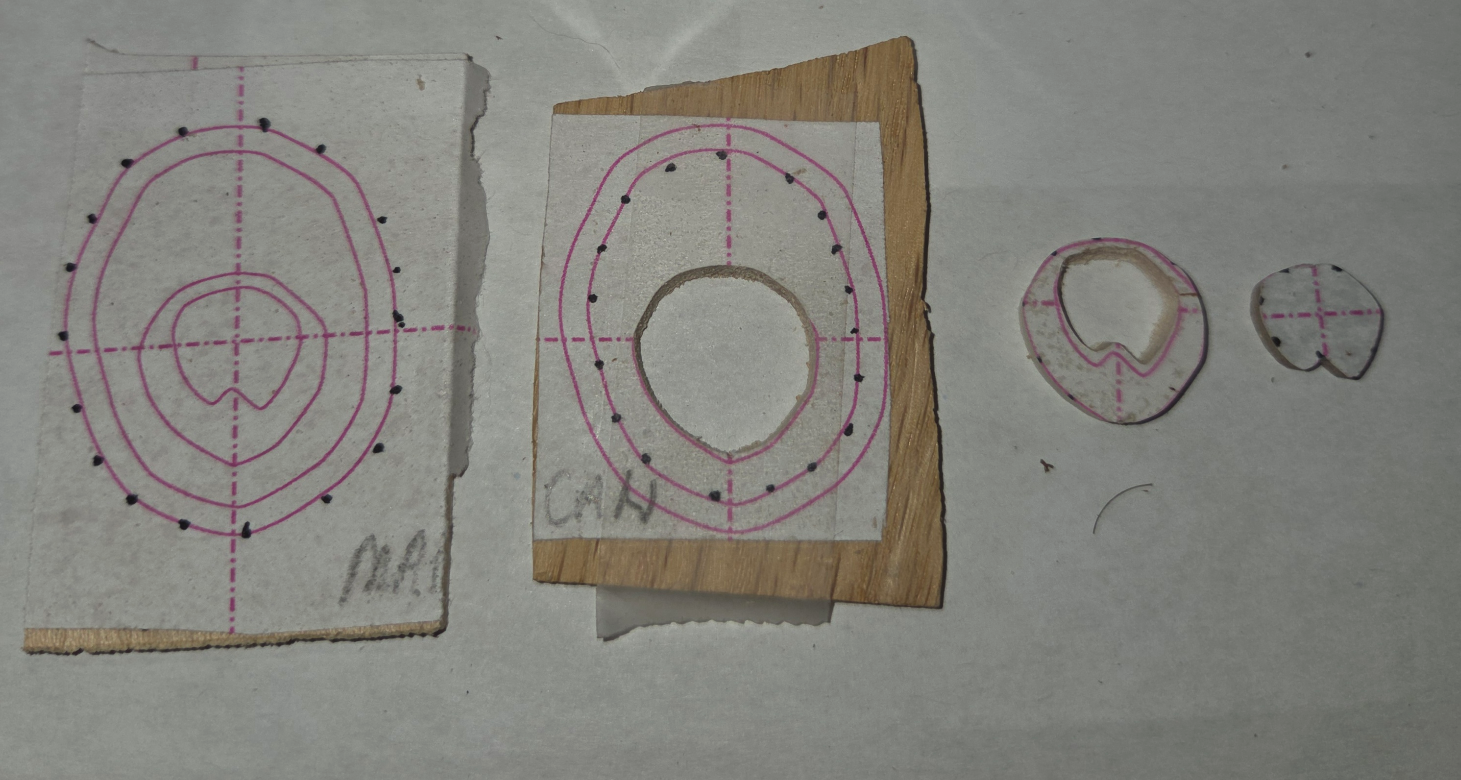

Below picture shows smallest board on top of bigger board.  Typical right,  except that I don't have to align the board edges.
The above pic shows the smallest (inside out) has already been cut and has fell down into bottom board.  The board on the left is prepared for being the next bottom board.

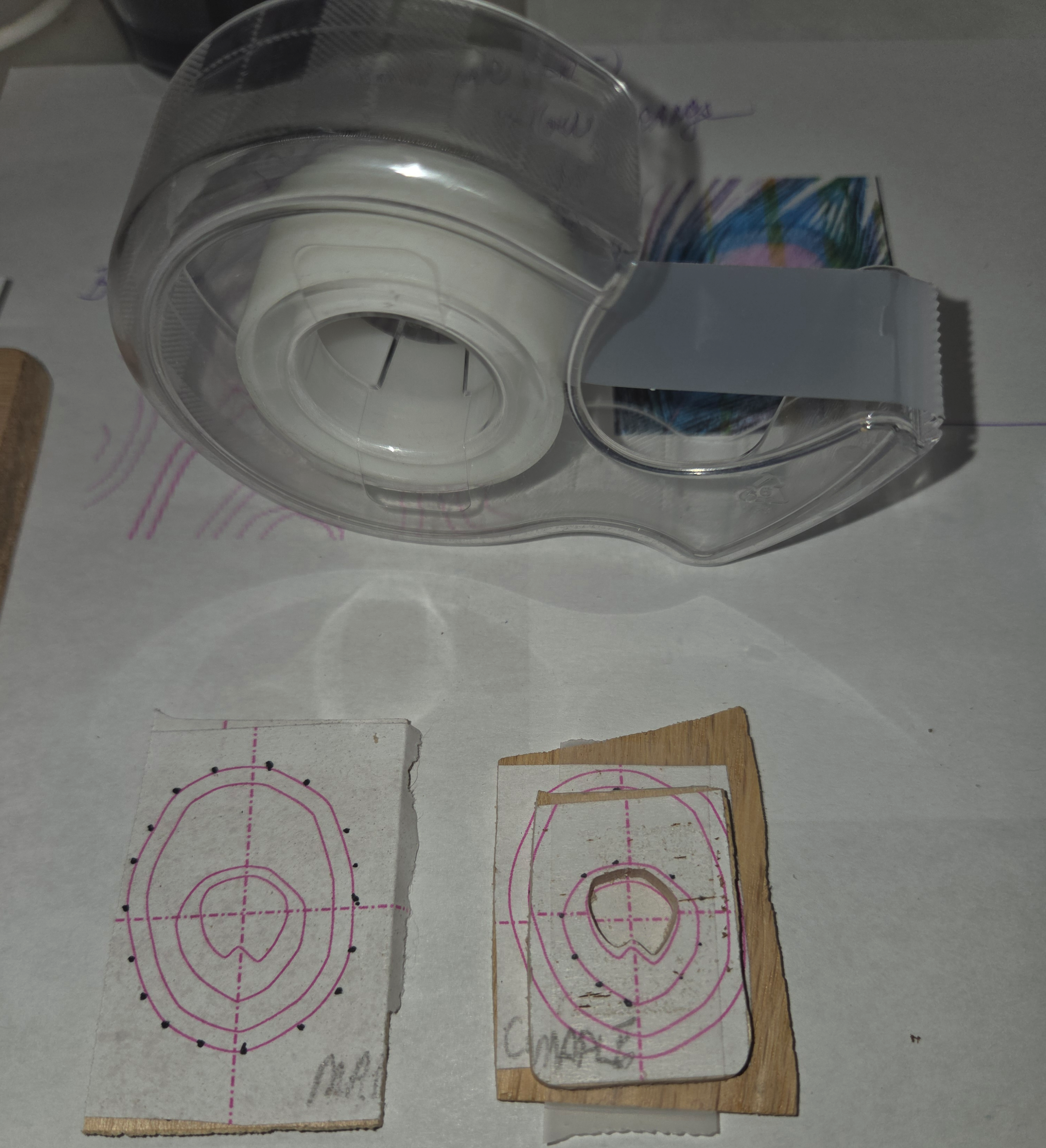

Note the black dots are to help me make sure I will be cutting the correct line.  I found that normal tape on the bottom board helps remove top board while keeping the pattern from tearing up.  All patterns are super77 spray glue directly to the wood.
The cool thing is that once the inside is cut out and removed it creates the window for alignment lines through the middle.  This allows a smaller pieces of wood to be used without aligning all the board edges.

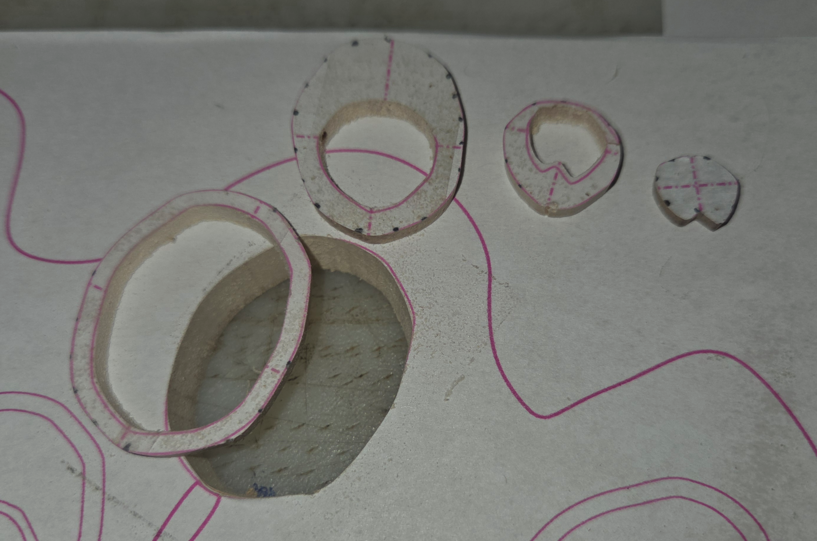

The following pic shows the separation of the above boards, and the scraps removed.
in order to get the outer layer cut I had to super77 glue the largest inlay pattern/board to the base board.

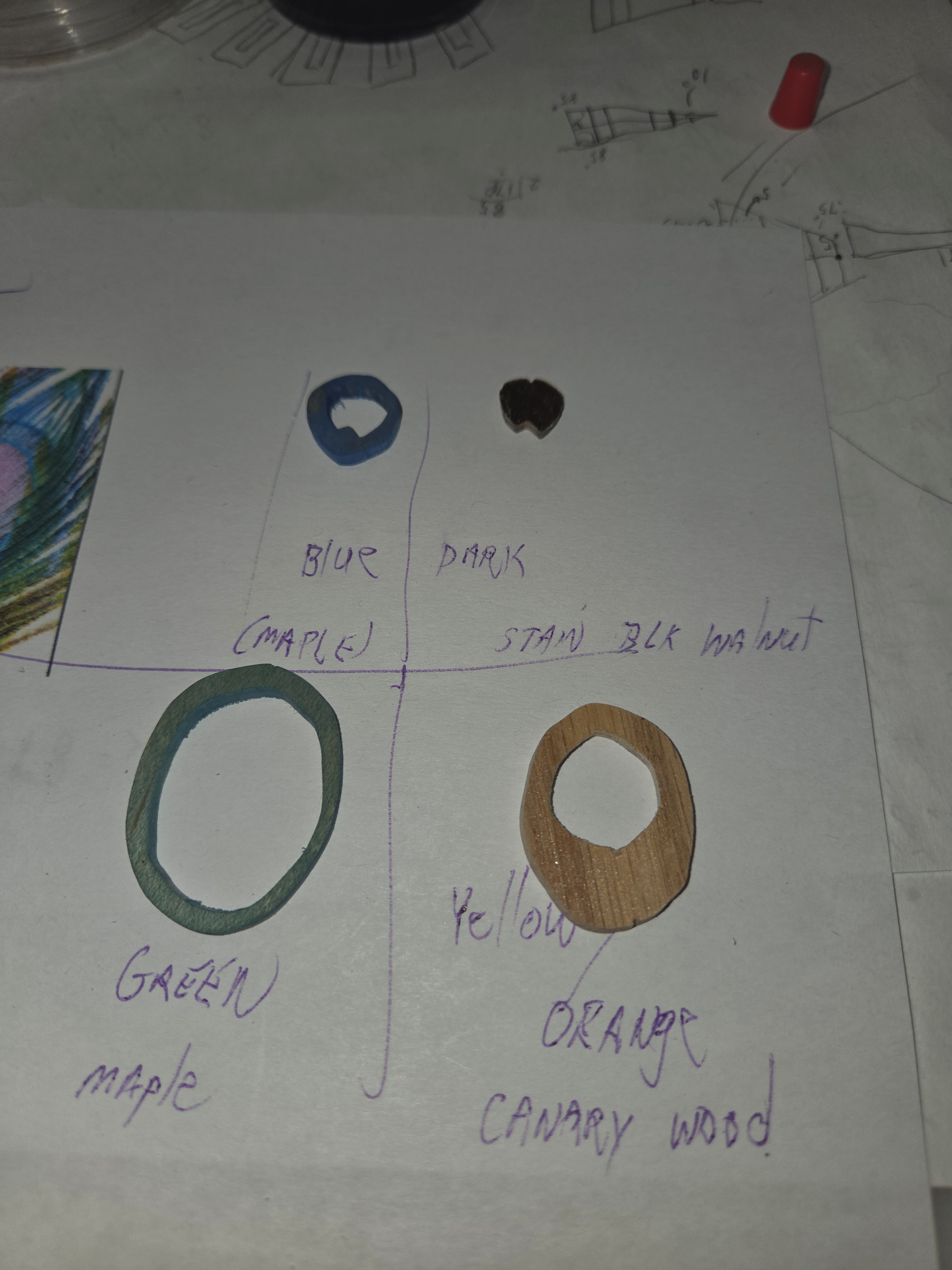

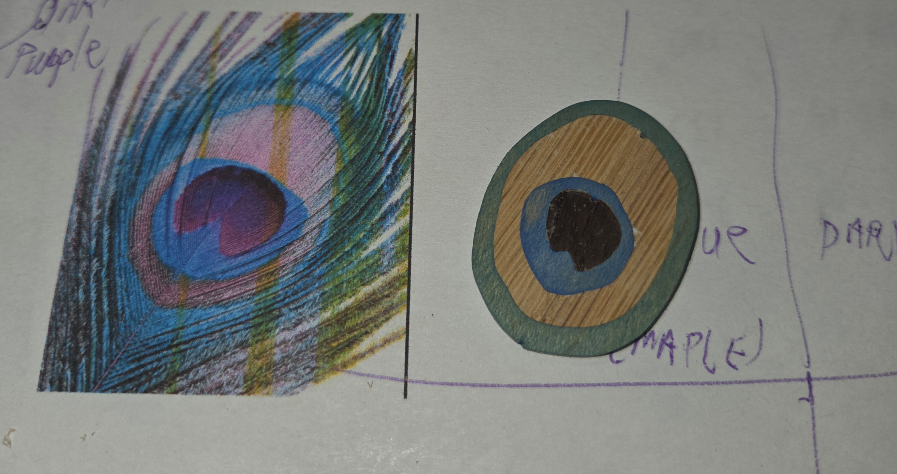

I could not glue all inlay pieces together immediately.   I had to color (dye) the maple woods to match my project.
let each piece dry and shrink so the can just easily fit together.

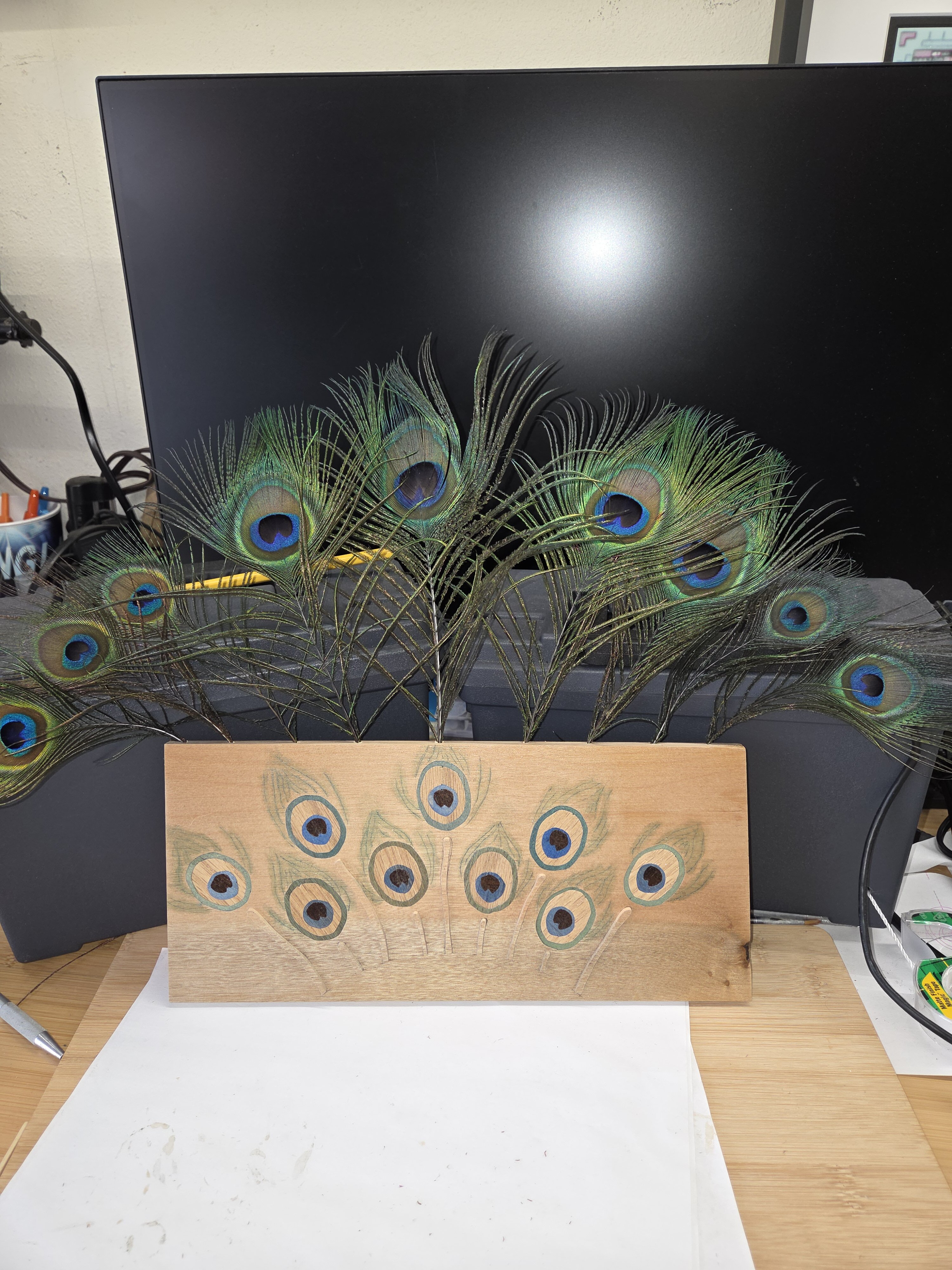

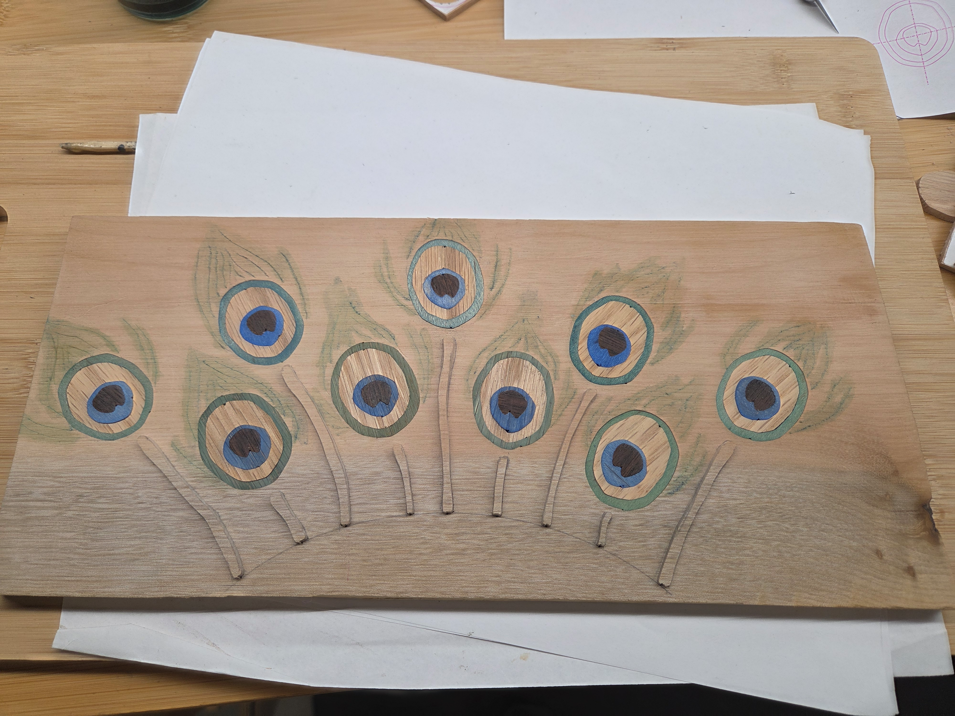

Now just to repeat all those 4 inlays 8 more times.   Perform some raised relief cuts and add some tiny scratches to be dyed green (top of feathers).  Then we have a complete project.
This base board will have holes on the top to hold real peacock feathers.

wood used:  walnut stained dark,  canarywood (plain),  2 cuts from maple (green and blue dyed),  and base board is myrtle.
