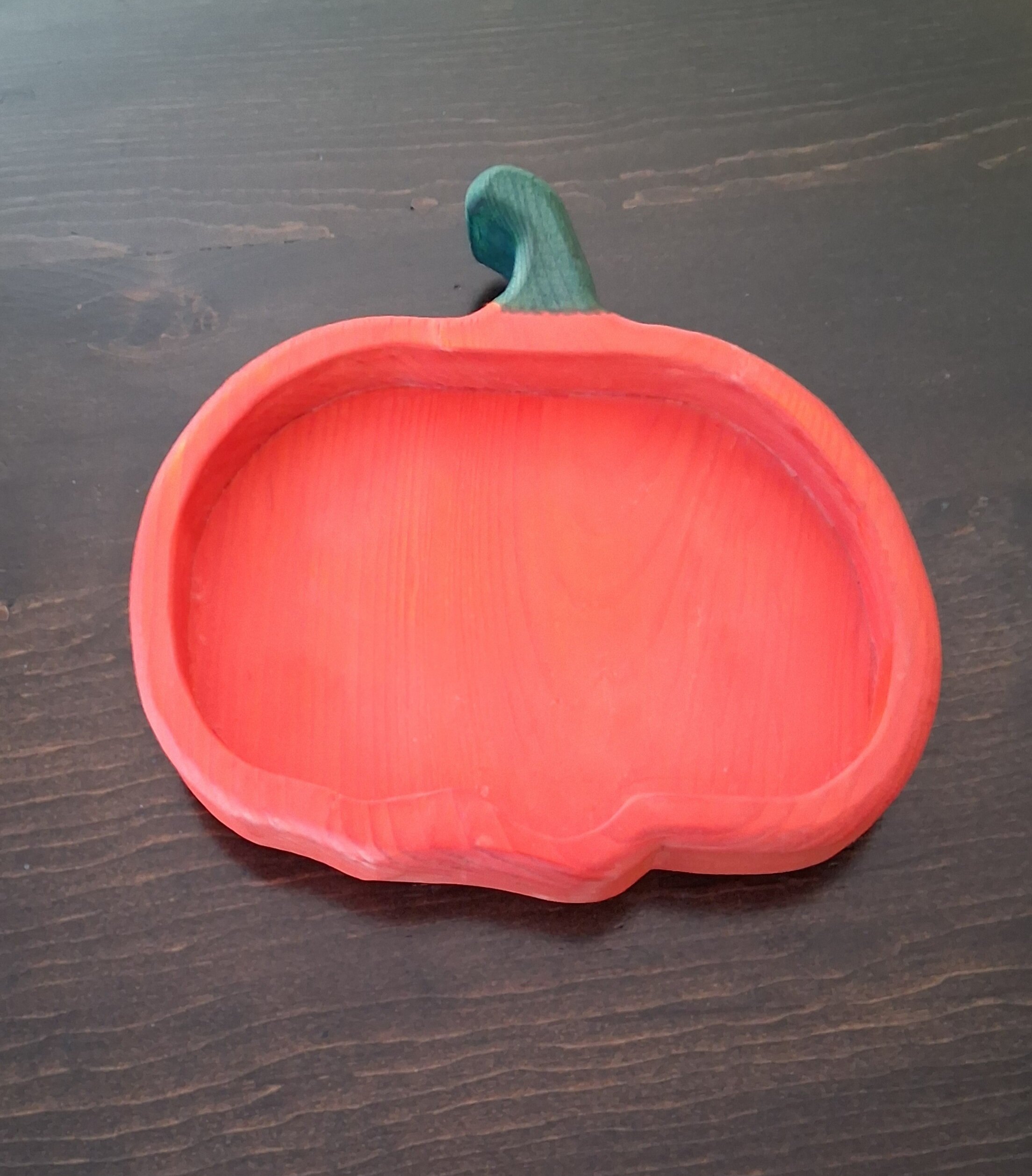

Popular Post don in brooklin on Posted September 14 Popular Post Posted September 14 Need some hostess gifts coming up and saw a lot of trays being done with CNC and router kits. I made mine with the scroll saw. Cut the inside of the top with 3/4 pine, glued on 3/8 pine and cut out side. Rounded the edges with router. Used KEDA dye for the colour. I some times can get the 10inch by 8 feet pine shelving cheap at Home depot so I figure these cost about about $2.50 CDN Horseshoe, wombatie, Dan and 9 others 12 Quote
barb.j.enders Posted September 15 Posted September 15 Well done. That would be a good project for your beginner class. Fab4 1 Quote
don in brooklin on Posted September 15 Author Posted September 15 1 hour ago, barb.j.enders said: Well done. That would be a good project for your beginner class. Good thought. My only issue is the glue up. I am going to test using both ca and wood glue to see if the time allows. I am going to do another candy dish as a Christmas tree and so I will post if it works. Thanks for the idea. barb.j.enders and Fab4 2 Quote
Denny Knappen Posted September 15 Posted September 15 That sure is a beautiful and very colorful pumpkin. You might consider CA glue with an accellerator. Quote
