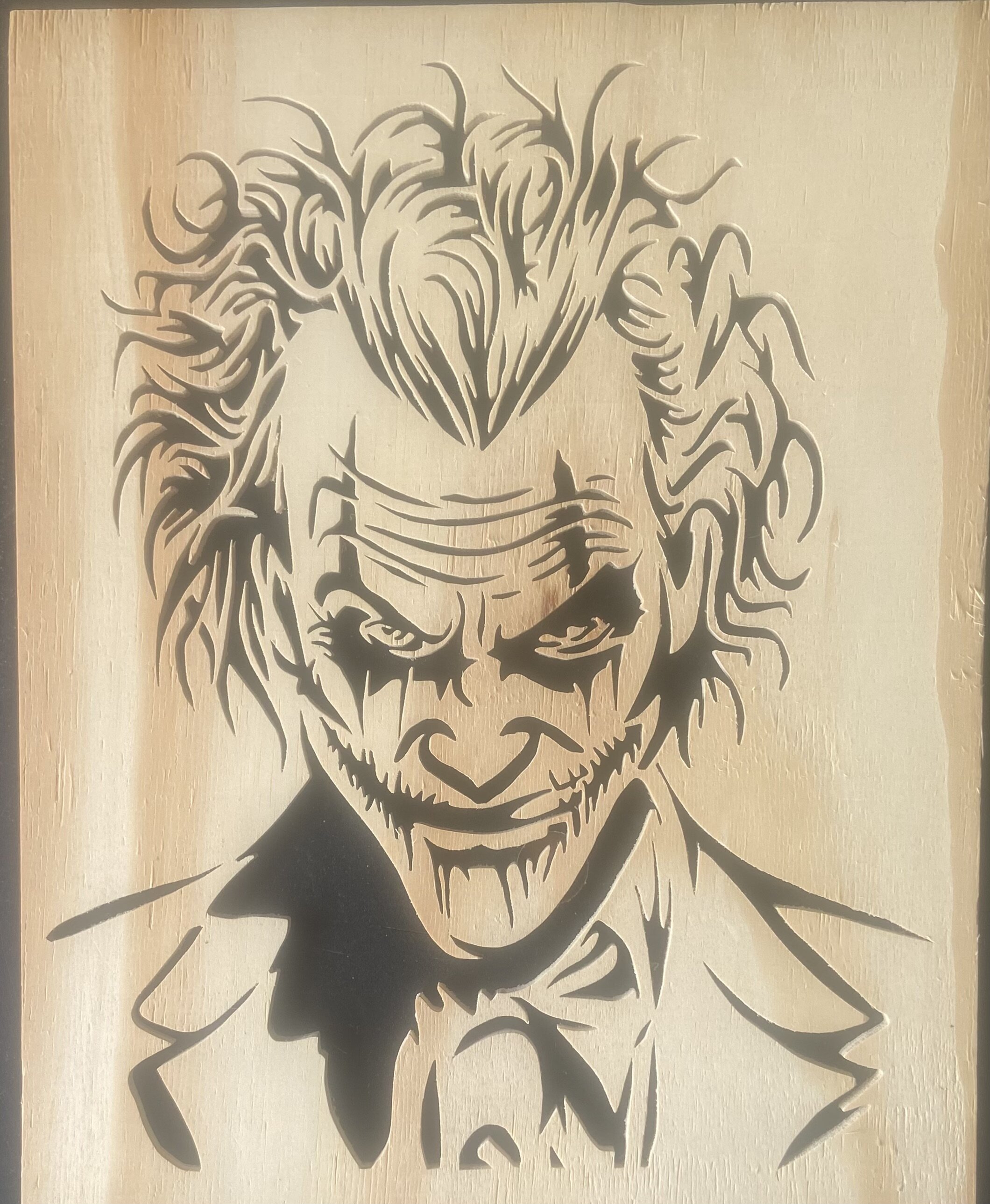

Insane Dust Maker Posted Thursday at 01:46 PM Posted Thursday at 01:46 PM Hi there, after a three month break from scrolling, I’m back in front of the scroll cutting again, I decided to do a cutting which is out of character for those who know my work, I cut the pattern on Prime Plywood Grade B/B, I just did this get the feel back again. On completion and peeling the Blue Painters Tape off there were bits of of the surface fibers pulled off with the tape which has left the surface a little rough, I will give it a sanding and see how it looks (I did not want to use my Baltic Birch Stock for this) is there away to prevent this should I cut on this Plywood again. OCtoolguy 1 Quote

Insane Dust Maker Posted yesterday at 08:03 AM Author Posted yesterday at 08:03 AM So as promised below is my practice cut after sometime away from the scroll saw, happy with cut ( forced on me by my grand daughter) but I just can’t believe how stupid I was in leaving the pattern for quite awhile which resulted in the surface being lifted when removing the tape. It was a lesson learnt but the object of the exercise was just to get the feel back, I’m one of those scrollers who keep the finger tips close to the blade, by doing this my finger tips fees the cut of the blade and I can tell when the blades starts losing its edge. So now onto some serious cutting this week. Wichman, tomsteve, Fab4 and 2 others 5 Quote
Sycamore67 Posted yesterday at 11:36 AM Posted yesterday at 11:36 AM That is a wonderful practice cut. Quote
