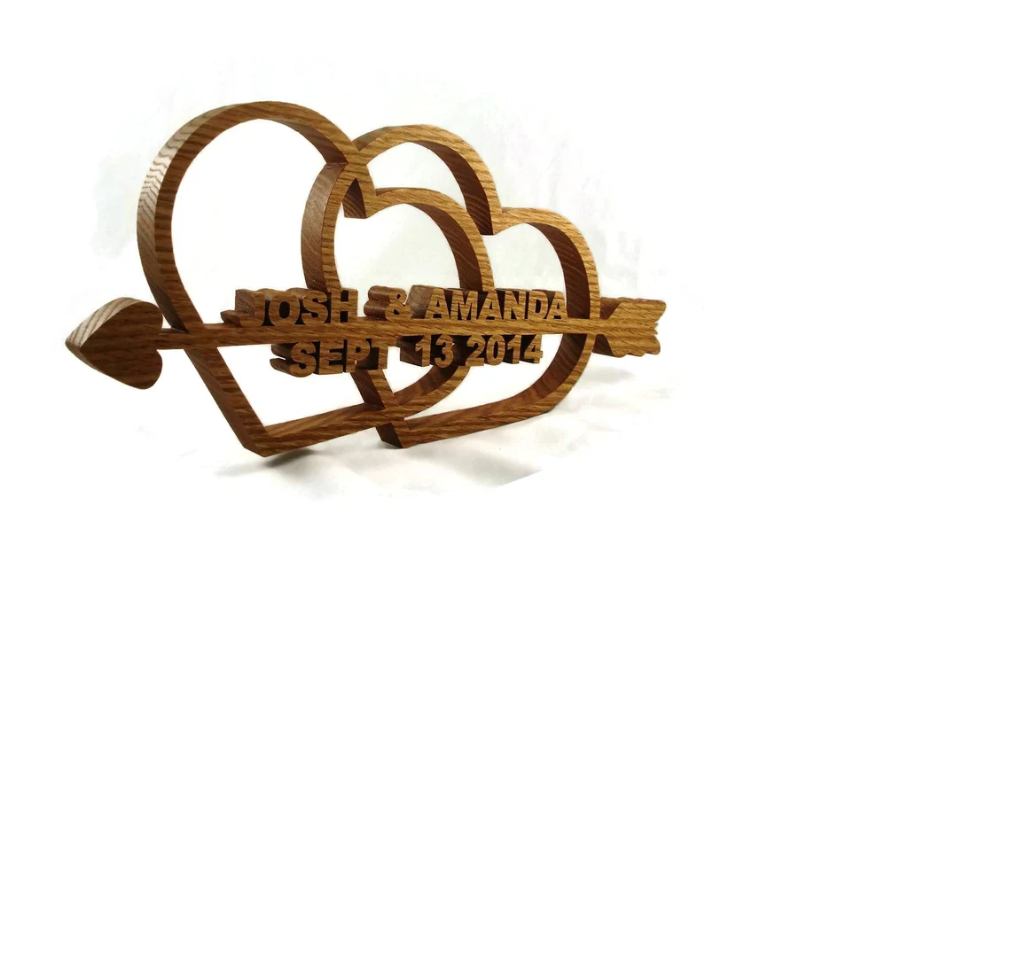

kmmcrafts Posted July 20, 2024 Report Posted July 20, 2024 There use to be someone on one of the forums back in the day that did it with a projector.. But I agree with all the points above saying it'd be very time consuming and probably inaccurate. Back in the early days i use to watch my father trace his patterns directly onto the wood with copy paper.. This was back in the late 70's probably when he first got into it.. later in the 80's I know he use to go get copies made but i'm not sure how he attached the papers etc.. I remember seeing him cutting out text from papers and taping them to other patterns when he needed a custom name.. he made a lot of these wedding heart things.. and he would tape the letters onto the pattern and then go have a copy made, LOL.. I'm so fortunate that I started the hobby in the early 2000's when I had a home printer, and editing software ChelCass, JackJones, Bo Liljeborn and 2 others 4 1 Quote
