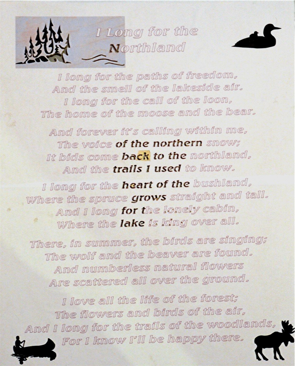

Popular Post Frank Pellow Posted September 30, 2024 Popular Post Report Posted September 30, 2024 (edited) I have been away from this forum (as well as many other computer-based activities) for a long time. I'm starting again, in a small way, with this thread. There is a poem entitled 'I Long for the Northland 'that expresses the poet's (Cpl J Romanson) love of the Boreal Forrest in Northern Ontario. I've designed a plaque to hang in a new building on Pellow's Island and that plaque features the poem. There are a lot of words (149) and this has resulted in a large pattern for me to cut. The size is 43cm x 52cm (or 17in x 2in if you prefer Imperial measurements). This large size makes the work difficult to manipulate when sawing. I tried to cut the letters using small reverse-tooth blades but, with all the tuning of the piece, this proved to be very time -consuming. So, I'm now cutting it using 2/0 Pegas spiral blades. That's going much faster but it is very risky. If I make one slip-up, I'm likely to ruin the letter that I'm working on and, probably, the whole thing - and it's very easy to go off track with a spiral blade. I must concentrate at all times. To this end, I'm limiting myself to a maximum of 10 letters each time I sit down at the saw. After I've cut the letters, I go and do something quite different for at least half an hour. So far, I have not screwed up, but I'm only about 10% done. WISH ME CONTINUED GOOD LUCK! I'm starting this thread as an added incentive for me to do a good job. I will post periodic updates on my progress, even if I do go off-track and ruin the plaque. Edited September 30, 2024 by Frank Pellow typos danny, ChelCass, Hawk and 7 others 9 1 Quote

Frank Pellow Posted October 2, 2024 Author Report Posted October 2, 2024 Update #1 I estimate that I've now completed about 20% of the sawing on this piece. Thirty-one full words and a few part words plus one image are now behind me. I'm gaining confidence (but, I hope, not over-confidence). danny, ScrollerGuy, barb.j.enders and 1 other 4 Quote

Frank Pellow Posted October 5, 2024 Author Report Posted October 5, 2024 Update #2 I estimate that I've now completed slightly more than half sawing on this piece. Seventy-five full words and a few part words plus three images are now behind me. I've even relaxed the quidelines as to the maximum number of letters I will cut during one sitting - I've upped the number from 10 to 20. meflick, GPscroller, barb.j.enders and 1 other 4 Quote
Frank Pellow Posted October 9, 2024 Author Report Posted October 9, 2024 Update #3 The sawing is complete and I did not make any mistakes. That's a BIG relief. This panel is 3mm thick Baltic Birch plywood. If I ever attempt anything like this again, I will use 6mm thick plywood because it will provide more resistance and more difficult to go off-track. I've cut bigger pieces, the biggest being 'Massey Ferguson 65' which measures 72mm x 46mm (or 28" x 18"): but when you make a mistake with a spiral blade on a scene such as this, it is usually possible to cover it up your mistake so that either will not be noticed or it looks like it was intended. Mistakes when cutting letters will be noticed. meflick, Scrappile, danny and 2 others 5 Quote
