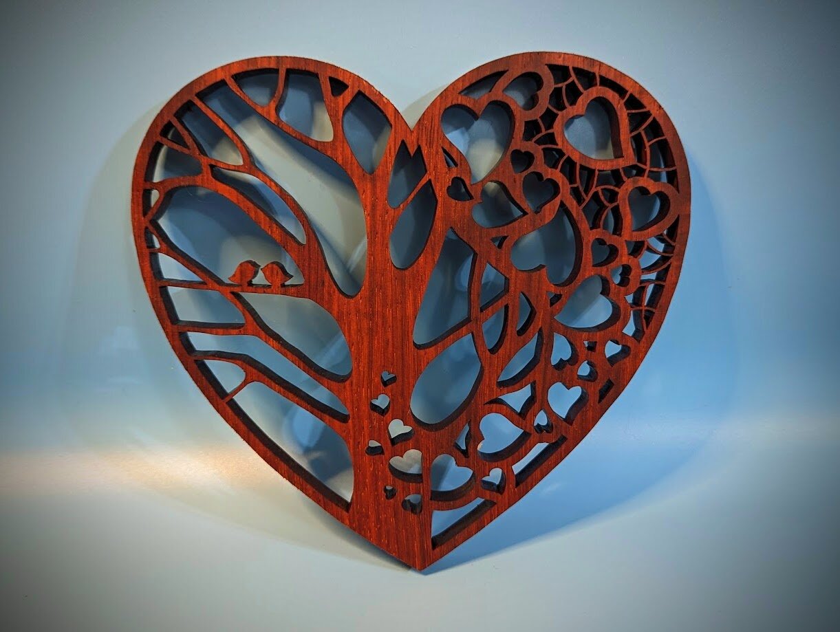

rafairchild2 Posted September 15, 2025 Posted September 15, 2025 I used FD UR and #5 is my go-to for 1/2-3/4, though depending on the Janka and if the lines are smooth and not detailed sometimes I go #7 The heart is 1/2 blood wood, really hard, I used #5 and #7 on it. Scrappile, red river, Mike Crosa and 3 others 6 Quote
