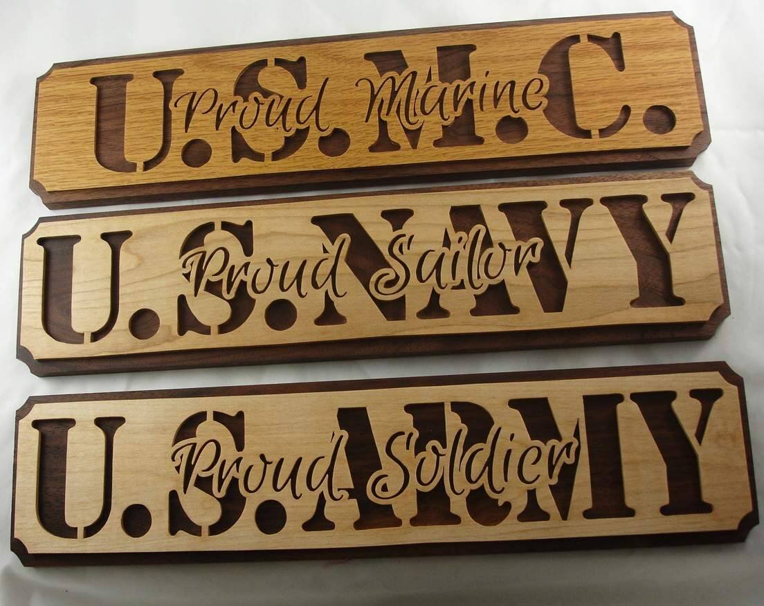

kmmcrafts Posted January 4 Posted January 4 I'm sure others would have a different method of what they would do than me but, what I would do is add a backer from a different species of wood for contrast.. many of my projects made from oak or maple would have a walnut backer.. I would glue the backer first and then apply your finish.. Linseed oil would make the grain of those two types of wood really pop.. however I prefer Danish oil as it has a small amount of poly in it with added driers to help it dry out quicker. The U.S.M.C in the picture is red oak with walnut backer. I do prefer the look of maple or birch with walnut backer better. If you do go the stained wood route I would use E6000 glue instead of wood glue as the wood glue works best on unfinished wood. OCtoolguy, ChelCass and tomsteve 2 1 Quote

rjweb Posted January 4 Posted January 4 Paul, once a marine, always a marine, RJ Scrappile, ChelCass and kmmcrafts 3 Quote
ChelCass Posted January 4 Posted January 4 Ok, Now I am going to have to go on the hunt for the Marine sign pattern for hubby. lol kmmcrafts and Scrappile 2 Quote
kmmcrafts Posted January 4 Posted January 4 2 hours ago, ChelCass said: Ok, Now I am going to have to go on the hunt for the Marine sign pattern for hubby. lol The one in my photo is from Sheila Landry / Keith Fenton .. I bought the set but they sell the individual ones too. ChelCass and Scrappile 2 Quote
