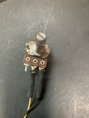

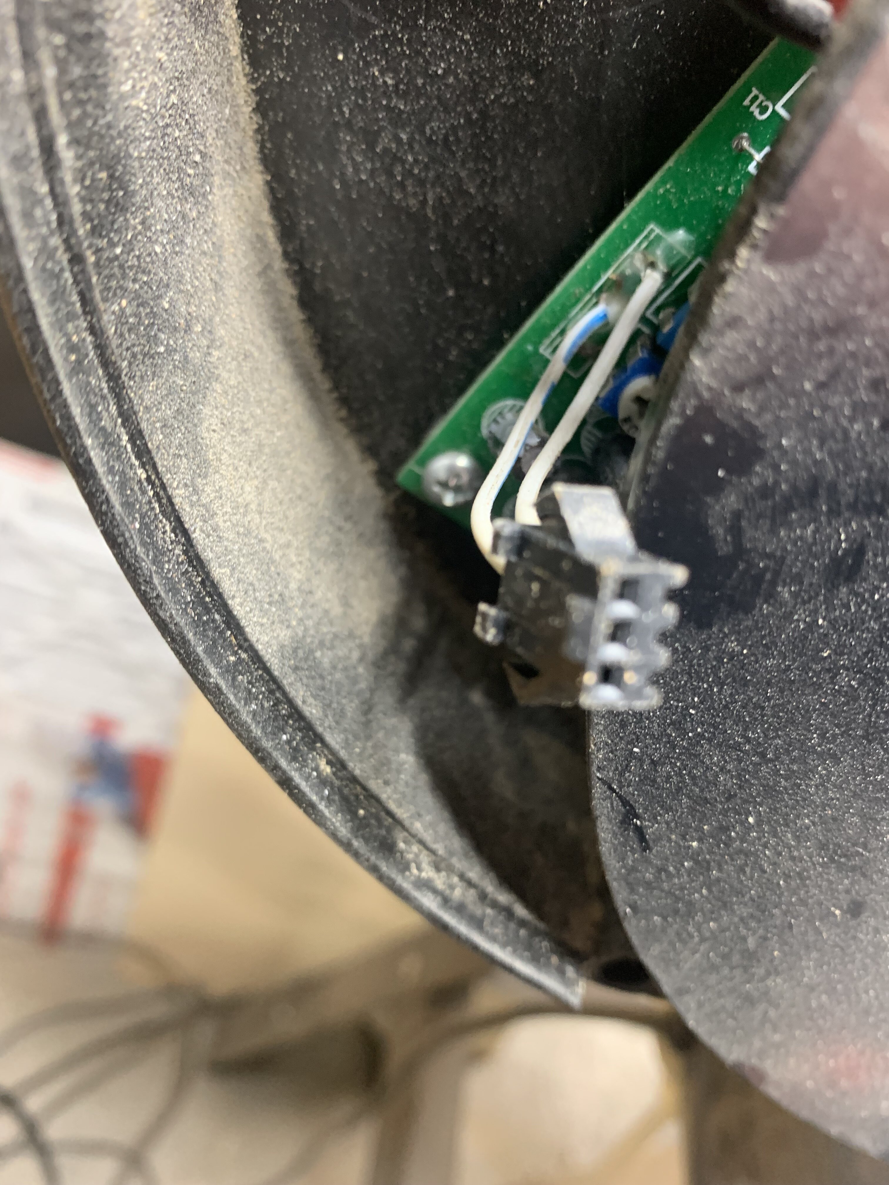

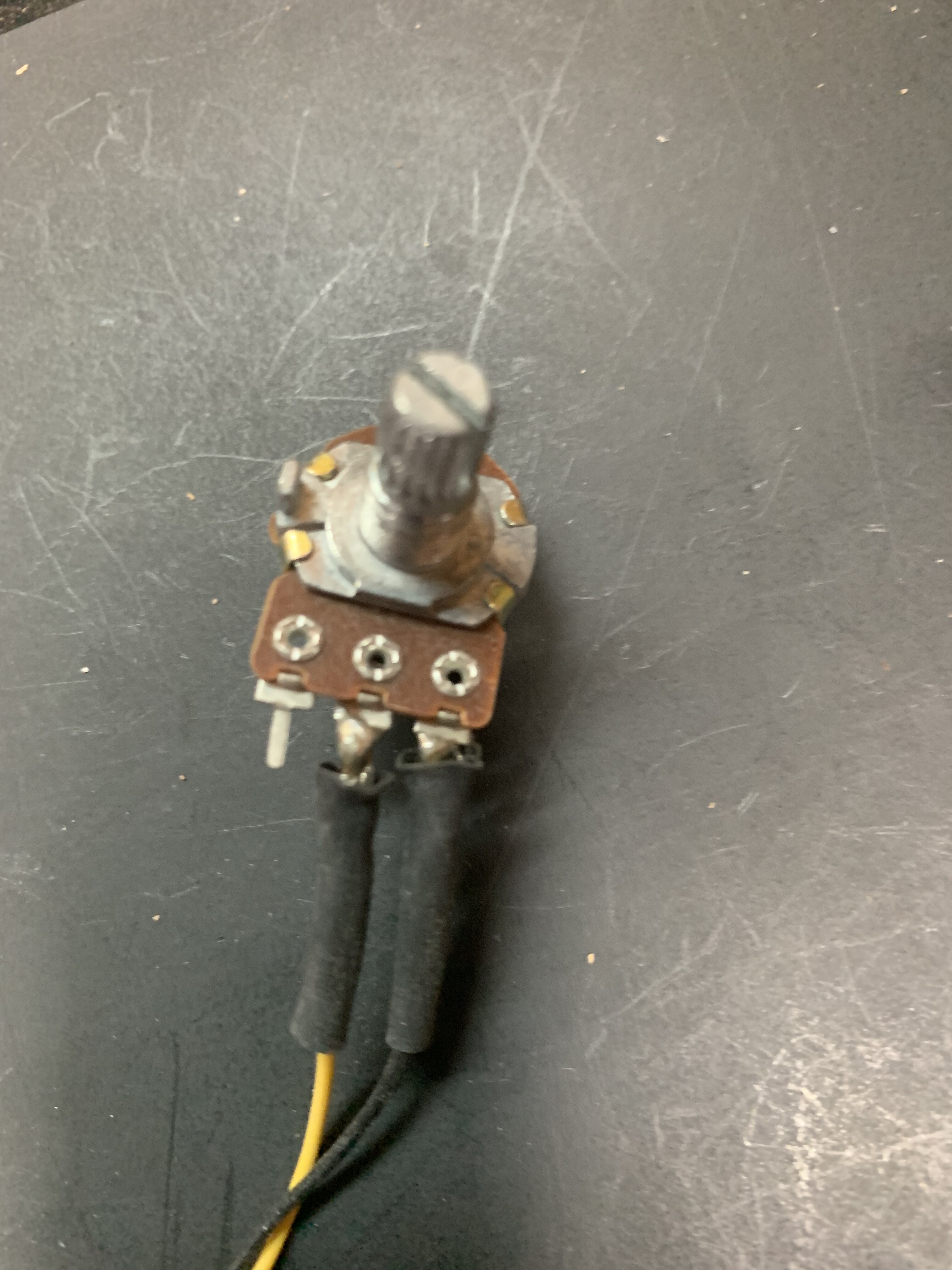

kmmcrafts Posted February 5 Posted February 5 Before I stopped scrolling two years ago my Excalibur speed started acting up. I toyed around some with it and fount the mounting nut to mount the dial ( pot switch ) was loose so I blew some air around it and then tightened up the nut which seemed to make it work. Haven’t used the saw much since other than just a quick cut of something that my laser didn’t cut all the way through. Other day while trying to cut out the candle holder ( post in the bragging section ) the saw was mostly stuck on the lowest speed but if I wiggled the dial around I could saw one handed and hold the switch it would work. Was hopeful that it wasn’t the circuit board but once I found holding the switch and it made changes I was certain it was just the switch. I never looked to closely at this switch and always thought it was a part of the circuit board and was only sold as a controller and board together. This morning I looked on Seyco for the parts and found they do sell just the switch with wire pigtail. Figured before I order any parts I’d take it apart and inspect it. Plus I wasn’t about to pay $55+ shipping for a $5 switch that I can solder to my pigtail plug. Upon inspection I found that there are three wire pins on the switch but only two wires connected. On the plug end there are three pins and wires so is one missing? Also found that on the black wire at the switch is really loose and only has one or two strands of wire even soldered which is making me think this is my problem and maybe no parts needed. I’m really curious what the red wire is doing since it’s not connected to anything on the switch end but is connected on the plug end. Maybe this could be a problem? I’m going to take this to my son to have him solder it for me as he is way better at soldering than I am and try it. I’m going to see if I can see how many wires are on the Seyco parts in the pictures. I read somewhere about some of the China made saws had only two wires where the replacement had three but it worked fine anyway so maybe I don’t need that red wire. I’m far from understanding any electrical stuff like this but maybe someone knows why there are some two wire switches and some are three? OCtoolguy 1 Quote

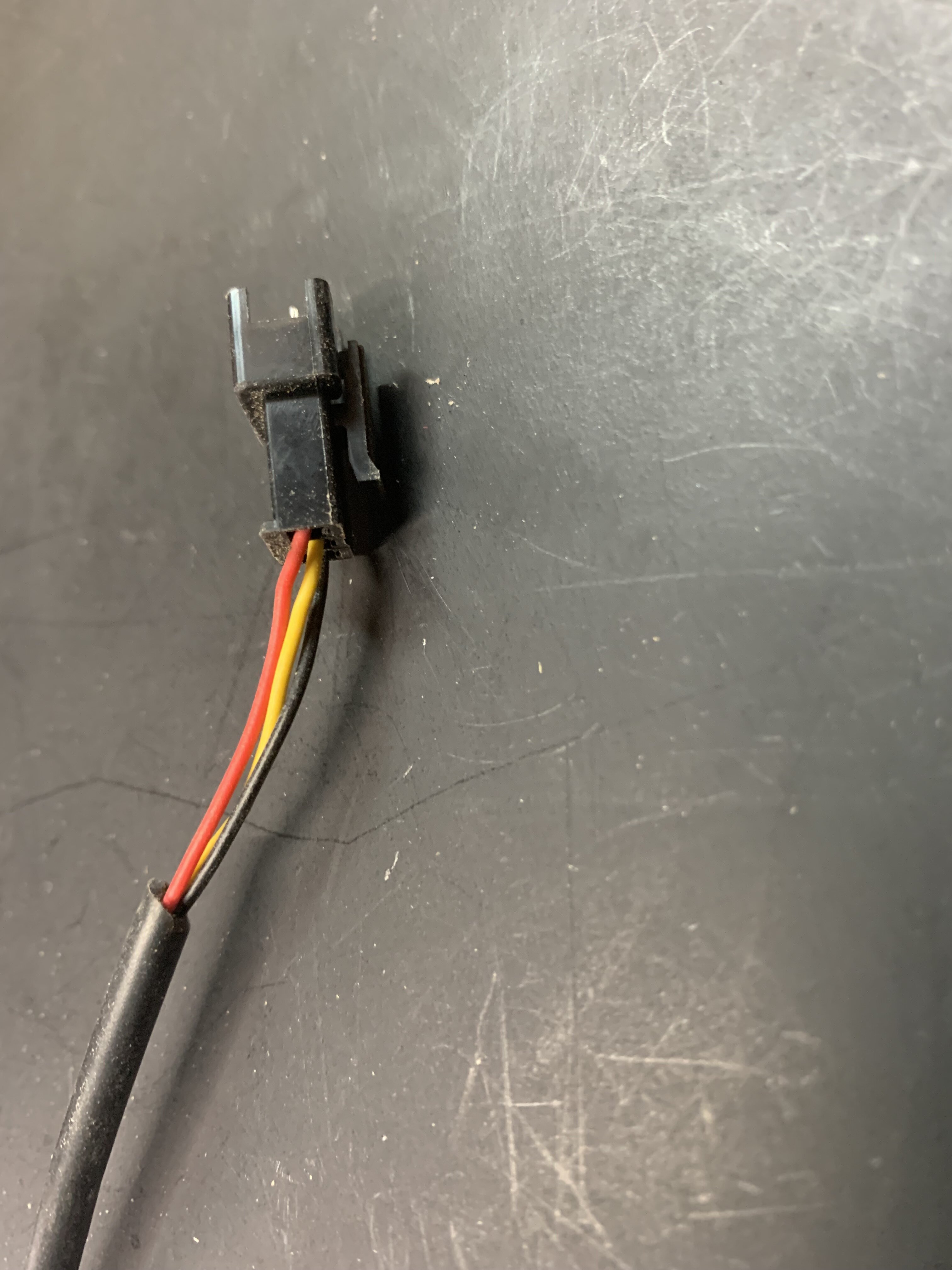

kmmcrafts Posted February 5 Author Posted February 5 Well duh! Looking at the wires on the other end of the plug that goes to the circuit board just now and I see there is only two wires there so I assume the red wire isn’t even connected to anything. And looking more closely at the pigtail on the switch end I see it looks like the red wire is cut right flush with the sheathing. Assuming they bought the pigtail premade and it came with three wires but they only needed two. OCtoolguy 1 Quote

kmmcrafts Posted February 7 Author Posted February 7 4 hours ago, rash_powder said: If you can measure the RESISTANCE between the two wires, you will find the high value and low value. Head over to digikey and you should be able to find an adequate replacement that will fit. There may even be part numbers somewhere on it that you can use to find the replacement. All that said, you have what is called a potentiometer; it varies resistance from one set of pins to the other, with the middle being common. Think the balance adjust on your stereo. Using only two of the pins makes it function like a rheostat, which is just a fancy adjustable resistor. Think like the volume control on your stereo. Pots are far more common. Try blowing it out with air or contact cleaner first. It may just be the internals got a bit dirty. A common failure is 'dead' spots on the insides; that cannot be fixed. The switch I believe is fine.. the issue is the solder came apart on one of the wires that connects to the switch.. IF I wiggle the wire around the speed control seems to work.. I don't have a solder iron but my son does so I'm just going to have him solder the wire back on.. It currently only has one strand of wire connecting it.. and Yes.. I've replaced these switches before on one of the older Hawk scroll saws I have. Back then the part was $3 but now I see they're nearly $10 by the time I pay shipping.. Still beats buying the part from Seyco at $55 plus shipping.. But anyway.. will try to solder first and if it still has issues then I'll buy a new switch. For those that can't solder you can buy them with wires already soldered on and could probably use a crimp on style butt connectors to connect it to your existing plug.. They seem to be around the same price with the wires as they are without.. I'll just solder the switch but thought that might be an option for those that can't solder. JTTHECLOCKMAN and OCtoolguy 2 Quote
JTTHECLOCKMAN Posted February 7 Posted February 7 2 hours ago, kmmcrafts said: The switch I believe is fine.. the issue is the solder came apart on one of the wires that connects to the switch.. IF I wiggle the wire around the speed control seems to work.. I don't have a solder iron but my son does so I'm just going to have him solder the wire back on.. It currently only has one strand of wire connecting it.. and Yes.. I've replaced these switches before on one of the older Hawk scroll saws I have. Back then the part was $3 but now I see they're nearly $10 by the time I pay shipping.. Still beats buying the part from Seyco at $55 plus shipping.. But anyway.. will try to solder first and if it still has issues then I'll buy a new switch. For those that can't solder you can buy them with wires already soldered on and could probably use a crimp on style butt connectors to connect it to your existing plug.. They seem to be around the same price with the wires as they are without.. I'll just solder the switch but thought that might be an option for those that can't solder. Just a point of interest you want to use elctronic solder as opposed to standard pipe solders. Electronic solder has flux built in and also melts at a lower temp so it does not harm electronic components. It is also a more flexible solder. Cleanliness is key. Clean surfaces helps for better adhesions. OCtoolguy, kmmcrafts and Scrappile 2 1 Quote
kmmcrafts Posted February 16 Author Posted February 16 Just to follow up, we soldered the wire on better and I just put it back together and it works like it should now. This had been an ongoing problem over the last few years with this saw running jumping speeds around now and then. If you have this with your saw and you can solder you might try resolder the wires before buying parts. Scrappile, Fab4, MarieC and 2 others 4 1 Quote
