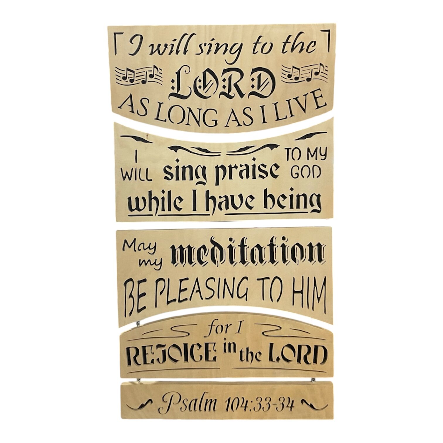

Popular Post Denny Knappen Posted June 15 Popular Post Posted June 15 This is a Keith Fenton pattern, a project I wanted for Dianne. I used 1/4" Baltic Birch plywood for the top layer and 3/8" Baltic Birch plywood stained black for the bottom layer. The reason for 3/8" is so that the hanger would not poke through. Cut on the Pegas scroll saw using Pegas #1SPR MG blades. One coat of spray Shellac, sanded, a coat of spray Lacquer, sanded, and a final coat of spray Lacquer. I used tiny screw eyes to attach the panels. I did a video on attaching the panels on my YouTube channel, ArtCrafters Scroll Saw. Comments welcome. Horseshoe, barb.j.enders, JackJones and 10 others 11 1 1 Quote

don in brooklin on Posted June 16 Posted June 16 Outstanding cutting. What size drill did you use around the high lighting for "Meditation"? Had to look closely to see how it was done. Quote

Denny Knappen Posted June 16 Author Posted June 16 6 minutes ago, don in brooklin on said: Outstanding cutting. What size drill did you use around the high lighting for "Meditation"? Had to look closely to see how it was done. Hi Don. I used a #68 HSS Twist Drill Bit. Just fit within the waste area. Quote
