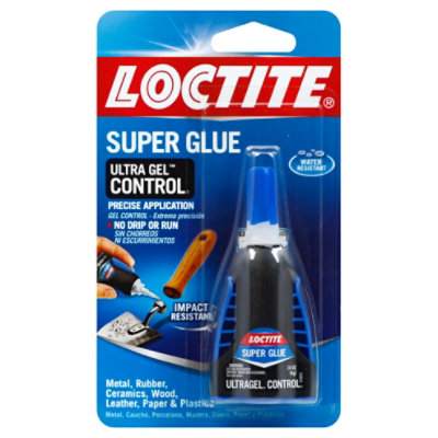

Bill WIlson Posted April 11, 2022 Report Posted April 11, 2022 I use this. As long as I remember to put the lid back on tight, I've never had it dry up on me. I don't use accelerator. Sets up fast enough for me without it. Jim McDonald, ChelCass and OCtoolguy 2 1 Quote

timelett Posted April 11, 2022 Report Posted April 11, 2022 I have been using the lock tight gell ,I have had a bottle for I don't know how long,the accelerator I use came from Rockler and it don't smell anything like water. Can't remember the price but it works ,I don't use it a lot tho. OCtoolguy 1 Quote

BadBob Posted April 12, 2022 Report Posted April 12, 2022 16 hours ago, Bill WIlson said: I use this. As long as I remember to put the lid back on tight, I've never had it dry up on me. I don't use accelerator. Sets up fast enough for me without it. Every one of these I ever used dried up shortly after being opened. OCtoolguy 1 Quote

FrankEV Posted April 13, 2022 Report Posted April 13, 2022 For the samll amount of CA I need in this hobby I have gone to using the Loctite or Gorrila brand CA, but in the gel form. More expensive than using the larger bottles available, but I do use up these small bottles before they can dry up, as long as I put the cap back on quickly. The loose liquid CA is too easy to spill or drip and makes using a very small amount difficult. I can put a single drop of the gel on a break or the like much easier. Afte it dries, it can even be cleaned up with some Dremel Burrs as needed. I have also mixed it with sawdust to fill a voild. Works better than using Titebond and sawdust. don watson and OCtoolguy 1 1 Quote
