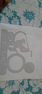

Gene Howe Posted July 31, 2023 Report Posted July 31, 2023 I just finished cutting a Nativity scene puzzle, not too involved. Mostly straight cuts. Used 3/4 oak and a #5 skip tooth. Next up is a relatively simple clock pattern...just a few holes and, few tight outside turns which can be made by cutting into the waste... cut in 3/4 poplar. I thought another #5 or #7 skip tooth would work well. Possibly a #3 in places. It's a golf scene. The ball's dimples, for instance, look a bit tight. My question is are my choices of blades about right? Quote
Sycamore67 Posted July 31, 2023 Report Posted July 31, 2023 Your choices sound god to me. The dimples could be difficult. Van you drill holes the size of the dimples instead of cutting them. Quote
Gene Howe Posted July 31, 2023 Author Report Posted July 31, 2023 7 minutes ago, Sycamore67 said: Your choices sound god to me. The dimples could be difficult. Van you drill holes the size of the dimples instead of cutting them. Thanks! Can't drill total design. They're curved to simulate their appearance on a curved surface. Quote
FrankEV Posted July 31, 2023 Report Posted July 31, 2023 (edited) I don't cut a lot of thick wood. I have done a few sculptures using 3/4" thk Maple and Walnout. Ive also done a few compound cutings in Poplar. Oak is quite hard and Poplar, in comparison is much softer. But wood hardness really only deals with how fast or slow you can advance the blade through the wood. The harder the wood the slower you go. Here is my answer. Note "MY" answer, I always use the smallest blade I can comfortably control and won't quickly overheat and break The smaller the blade the better quality of detail I can get. Now, I'm not a Puzzle maker, so I dont know if you use a large blade to get a wide kerf. If that is the case you are probably right on with your choices. However, if kerf width is not tne reason for your choices, I would probably be using Pegas #1 or #3MGT R blades for much of the cutting like you describe. For very long straight cuts I might use a #5. I have some #5 skip tooth blades and personally do not see much advantage over a reg #5 blade. Possibly for some of the more exotic wood there may be an advantage, but I don't use them often enough to tell. OK, Just my 2cents Edit: After reading the previous responces, let me say I would be using a spiral blade if I was cutting round or nearly round holes. Much easier than using a straight cutting blade. "No spinning da wood!". Edited July 31, 2023 by FrankEV Norm Fengstad and Roberta Moreton 2 Quote
Wichman Posted July 31, 2023 Report Posted July 31, 2023 Gene, I have used #1 polar blades in 3/4 poplar many times. Gene Howe 1 Quote
Gene Howe Posted July 31, 2023 Author Report Posted July 31, 2023 49 minutes ago, Wichman said: Gene, I have used #1 polar blades in 3/4 poplar many times. Carol Rothman, the bowl lady, swears by polars. Quote

barb.j.enders Posted July 31, 2023 Report Posted July 31, 2023 I would like to see pictures too! Especially the Nativity puzzle. I have a pattern and would like to see what you have done. For the puzzle, it is generally suggested to use the smallest blade possible to keep the kerf small. Unless you are doing one for a kid, then you want a larger kerf to make it easier for the kidlettes. Quote
rafairchild2 Posted July 31, 2023 Report Posted July 31, 2023 I agree with drilling the dimples, rather than cutting. Drill just a hair down. Most drills will give you a bit of a pointy end, but some sandpaper on a dowl the right size with the end rounded could be your answer. Experiment with some scrap wood. Note these bits, no more than a 1/16 or 1/8th inch should do the trick. Quote

rafairchild2 Posted August 1, 2023 Report Posted August 1, 2023 11 hours ago, Gene Howe said: OK, folks. Here's the Nativity puzzle, followed by the golfing pattern. Apologies for the crappy pics. I'm not too hot with a camera. Ahhh.. now I see how the divots are done. Not what I was thinking when I suggested the drill. In this case a spiral blade might be a good option, or a #3 or smaller depending on what you can control best. Gene Howe 1 Quote
BadBob Posted August 1, 2023 Report Posted August 1, 2023 For the puzzle, I would use a Pegas #3MGT blade for everything. I use this for all my puzzles. For the clock, I would do the same. Except for the golf ball, for those dimples, I would use the smallest blade I have and drill entry holes with the smallest bit I could get away with. I highly recommend drilling the clock hole with a fastener bit before cutting the clock to ensure it fits well before you cut anything else. You can cut the clock hole with a scroll saw but if it is too small you have to do a lot of sanding to fix it and if it is too large the clock will not fit. I learned this the hard way. Drill or cut the clock hole before you cut anything else. Gene Howe 1 Quote
Solution Dan Posted August 1, 2023 Solution Report Posted August 1, 2023 Do you have a Dremel? Maybe etch or carve the dimples. Quote

Gene Howe Posted August 13, 2023 Author Report Posted August 13, 2023 Got the golf ball dimpled with a dremel. Cutting now. Wichman 1 Quote
