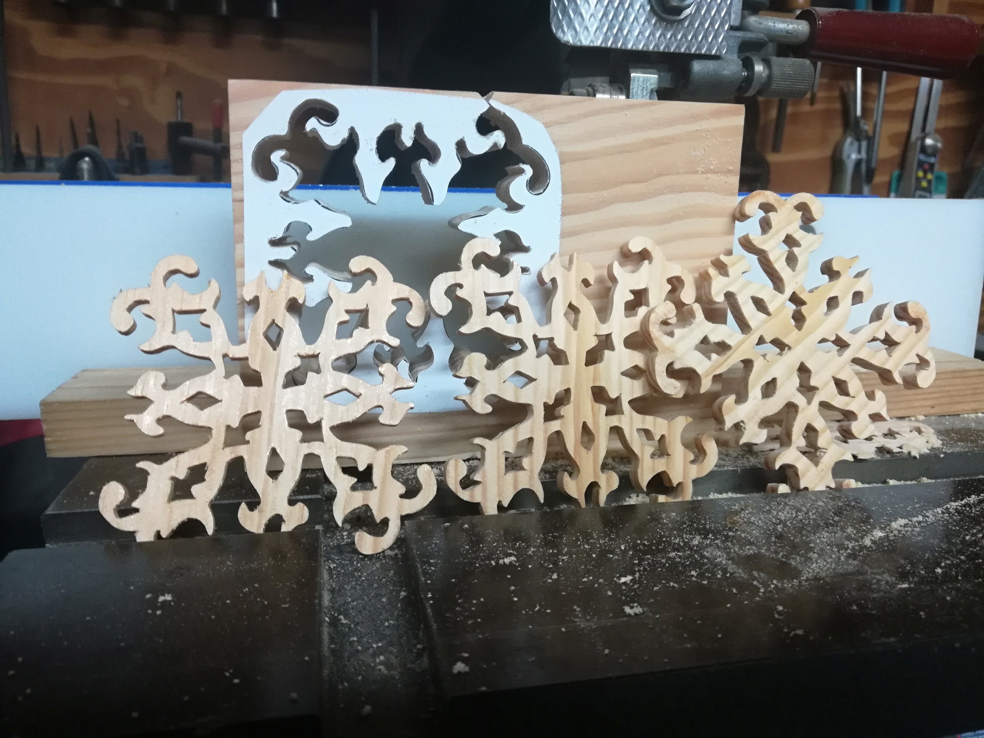

Rolf Posted February 12, 2024 Report Posted February 12, 2024 (edited) I have been stack cutting pretty much since when I started started scrolling, making delicate Ornaments. I've used every one of the methods mentioned. They either damaged pieces or took forever to separate. I now use a PIN nailer in the waste areas on small pieces and on larger projects a couple in the waste areas. To make sure nothing sticks out on the bottom or top I use a small hammer on an anvil. I cut all of the interior cuts and the perimeter is last. No Muss no fuss. You can see the pins in the corners, sorry for the crappy image. This square is 2x2 " Edited February 12, 2024 by Rolf MarieC 1 Quote

Rolf Posted February 12, 2024 Report Posted February 12, 2024 5 hours ago, BadBob said: I don't understand why you have had problems separating the pieces. I was / cutting 1/16 Baltic birch, stacks of 6. very delicate. I don't like solvents. etc. This ornament is 4" tall.. I now put a layer of removable shelf liner on the top layer, the pattern on that, (everything is pre sanded) put 4 pins in the stack. Cut peel the pattern off and I am done. MarieC 1 Quote

BadBob Posted February 12, 2024 Report Posted February 12, 2024 1 hour ago, Rolf said: I was / cutting 1/16 Baltic birch, stacks of 6. very delicate. I don't like solvents. etc. This ornament is 4" tall.. I now put a layer of removable shelf liner on the top layer, the pattern on that, (everything is pre sanded) put 4 pins in the stack. Cut peel the pattern off and I am done. Got it. Quote
