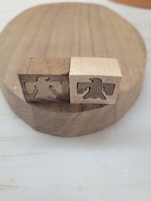

preprius Posted April 18, 2025 Posted April 18, 2025 Advice wanted I was thinking on how I could spice up a bowl with symbols. Like southwest western Indian symbols. Has anyone done this? Here is my work in progress. My bowl board is 3/4" thick. So if I make a symbols it has to be less than 3/4" tall. So my attempt sucked. The top eagle did not fit in bottom at all so I re cut it and have too many gaps. The white maple should have fit into the black walnut. But did not. I need more practice. The black walnut actually cracked. Probably due to end grain and only 1/8" spacing. The next step is to take this inlay and put into the bowl board. So when I cut the rings I will have western symbols. Yes all rings will have these symbols. Unless I cut 2 or 3 rings first then put the symbols in the bowl board. If the bowl is round I could rotate the rings and symbols to any position. This inlay concept avoids the symbols across from each other. My final test will be on a cowboy hat. Which is not round. But I have to get better at this end grain small inlay. Discussion is welcome. Me. Mark Eason Wichman and OCtoolguy 1 1 Quote

preprius Posted April 18, 2025 Author Posted April 18, 2025 @Scrappile how large, diameter, are those scrollsaw animals? Were they end grain? Oh were those symbols just glues on, not inlay. Sorry for so many questions. Wow, that is a really nice project. Good teamwork. That does give me the idea that I might not need end grain. Any thoughts? OCtoolguy 1 Quote
Scrappile Posted April 18, 2025 Posted April 18, 2025 The animals I did were cut in 1/8" thick, and they are a little over 1" tall. Which can be resized if needed. Of course, the simpler the cut, the smaller it can be. This is a large bowl. But the concept is very doable. I would be tempted to fill in over the insets with clear epoxy. He did not, and really, no need. Just something I thought could be done. Dan 1 Quote
Dan Posted April 18, 2025 Posted April 18, 2025 Just curious, but why does it have to be end grain? How big will the bowl be when finished? Most of the bowls I've seen are segmented like what Paul showed. @scrappile, nice job on the bowls you helped with. I like the idea of filling with epoxy. Scrappile 1 Quote
preprius Posted April 18, 2025 Author Posted April 18, 2025 (edited) 26 minutes ago, Dan said: Just curious, but why does it have to be end grain? How big will the bowl be when finished? Most of the bowls I've seen are segmented like what Paul showed. The end grain was my first thought as I duplicate the " board to bowls" concept. The bowls I was thinking is about 8" diameter. But the bowls were just a starting point. The final goal is to put symbols on my wearable cowboy hats. The wall thickness is 1/8". The symbol inlay would have to be inlay in the circle pattern. Edited April 18, 2025 by preprius Quote

preprius Posted April 19, 2025 Author Posted April 19, 2025 Here is some pics for discussions.... This is quick and dirty experiments using the crappy inlay from before. I installed both symbols facing each other. The next one shows the rings stacked. Everything was falling apart. So I used super glue to finish the experiment. it seems a bit complex. But might be doable. Am I going down a path of future failures? Will the symbols fall out with the cold or hot weather. MarieC and Scrappile 2 Quote
Dan Posted April 19, 2025 Posted April 19, 2025 Have you thought about bevel cutting? The pieces would drop right in place with virtually no kerf. May seem like more work but once you get the hang of it it should go pretty quick. Scrappile and MarieC 2 Quote
preprius Posted April 19, 2025 Author Posted April 19, 2025 I started out using the wrong blade. I used a 00 skip blade and set the angle at 0.2 drgrees. For a 1.5" thick cut the blade was too small and I was pushing too hard. The Blade broke twice. So I sent a #1 through the same cut. And then got bad results. I should go to the #3 and set a 0.9 deg. or a tad less. I will try again and not be so impatient. Scrappile 1 Quote
