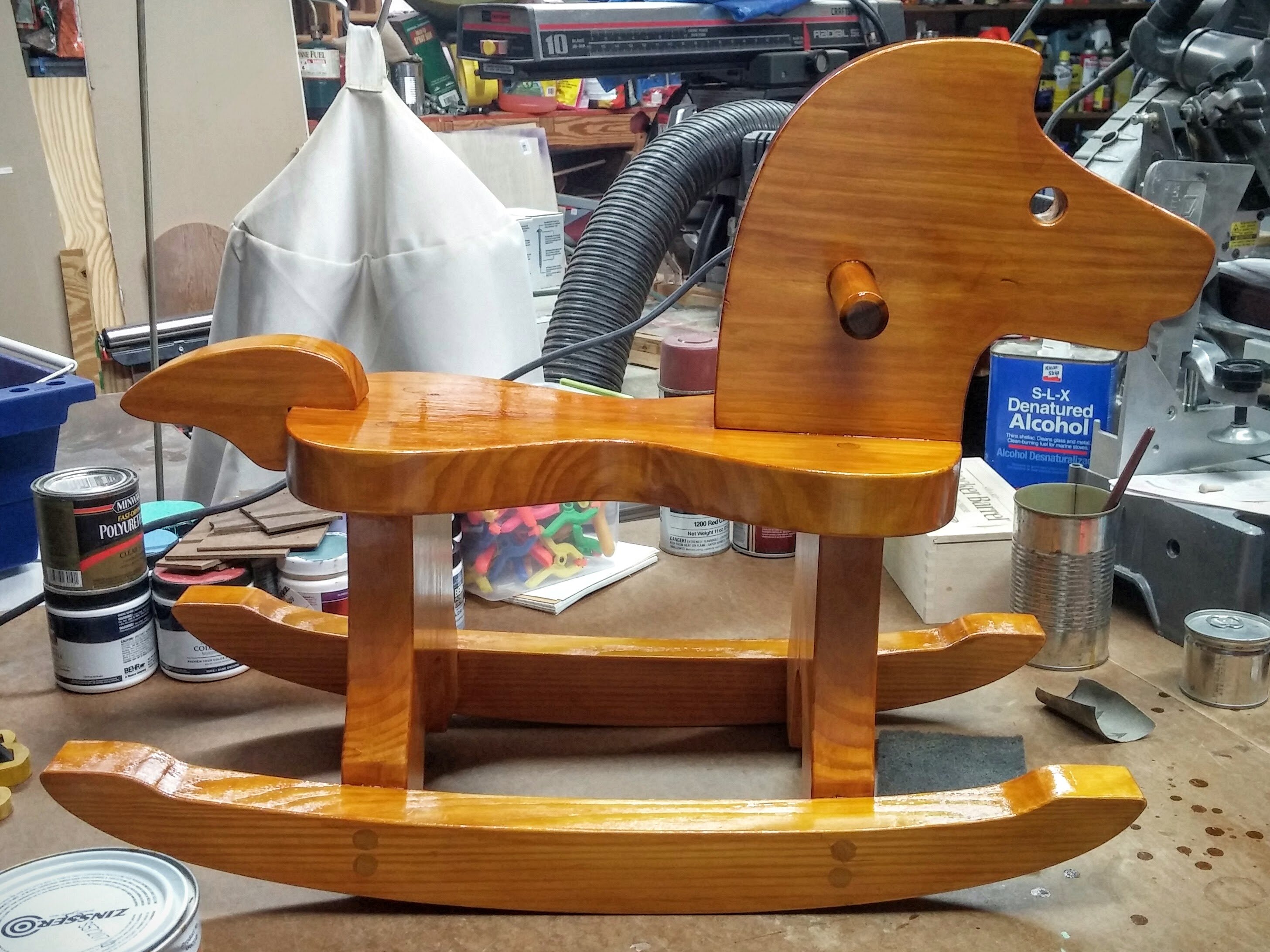

BadBob Posted October 30, 2025 Posted October 30, 2025 1 hour ago, Skyhawk7 said: Afterward, I thought that "heavy Oak" was not very helpful. I have a source for 4/4 and 6/4 White and Red Oak, and I find myself using those boards a lot. My current toy project is making two rocking horses for two of my grandchildren (the attached picture is what I'm working on). The plans call for gluing 3/4-inch boards together to create the thicker stock. I'm not selling anything, but I just want to make some vintage toys for all of my grandchildren as they grow up (they're all young now... the oldest are toddlers, old enough for rocking horses). My oldest is crazy about trains, so I think my next project for him will be a train set. My oldest granddaughter likes farm animals, and I thought I'd try a tractor with a wagon and farm animals she can play with. When she is older, I really want to do a nice vintage dollhouse (more fine work there). I have primarily made furniture over the past 30 or so years and never considered toy making until recently. I must admit that I am excited about all the cool possibilities. It looks a lot more fun than furniture making... but every so often I do build furniture for our house to keep Mrs Skyhawk tolerating my woodworking hobby. The Wen will do Oak at 3/4", but I would like a saw that is an upgrade with a deeper throat and LOL, I'm an old guy now and would like to treat myself to a nicer saw... not a need as much as a want. I liked the fact that the Hawks made by Bushton are USA-made in a small midwestern town (I live in the Midwest). I might just buy a new saw from them; the BM-20 looks like it would be good for what I do. I'm just trying to get an idea of the possibilities, used vs new, and the various options. Hope I didn't talk your ear off here. I'm thankful that I can run some of this by people more knowledgeable than I am. Thanks for answering my post, I appreciate it. I made this toddler rocking pony for my grandson. I made it from southern yellow pine and finished it with shellac. I used a bandsaw for most of the cuts because southern yellow pine is a bear to cut with a scroll saw. After almost ten years, it is still in use, and my grandson still rides it at years old. This aggravates he much younger sister, who claimed it was hers as soon as she saw it the first time. She took one look at it and said, "Mine". My house is full of wooden toys. There are toys that my grandkids play with today that I made 30-40 years ago. Wood toys can be extremely durable and repairable. red river, ChelCass, OCtoolguy and 1 other 4 Quote
