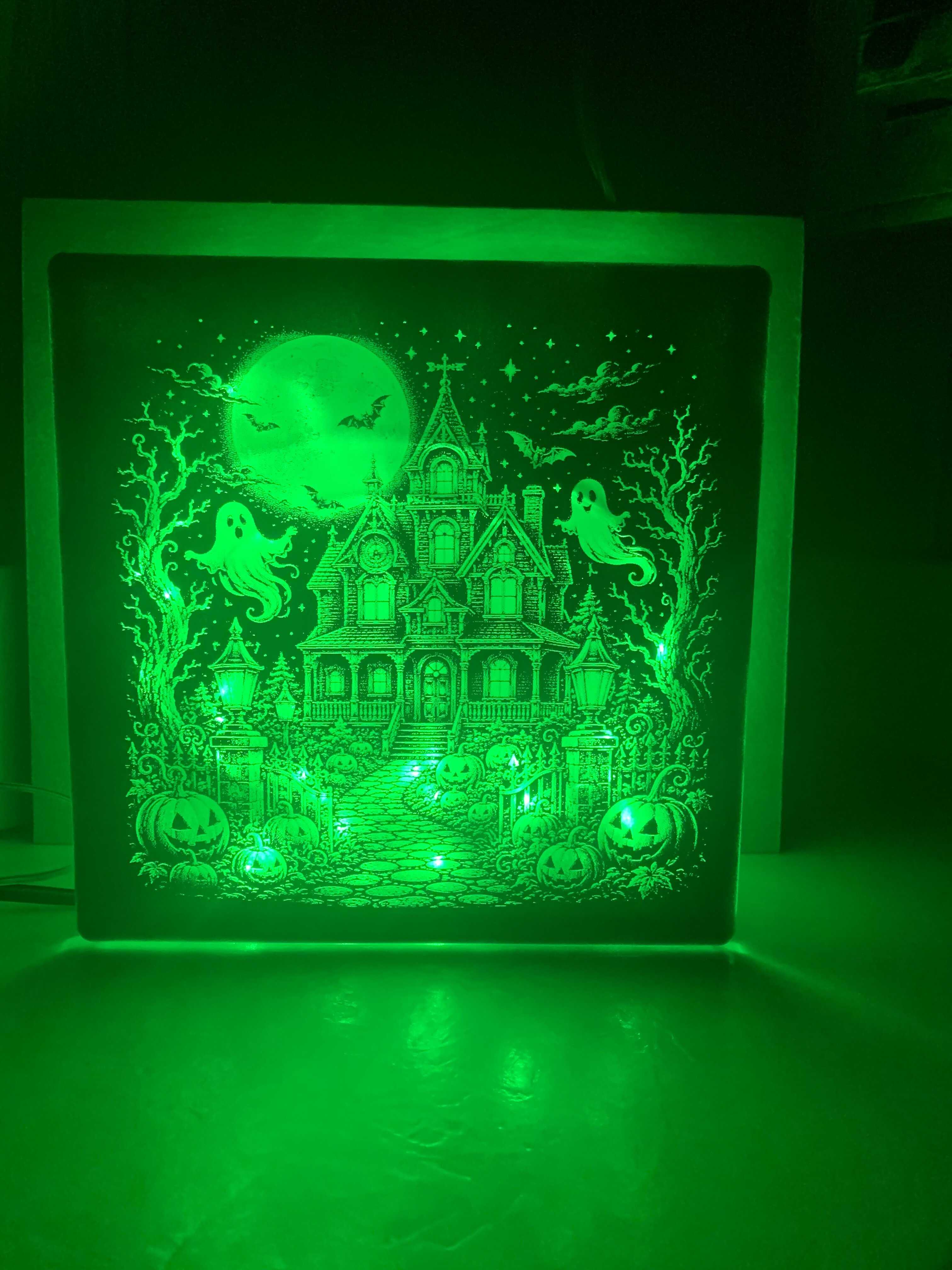

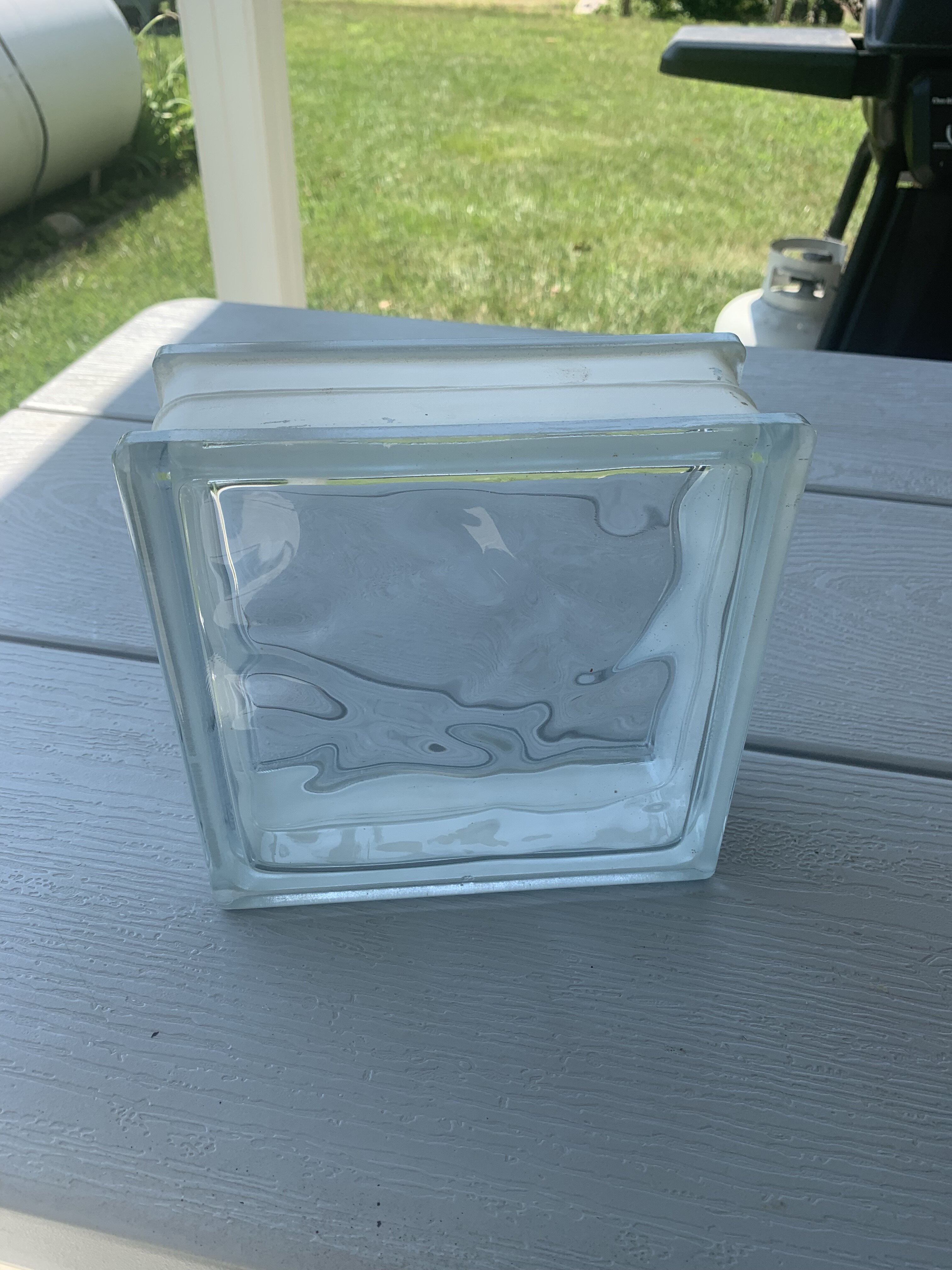

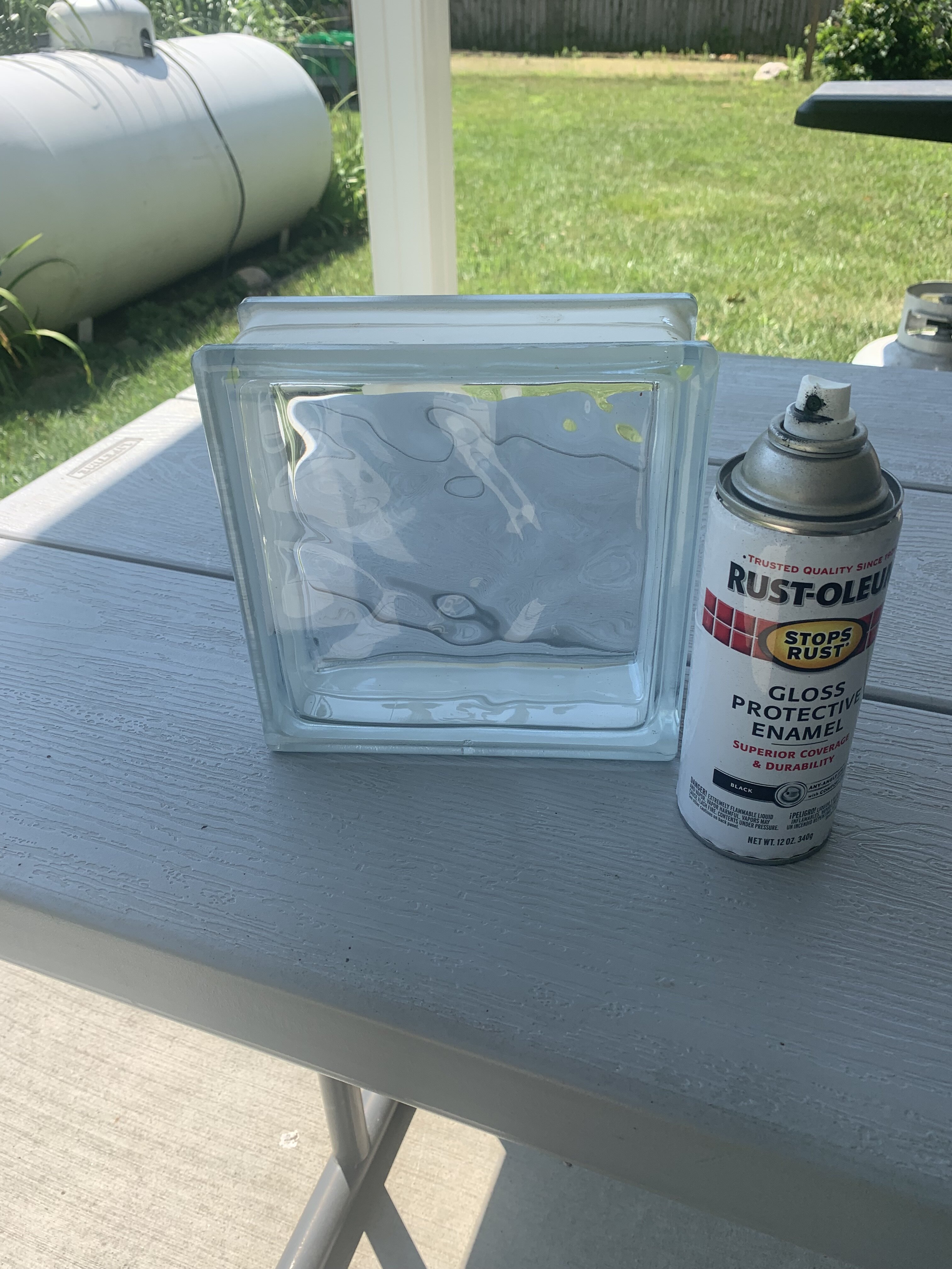

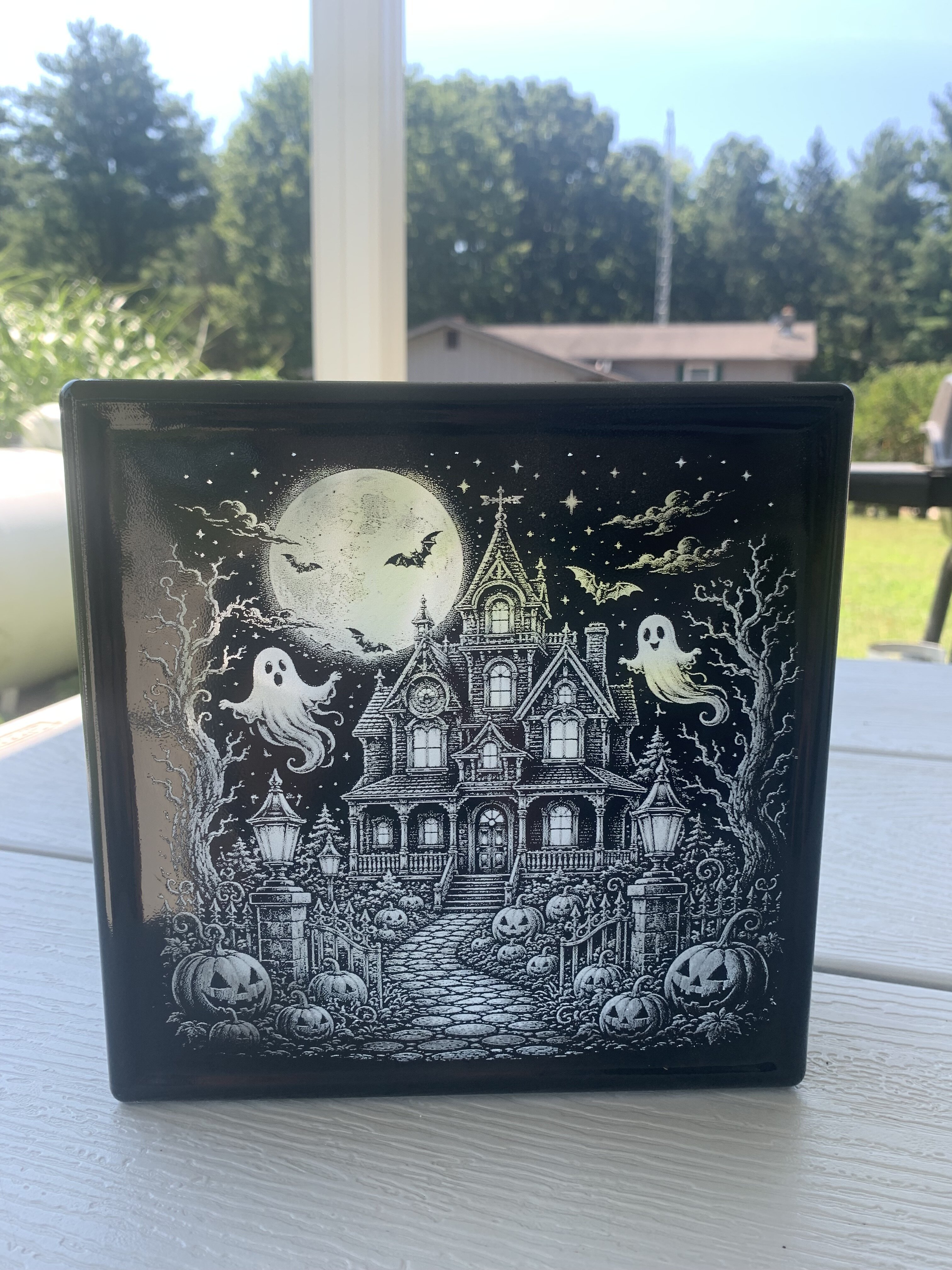

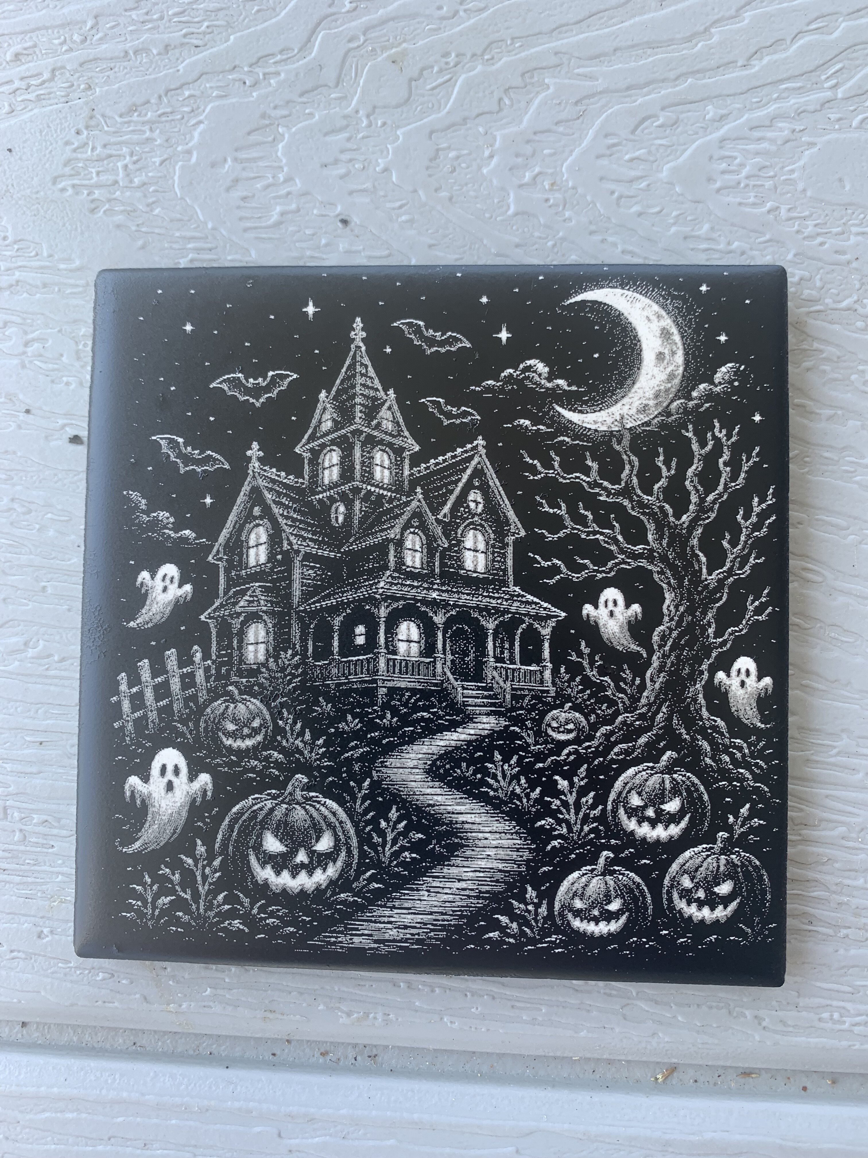

kmmcrafts Posted August 4 Author Posted August 4 (edited) Okay so the paint I have is the right brand but wrong kind, LOL.. Mine is acrylic paint, not enamel paint shown in the link. I asked chatgtp the question and it says any paint that is a "multi surface" paint. What it comes down to it seems is that it'll scrap off really easy until the paint is fully cured. SO, unless I wait 30 - 90 days or use a paint with a catalyst or possibly put in the oven to bake it on my idea isn't going to work for this years holidays. I might do tractor paint with a catalyst since tractor paint is much cheaper than automotive paint and with the catalyst is pretty durable for multi surfaces. Let me tell / show what I was doing and maybe someone has an idea besides paint. I have had these glass blocks as I bought a case of them maybe 25 - 30 years ago when there was a popular crafts thing to decorate these and add Christmas lights inside.. maybe still a popular thing. I know I bought these before they got soo popular these didn't have holes in them for adding the lights.. not too long after I got these ( maybe a year or two ) they made them available with a hole and a plug for crafters. Anyway I drilled the holes and spray painted this black.. then put it in my laser to engrave the paint back off to create the designs on them. The issue is the paint is very easy to scratch and basically ruin them if not careful.. however the first one I did a few months ago is in fact pretty durable now.. so it is just needing to let the paint fully cure. I was looking for something better that was quicker to dry so I could make some Halloween and Christmas themed ones for family and friends but don't want the paint getting scraped off during them handling them etc. I also had these ceramic tiles I was going to make coasters out of.. they're just left over from a project I did several years ago.. but again the paint scratches too easy for them to be used this year unless I use a expensive paint and take the time to spray a batch of all of this with a spray gun etc. IMG_6724.mov Edited August 4 by kmmcrafts JackJones, tomsteve, TAIrving and 4 others 5 2 Quote
Scrappile Posted August 4 Posted August 4 Darn! That is very cool, I have the glass blocks, I do not have the engraver. OCtoolguy 1 Quote
kmmcrafts Posted August 4 Author Posted August 4 26 minutes ago, Scrappile said: Darn! That is very cool, I have the glass blocks, I do not have the engraver. Many areas have places called makerplace? now where you can go use a laser and many other tools for personal use. I've read some libraries have them now too.. Scrappile and OCtoolguy 2 Quote
