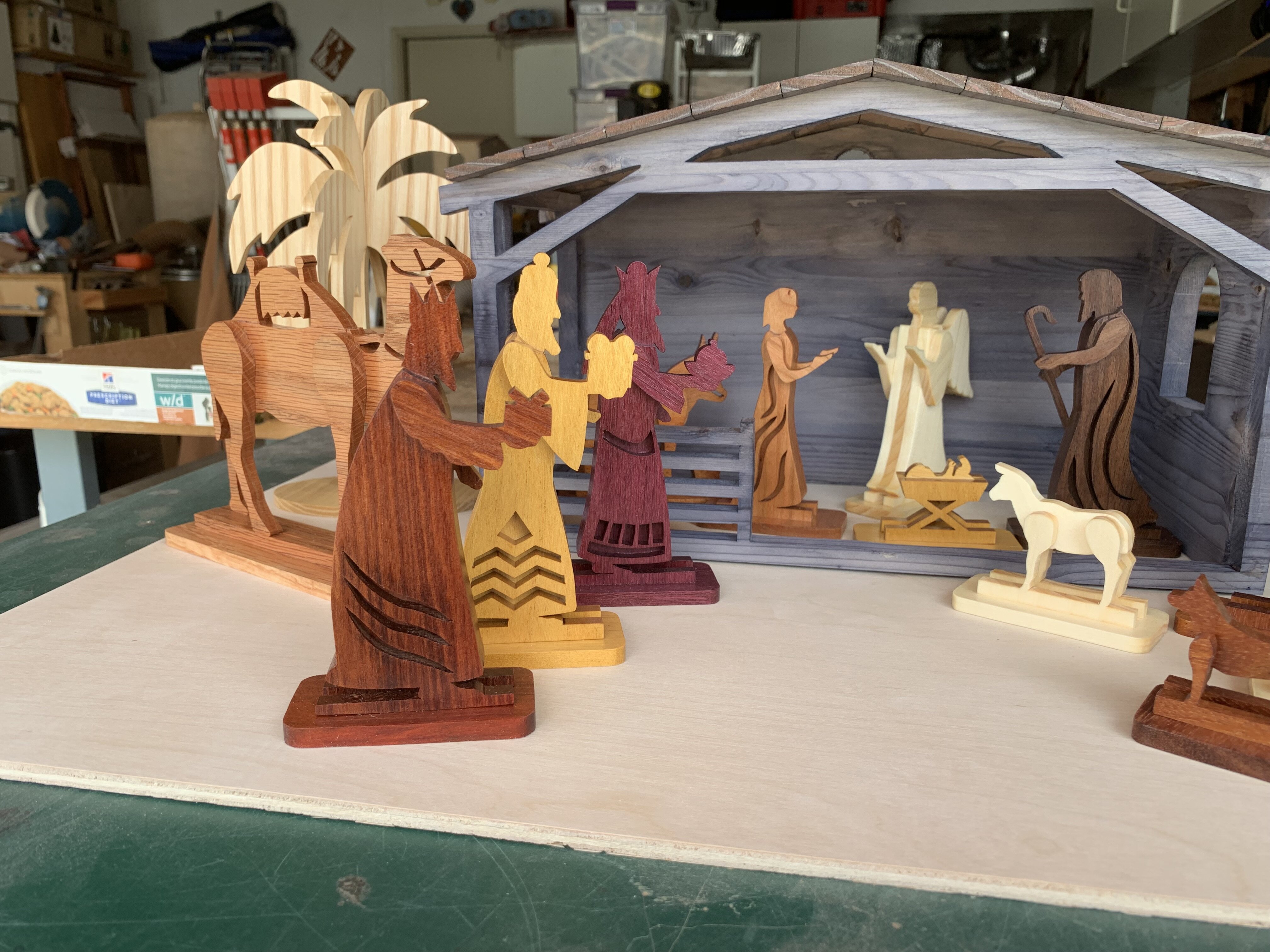

dgman Posted Wednesday at 01:03 AM Posted Wednesday at 01:03 AM This is what I used to age the barn in the Nativity’s i have done. It was done in Pine. kmmcrafts, Roberta Moreton, BadBob and 1 other 3 1 Quote
kmmcrafts Posted Wednesday at 09:57 AM Author Posted Wednesday at 09:57 AM 8 hours ago, dgman said: This is what I used to age the barn in the Nativity’s i have done. It was done in Pine. oohhhh, that looks great! Thank you! I didn’t know this was available. I’m going to get some. Quote
