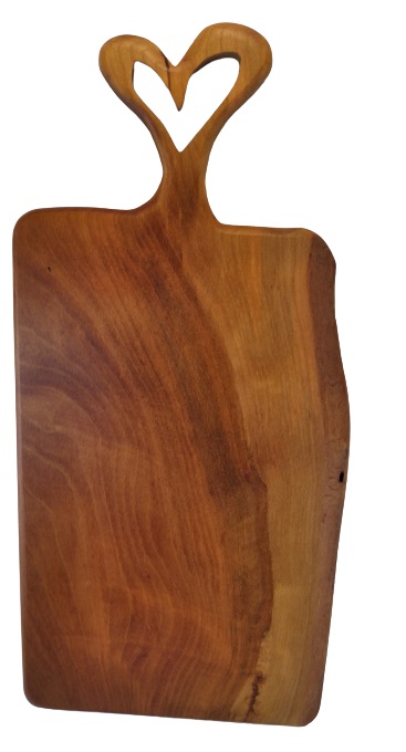

don in brooklin on Posted February 9, 2023 Report Posted February 9, 2023 The WEN looks just the same as my King they just name it spiral versus helical. Recently I have been doing a bunch of chactuterie boards from a twisted slab that was given to me. They contain some scrolling but more milling and sanding. That is why I needed 8 inches wide. Would love to get 10 or 12 but this was all the budget would allow. The Kind in Canada was $625 CAD plus tax. This is an example of one of the boards. kmmcrafts, OCtoolguy, barb.j.enders and 1 other 4 Quote

Joe W. Posted February 9, 2023 Author Report Posted February 9, 2023 1 hour ago, don in brooklin on said: This is an example of one of the boards. Thanks for the input and the photo. That looks really good! OCtoolguy and scrollingforsanity 2 Quote
