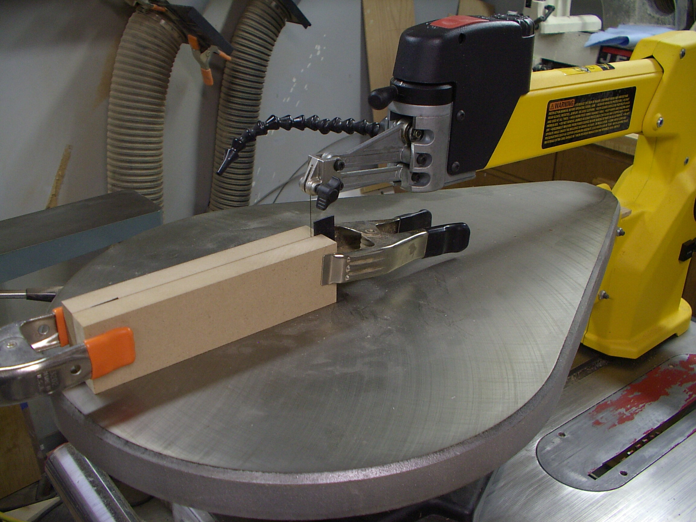

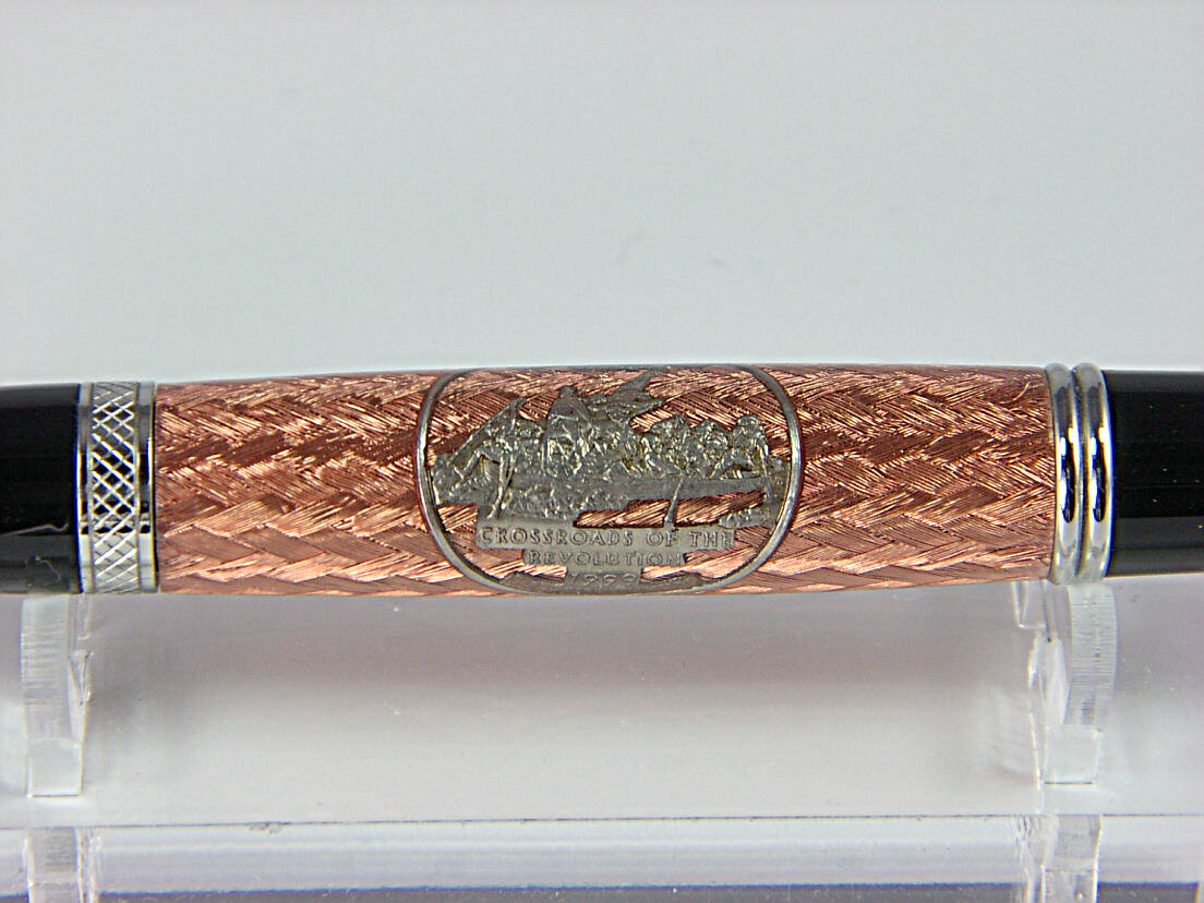

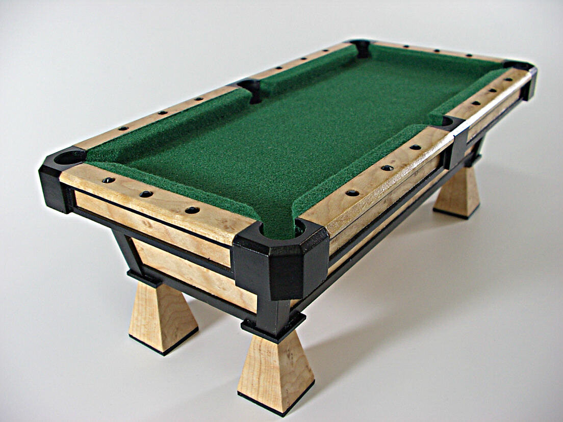

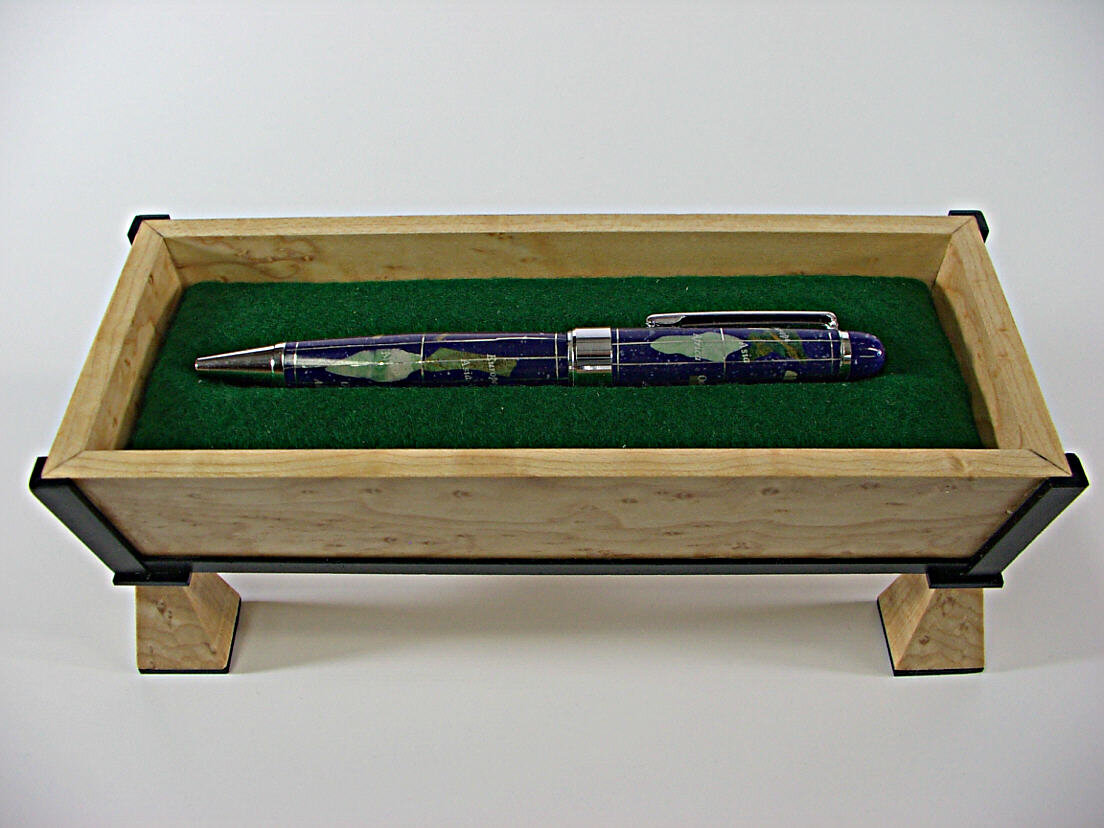

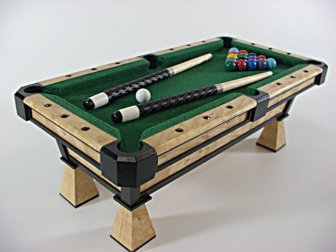

JTTHECLOCKMAN Posted December 23, 2025 Posted December 23, 2025 Any time I work with small parts, weather it is cutting sanding or finishing. I break out the double sided tape. I use turners tape because I know it sticks well even under heat because with turning you build heat. I use alot of that stuff when I built this pool table pen box. besides the pieces were small and thin but fragile. Taped to a larger piece and worked well. philipcollier, JackJones, barb.j.enders and 3 others 5 1 Quote
kmmcrafts Posted December 23, 2025 Author Posted December 23, 2025 4 hours ago, JTTHECLOCKMAN said: Any time I work with small parts, weather it is cutting sanding or finishing. I break out the double sided tape. I use turners tape because I know it sticks well even under heat because with turning you build heat. I use alot of that stuff when I built this pool table pen box. besides the pieces were small and thin but fragile. Taped to a larger piece and worked well. Beautiful box JT!! For some of these pieces are quite fragile I don’t want or need tape that is too sticky. I already broke two of the nes shown but no one will know because I broke the other one to match so they still look the same. They broke just pulling them off of the painters tape. Though this tape is getting old and seems to be more sticky than it was when new. What color tape is less tacky? I don’t need it super sticky. Quote

JTTHECLOCKMAN Posted December 23, 2025 Posted December 23, 2025 (edited) 1 hour ago, kmmcrafts said: Hmm, I originally was thinking if I could use my mop sander it'd be nice but I guess I didn't think about taping to a board like that.. even though I did finally figure out to tape them to the workbench, LOL.. I might give this a try the next time I make a batch. Well that is a delema because in one hand you do not want the piece to fly off when sanding especially using a sander of any kind. But need to be able to pull it off. That is why you use tape designed for wood use and not carpet tape. Big difference. I use turners tape from here. https://www.ptreeusa.com/turn_accessorie_tape.html You ask about tape colors. If using painters tape then purple is less tacky. Green is about the same. Then blue and then yellow really tacky. Just an example, those bumpers on the rails have 3 different angles on them that were done on a router. If I did not have tape and wider sacrifice board there is no way I could get that shape. Now you know how much force a router has when spinning so that shows it works well. Same goes for all the trim work on it. Cut on a 10" tablesaw. Worked very well. I have many rolls of that tape in the shop and use it alot. It does not leave residue behind and if difficult to get off, just a little heat will solve that. All the examples others are showing are tapes used for woods too so that is a good thing. Edited December 23, 2025 by JTTHECLOCKMAN kmmcrafts, TAIrving and BadBob 1 2 Quote

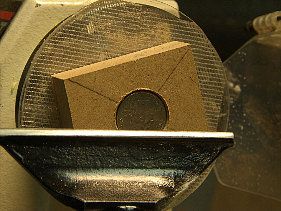

JTTHECLOCKMAN Posted December 23, 2025 Posted December 23, 2025 (edited) 1 hour ago, TAIrving said: Nice work @kmmcrafts and @JTTHECLOCKMAN. And very informative discussion about double-sided tape for woodworking. I have been using "cheap double-sided carpet tape" as recommended by Judy Gayle Robets on her website, intarsia.com. It works but is very sticky and hard to remove. I have also used golf grip tape which is double-sided masking tape. It is somewhat less sticky than the carpet tape. I will try some of the tapes mentioned here when I next buy some. You will notice the difference for sure. I am building a couple jigs for a box project I am working on that will done on my lathe and I trust the tape I linked. Now with that said I have made a sanding disk for my lathe because I sand pen blanks and other things on it and needed a piece of flat sheet metal attach to the face plate. I did not want to use adhesive because do not trust it and also I could not have lumps behind it. needed to be exactly flat. for this I did use carpet tape but I used the strongest I could find and that was from Home Depot in the carpet dept. It is made for outdoors and is better than a cloth tape and has string fibers in it to give it shear strength. I did not want that plate flying off. I knew this wood tape would not hold that. So carpet tape has a place. In this photo you can see the first version I did was plexiglass and then switched to metal. but you can see the carpet tape design in that photo. I also use it to hold that jig where I was thinning a quarter down to demonstrate to someone this was a method to thin a quater so it can be bent around a pen tube for casting. the second method I showed him was me cutting a quater in half down the middle on a scrollsaw. he bet me I could not do it but I won and did it. If anyone wants to give that a try. I would like to see it. I think I have those photos too. Done on my Dewalt 788. I know went off track here. I might as well finish the story. This happened on my pen turning site. This person would use a scrollsaw to cut quarters of the different states and bend them and cast them into a pen blank. being I make pen blanks with a copper mesh I sent him my blank and being he lost he had to cut a NJ quarters and cast it into a pen for me. here was that prize. well worth the effort. Edited December 23, 2025 by JTTHECLOCKMAN barb.j.enders, danny, philipcollier and 2 others 3 2 Quote

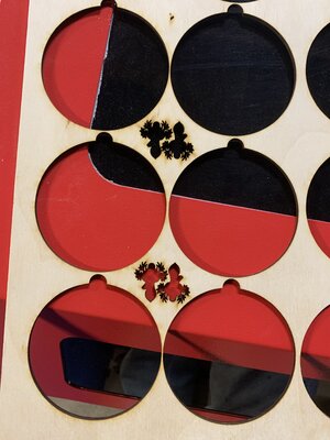

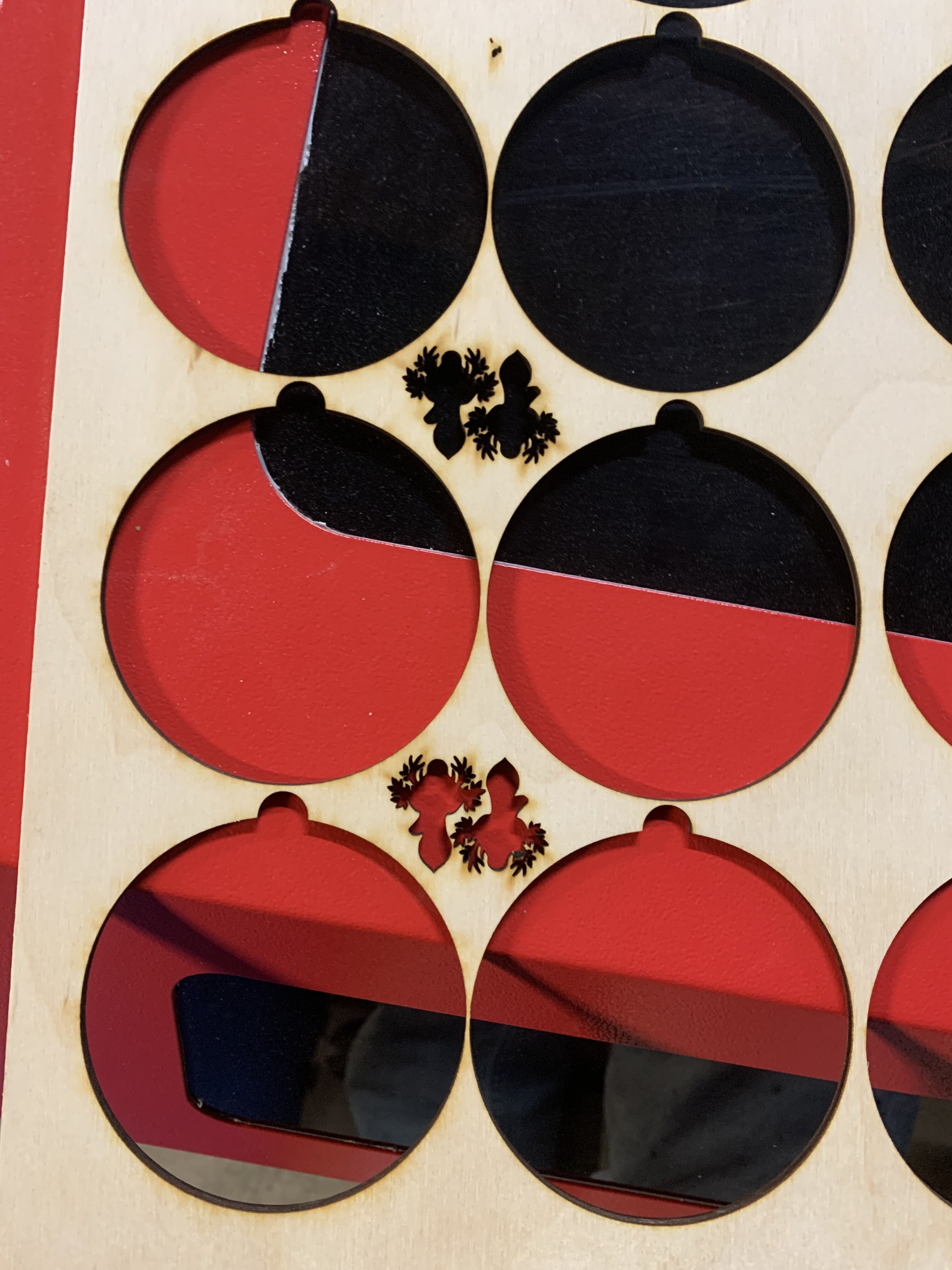

kmmcrafts Posted December 24, 2025 Author Posted December 24, 2025 (edited) 9 hours ago, yamatetsu said: I would make a small jig for this. - cut two boards to identical size - cut one earring out of one board - use spray glue / double tape to glue the two boards together - plop the earring into the hole - sand it - pull the boards apart, remove the earring - tape / glue the boards together - plop the next earring into the hole - rinse and repeat Might be a possibility if I were mass producing these all the same size and shape.. many of the small parts are a 1 off type thing where I would be wasting material to make a jig. This whole small earrings and things started from trying to use up all the small parts of a sheet of plywood. This photo shows that I'm making these from what otherwise would have been scraps from making ornaments. I normally was burning these scraps in the burn barrel or campfires. Edited December 24, 2025 by kmmcrafts Quote
yamatetsu Posted December 24, 2025 Posted December 24, 2025 You could still use that as a kind of jig. - Cut a scrap board, cover it with painter's tape, this will be the backer board - put small strips of painter's tape at the yellow dots - put a dab of superglue on those strips - glue the two boards together - put the piece in and sand it - twist the two boards to separate them without breaking the template board kmmcrafts 1 Quote
