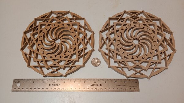

Wichman Posted January 5 Posted January 5 (edited) When I laid out the pieces for the Secretariette I had two sections of warped board and I wanted to try to flatten them, with a twist . After cutting I'm planning to heat the boards in Walnut oil, 275 degrees for two hours then press with weight until cooled ( about two days). I want to see if the oil bath will limit the checking and cracking that can happen with steam bending. The test pieces, pattern by Charles Hand : Edited January 5 by Wichman additional information danny, Sycamore67, btree50 and 2 others 4 1 Quote

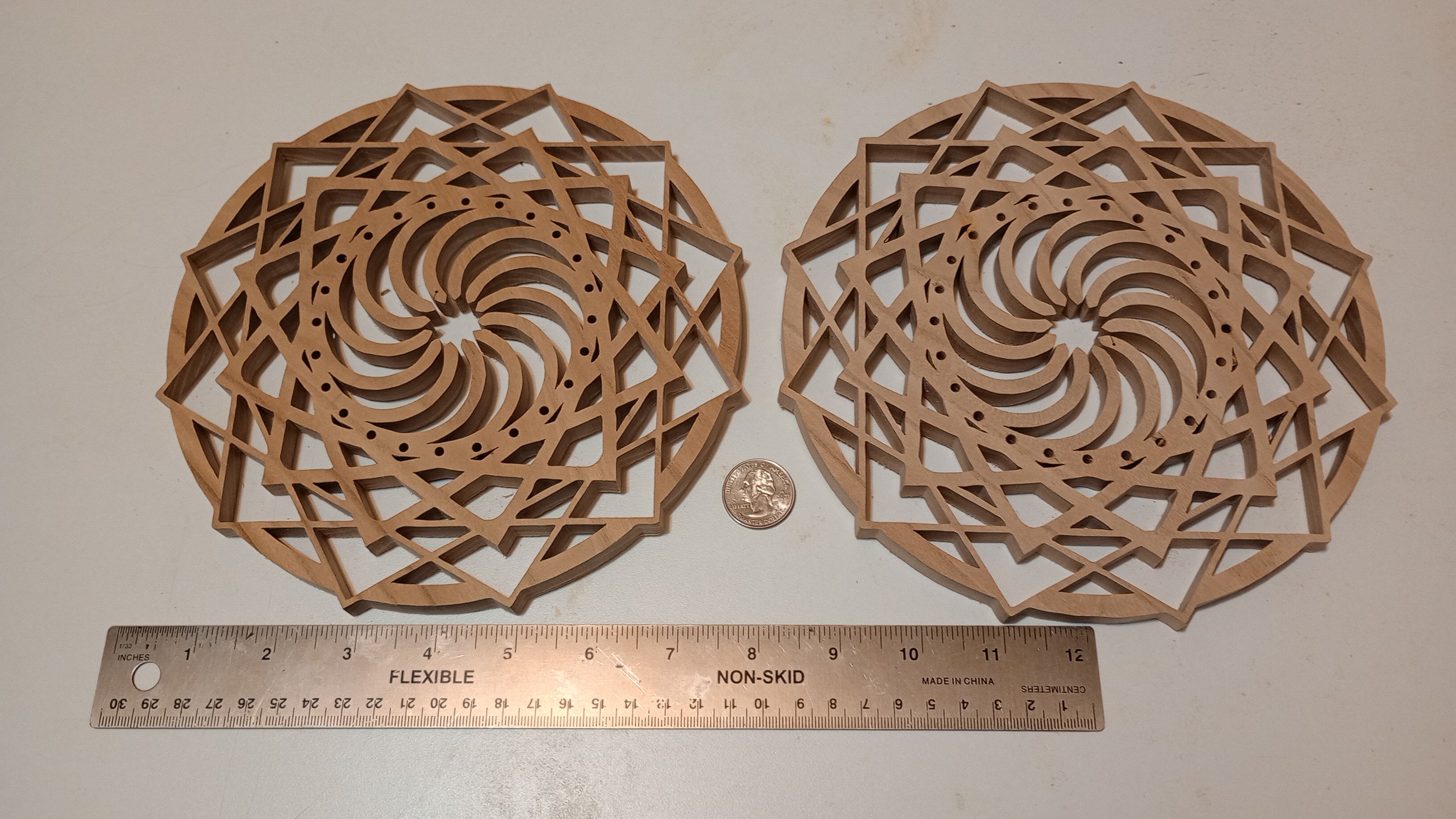

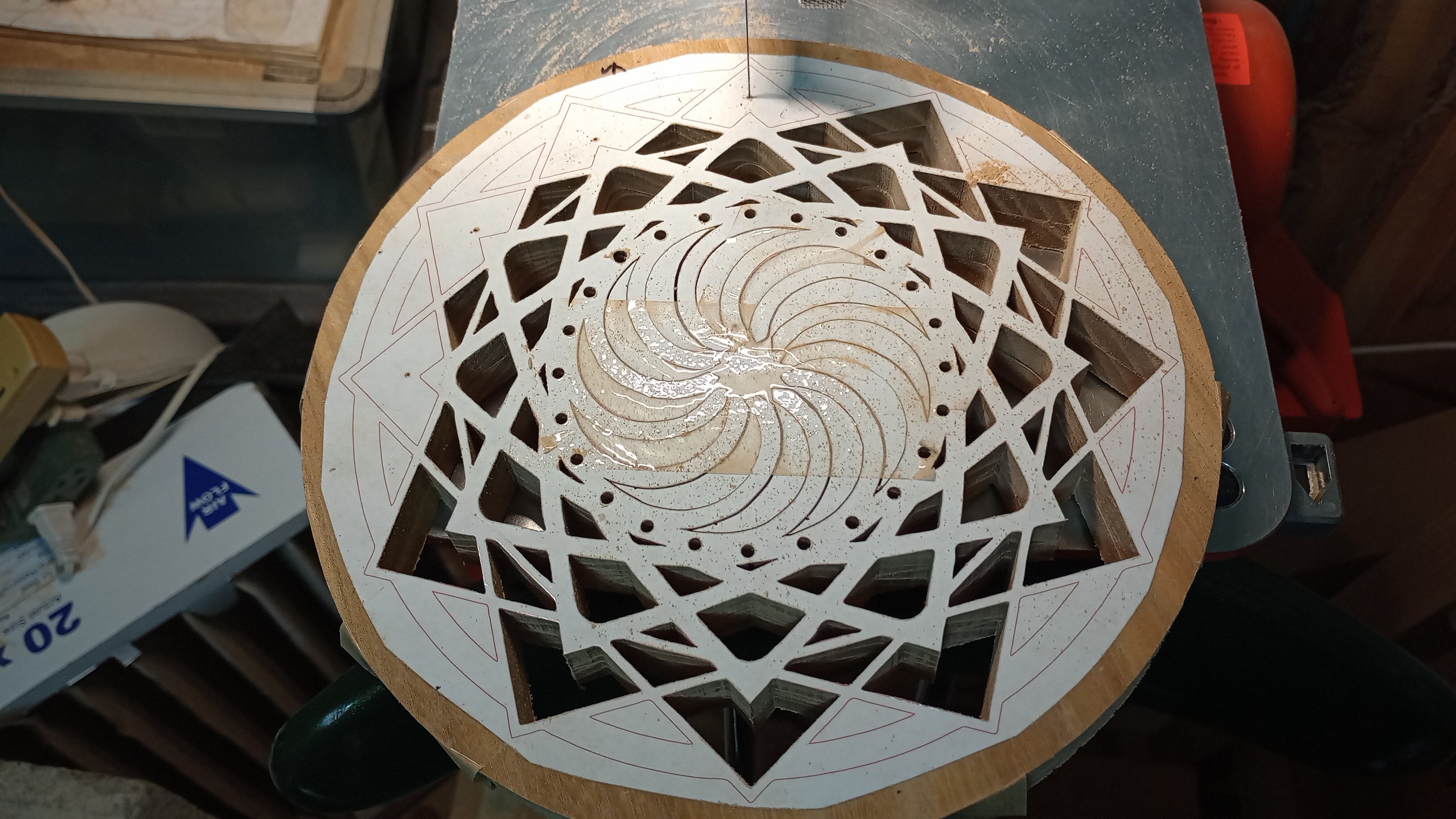

Wichman Posted January 6 Author Posted January 6 The two trivets cut out and first sanding. These are about eight inches in diameter and have a 3/8" warp. I'm hoping that all the frets will allow the trivets to flatten out easily. danny and OCtoolguy 2 Quote

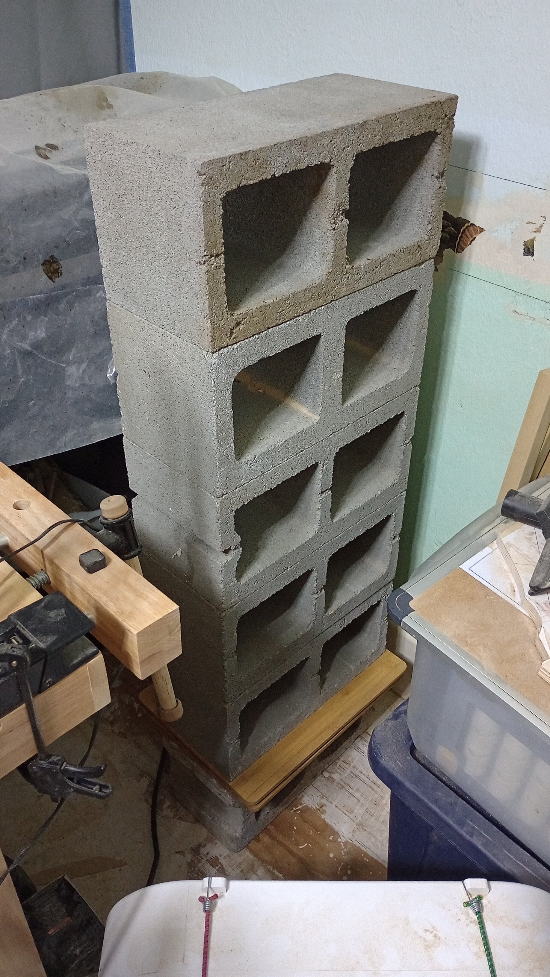

Wichman Posted January 13 Author Posted January 13 Yesterday I started the test. I used my countertop roaster oven and used walnut cooking oil. I had enough oil to just cover the 1/2" wood. I started at 200 degrees and let the temperature stabilize in the cooker. Next I raised the temperature 25 degrees every 15 minutes until I got it to 300 degrees, then let the wood "cook" for two hours. After the two hours were up I moved the trivets to the "press"; one cinder block on the bottom, one bamboo cutting board, then the trivets, another cutting board, and finally five cinder blocks stacked on top. I'll give it five days to stabilize before I check for flatness. JackJones 1 Quote

Wichman Posted January 21 Author Posted January 21 Well the test is complete... and is a complete failure. When I first pulled the trivets out of the "press" they were completely flat, but within minutes they returned to the original warped state. They are still perfectly good trivets and at 7/16" thickness they should protect the surface underneath from hot pans. barb.j.enders, JackJones, Fab4 and 1 other 4 Quote
