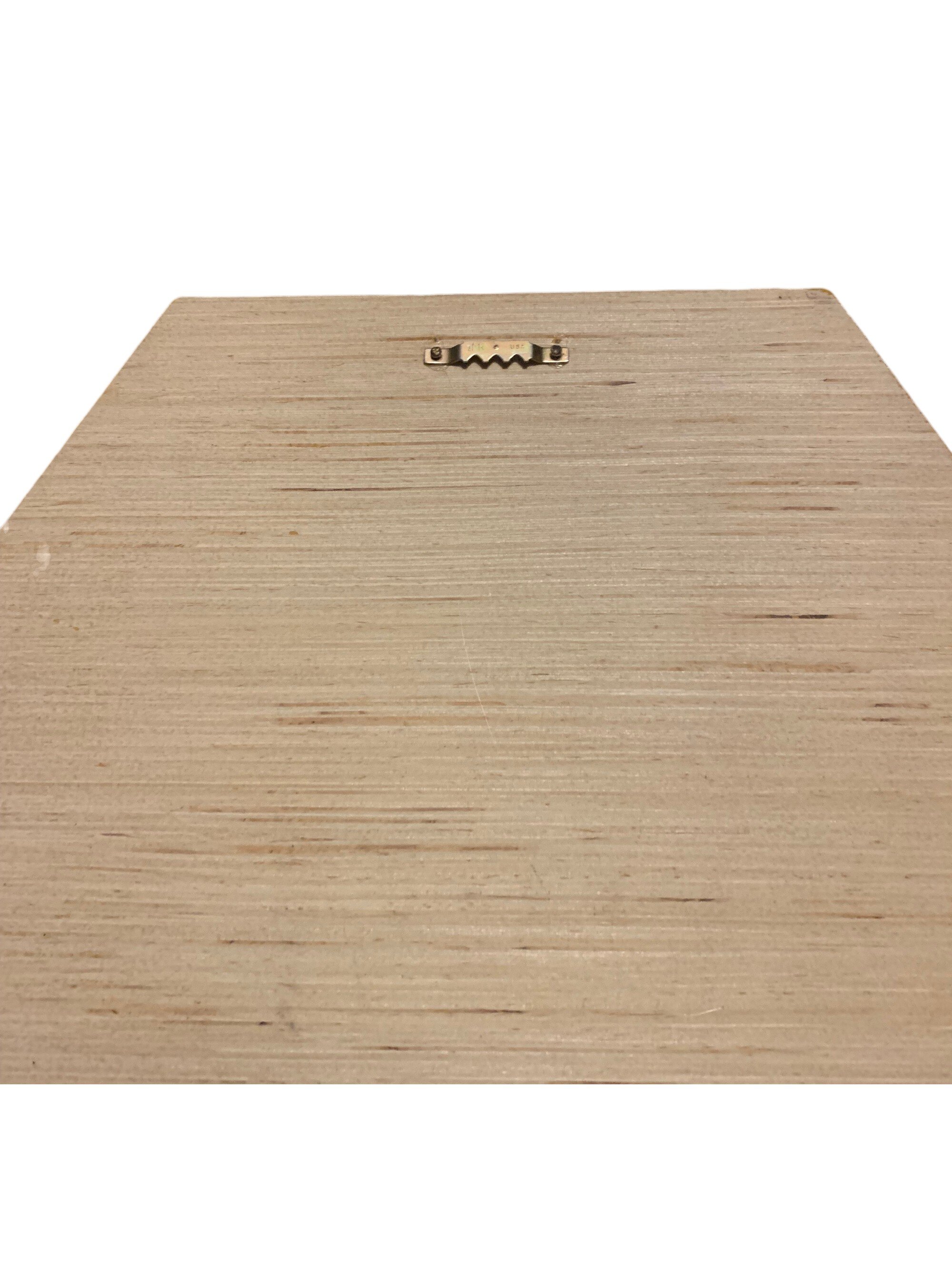

kmmcrafts Posted April 22 Posted April 22 I've always used very small screws to attach sawtooth hangers to small plaques etc.. One issue I've always had was most times the project is made from 1/4" thick plywood and, screws or nails are sometimes just long enough to poke through the front side.. SO, how do you all attach hangers on the back of projects from thin wood? This is the projects I'm currently working on and they are layered ( backer is 1/4" the the front is 1/8" ) but I turned the tiny screws in just a tad too far and it budged out the wood in the front slightly.. sometimes I can get lucky enough to place the screw where there is that additional 1/8" material on the front.. other times I have to be careful to not poke through the project and ruin it. I've thought about using E6000 glue as well as screws so if the glue failed the screws would hold. I hate to run the screws in and leave them loose enough to allow the sawtooth hanger to be able to flop around a little.. I like for them to be snug to the project but then the screws many times will poke though. The little nails that come with the hangers are way to long so I've always bought the shortest smallest screws I could find. This project I had the screw just barely poke as I was checking it as it's not my first time ruining a piece but unfortunately I went to back the screw out just slightly and the screw head broke off.. that is a first especially since I predrilled tiny holes.. LOL.. So I removed the sawtooth and lowered it slightly.. this time using glue to hold it tight and then screws just in case the glue failed. Anyway, looking for suggestions for a better way.. Might have to glue a strip of 1/8" onto the back where the hanger will be attached but rather keep it with a cleaner closer to the wall look. Quote

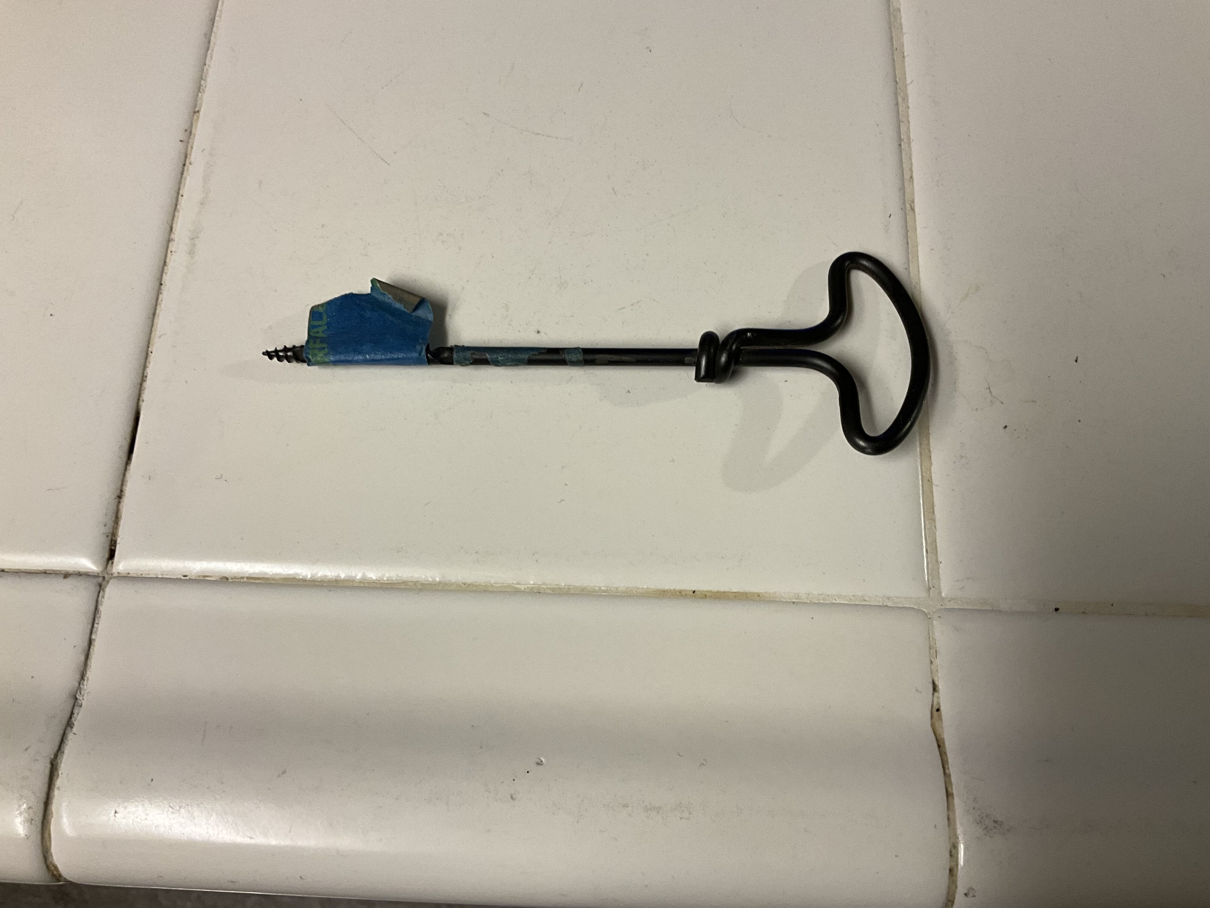

dgman Posted April 22 Posted April 22 What I do when the screw is too long is I grind off the tip of the screw with my grinder. I use a gimbal ( I think that’s what it is called) with tape to mark the thickness of the wood to start the screw hole. I have also used E6000 to mount hangers with out any failures. Roberta Moreton, kmmcrafts, Dan and 1 other 3 1 Quote
Fab4 Posted April 22 Posted April 22 Hi Kevin: Seeing it's the back of the project, I cut and glue a 1/8" rectangle, sometimes thicker, slightly bigger than the sawtooth hanger then glue it screw it in. As you mentioned in your message. You can always just glue the hanger in place, but I don't trust that method too much Fab4 kmmcrafts, Dan and Sycamore67 2 1 Quote
barb.j.enders Posted April 22 Posted April 22 I have used a thick Gorilla glue to glue the hanger to the back. I put a blob of glue on the board, place the hanger and then a blob of glue on the top of the bracket. To the best of my knowledge, none have failed. kmmcrafts and Fab4 1 1 Quote
Scrappile Posted April 22 Posted April 22 (edited) I have used 5 or 15 minute epoxy. None have failed so far. Two are still hanging on my wall, have been there for over 10 year. That reminds me I need to change those pictures, I and tired of seeing them. I have also used Paul's (the other Paul) method with the 1/8" piece of wood. Kevin, your plaques are really nice. Edited April 22 by Scrappile kmmcrafts, Fab4, barb.j.enders and 1 other 3 1 Quote
kmmcrafts Posted April 22 Author Posted April 22 Thanks everyone for sharing your methods.. I thought maybe I might be missing some special unique way to attach these but it seems everyone is doing the same things I've thought about trying with good results. I think I might just stick with the E6000 glue and then place screws in but not crank them down.. just in case the glue were to come loose at least the product won't go crashing to the ground if it has screws too. I'm new to that E6000 glue and have to say that stuff sticks to about anything and one items I tried to take back apart because I messed something up and it wasn't even fully dry yet.. lets just say I had to remake that piece, LOL. Love it for sealed up wood projects like painted backers etc. where the wood glue just doesn't bond well. Only downfall is the spiderweb stringy things it can create. Kinda reminds me of clear silicone caulking as it's a bit rubbery flexible etc. Fab4 and barb.j.enders 2 Quote

Denny Knappen Posted April 22 Posted April 22 I use 3/8" Baltic Birch plywood as backers and this eliminates this problem. We have had framing projects with thin backers and used d-hangers attached with E6000 glue. barb.j.enders, Roberta Moreton, Fab4 and 1 other 3 1 Quote
TAIrving Posted April 22 Posted April 22 I cut a hanger from wood and attach it with titebond 3 glue. Don't need the screws. Titebond glue holds wood well enough for most 1/4" scroll saw work. Dan, kmmcrafts, Fab4 and 1 other 3 1 Quote

garryatpa Posted April 22 Posted April 22 When I have had wall hangings made of 1/8 or 1/4 inch wood and screws or small nails were not suitable I always used hot melt glue. Put a dab on the wood where each end of the saw tooth hanger will go and press into the dabs of glue. To increase the holding ability smooth another dab of glue over each end of the hanger so it extends over the glue pushed out the sides. garry Wichman, kmmcrafts, barb.j.enders and 1 other 3 1 Quote
Jim McDonald Posted April 23 Posted April 23 I have drilled slightly undersized holes and then cut the nails shorter on an angle to make a new point. Dan and kmmcrafts 1 1 Quote
Bill WIlson Posted April 23 Posted April 23 If you are using pan head screws, you could add a washer or 2, either underneath the screw head or under the hanger. Old Joe and Wichman 2 Quote
