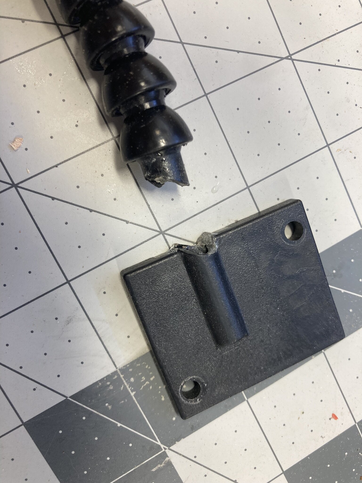

pngeezer Posted August 9 Posted August 9 In general I'm happy with my Bauer 22". Only issue I've had is the blower hose broke off at the base and HF doesn't sell a replacement. I was able to cobble together a new base plate and a piece of clear tubing, but the original is definitely a point of failure on this machine. Had I bought the extended warranty they would have just replaced the entire machine! Jim barb.j.enders and OCtoolguy 2 Quote

barb.j.enders Posted August 12 Posted August 12 On 8/9/2026 at 9:30 AM, pngeezer said: In general I'm happy with my Bauer 22". Only issue I've had is the blower hose broke off at the base and HF doesn't sell a replacement. I was able to cobble together a new base plate and a piece of clear tubing, but the original is definitely a point of failure on this machine. Had I bought the extended warranty they would have just replaced the entire machine! Jim I wonder if someone with a 3d printer could print this for you? 13 hours ago, Aggie said: So far I happy with the Bauer 22 the only thing I can say negative about it is the thumb screw for the blades bends the tip of the blades. I ordered the Pegasus thumb screws from bearwood and now just waiting for them to come in the mail. I got the extended warranty and they said I could get a new saw or my money back for the next 2 years, no questions ask even if I didn't like the saw anymore. BTW, the thumb screws are probably not set right which would cause the bending the tips of the blades. Aggie and OCtoolguy 1 1 Quote
don in brooklin on Posted August 12 Posted August 12 For the blower you might want to check with Seyco for the exact measurement of the blower attachment they sell. Looks the same but metal. https://seyco.com/product/adb-10/ OCtoolguy and Aggie 2 Quote
pngeezer Posted August 12 Posted August 12 Thanks Don, I will look into that Seyco part to see if the base is the same size as the Bauer. Jim OCtoolguy and Aggie 2 Quote
