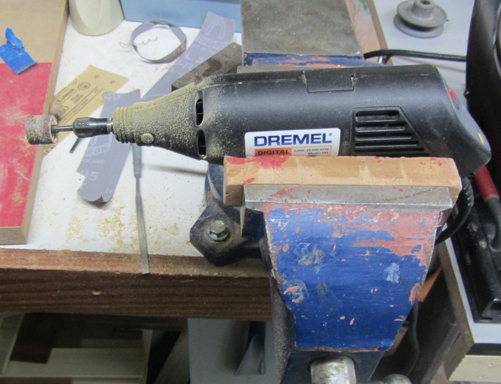

Scrappile Posted April 11, 2023 Author Report Posted April 11, 2023 This is my current "shaper" tool, I do have a foot peddle on it. Gene Howe and Dave Monk 1 1 Quote
