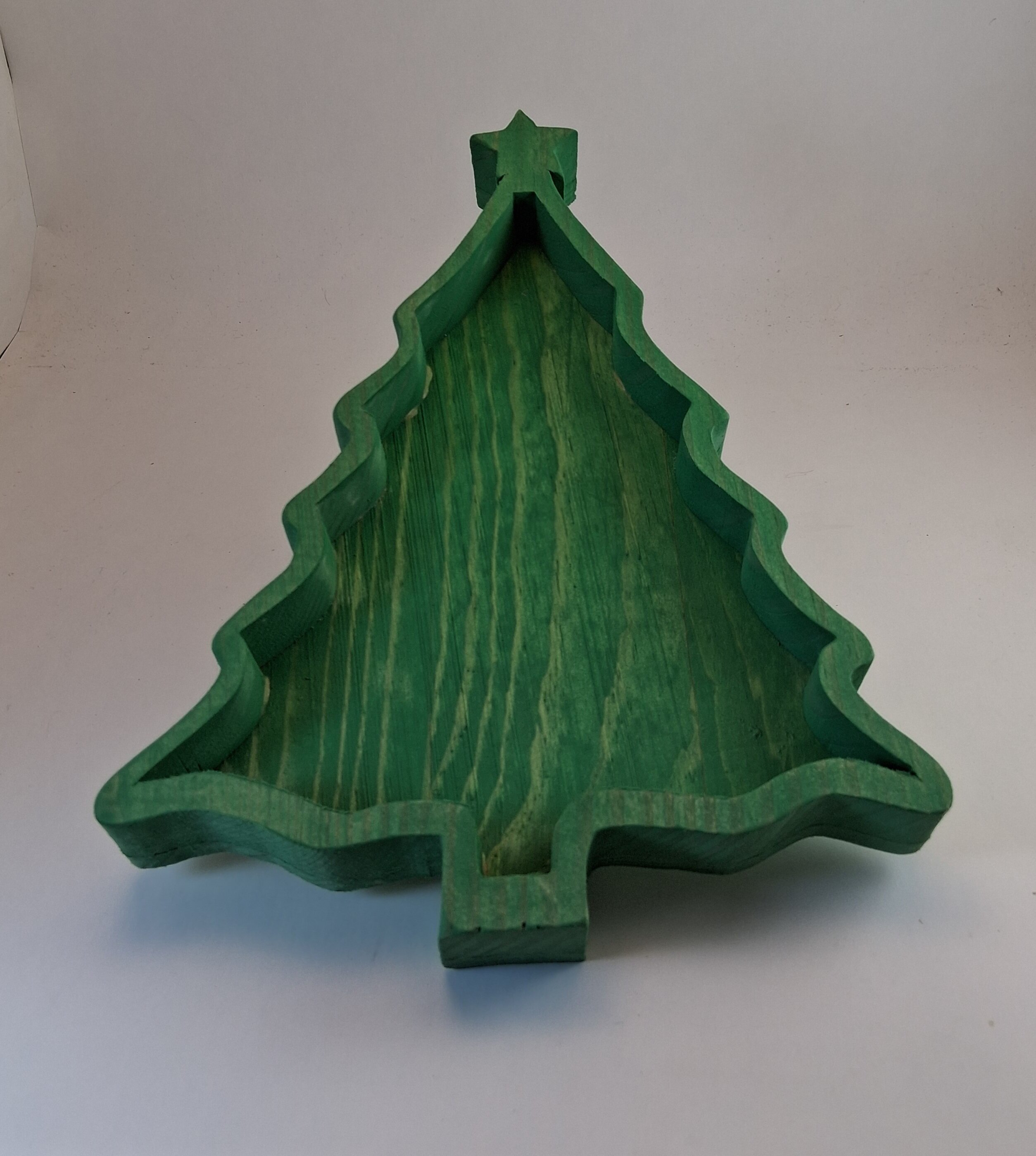

Popular Post don in brooklin on Posted September 18 Popular Post Posted September 18 Taking the advice of Barb and Denny regarding my Pumpkin Tray. I designed a Christmas tree candy tray with the idea of using in one of my scroll saw courses. Worried about how long it will take to cut. I took me 21 minutes including 2 minutes for the glue up. Denny - I used a combination of Weldbond and CA, sprayed the bottom with accelerator held for about a minute and works perfectly. Learned you have to make sure no squeeze out from CA as it will not wipe off like the other glue. I might use in another idea I have for a club night of scrolling. MTCowpoke22, JackJones, FrankEV and 10 others 13 Quote
Hudson River Rick Posted September 19 Posted September 19 @don in brooklin on Hi Don, great job on the candy tray. I was just wondering how wide it is at the largest part, it looks like you may have used pine for the project. Is it finished with paint or stain? Thanks for sharing. Rick Quote
don in brooklin on Posted September 20 Author Posted September 20 (edited) It is made with scrap pine. I get shelving at home depot 10 inches wide and you have work around the knots. This dish is 7 inches wide by 9 1/2 high. I used Saman green stain. Edited September 20 by don in brooklin on Jim McDonald, Hudson River Rick and barb.j.enders 2 1 Quote
