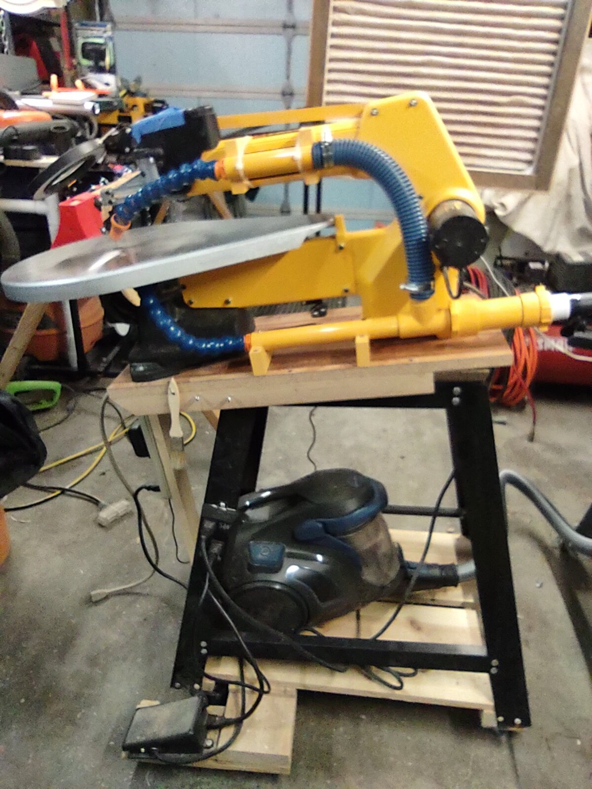

malar Posted June 20 Posted June 20 On 5/28/2026 at 4:48 PM, Sycamore67 said: I looked at the Scrollnado and just did not work for me. Several folks here have made very good dust collection systems using PVC and LocLine pieces. They have worked well. The hose from my vacuum just plugs into the PVC. I've wanted to do something like this. So i started and this is what I have so far. need some mounting brackets. Going on a DW788. Quote
Mike Crosa Posted June 20 Author Posted June 20 That looks pretty good. I look forward to seeing the final installation. Will it be moveable with the stand or will it be fixed? Quote
malar Posted June 21 Posted June 21 (edited) I found a super quiet vacuum on Amazon that fits under the stand. The stand is on casters. My shop has a yard full of tools and it's in a small single car garage. I need to move things around just to use my tools. I'll post a photo when I get it put together. I look like crap in the photo, I've had a headache for a few days. Edited June 21 by malar Quote
malar Posted August 9 Posted August 9 (edited) Well I finally got it together and tried it out, it works great and it's quiet. Sorry about the phuzzygraph. Edited August 9 by malar Quote
